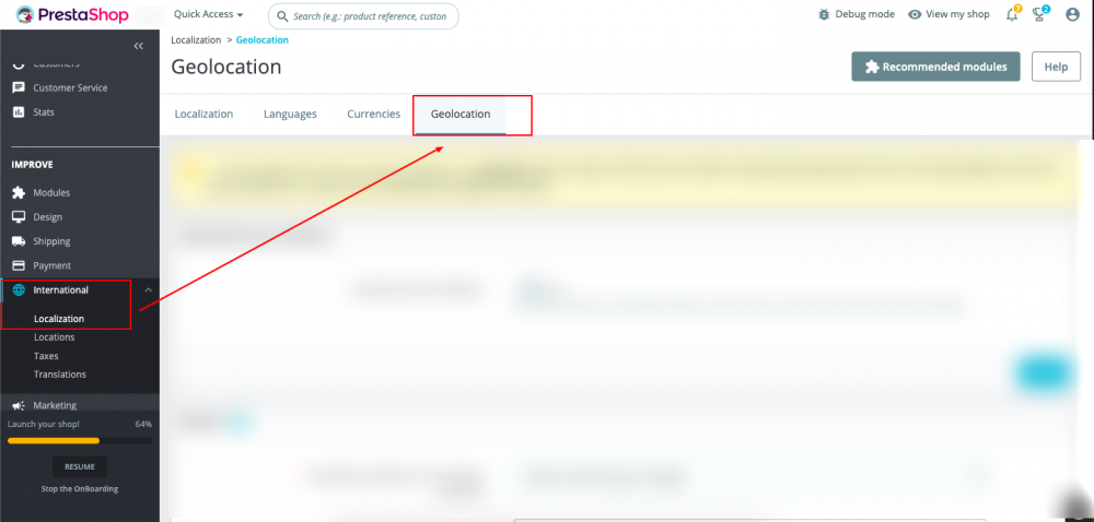

- In Prestashop BO, Go to the International -> Localization.
- In the Geolocation section, click on Add/Update a Database button.
- Select the MaxMind Geolocation option.
- Select the file /app/Resources/geoip/GeoLite2-Country.mmdb and upload it to import the GeoLite2-Country database.
- After the import is complete, you should see a success message.
- Save the changes and clear the Prestashop Cache.
The Geolocation feature should now be installed and ready to use in your PrestaShop 8.1.0 store.

I have 8.2 version, and did import the requested files as described
But unfortunately then, the Add/update a Database button is not in the Geolocation section.
Any where I could find it ?
