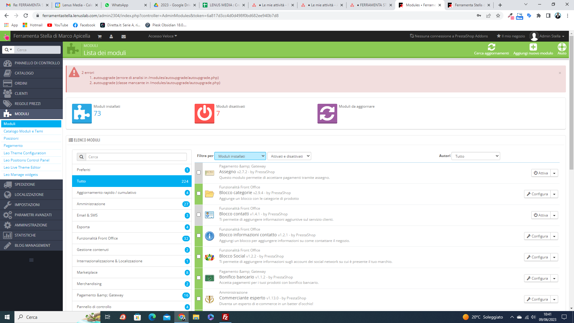

Support Lenus Media Posted June 12, 2023 Share Posted June 12, 2023 Good morning, we tried to activate the 1-click-upgrade module to be able to upgrade to version 1.6.1.24 of Prestashop but it returns the errors visible in the attached file. The latest version of that module was downloaded from GitHub. Could you tell us how to solve the problem? Thank you Link to comment Share on other sites More sharing options...
ComGrafPL Posted June 12, 2023 Share Posted June 12, 2023 Try older version of one click. As latest are mainly for 1.7 / 8 and can get you such issues. Link to comment Share on other sites More sharing options...

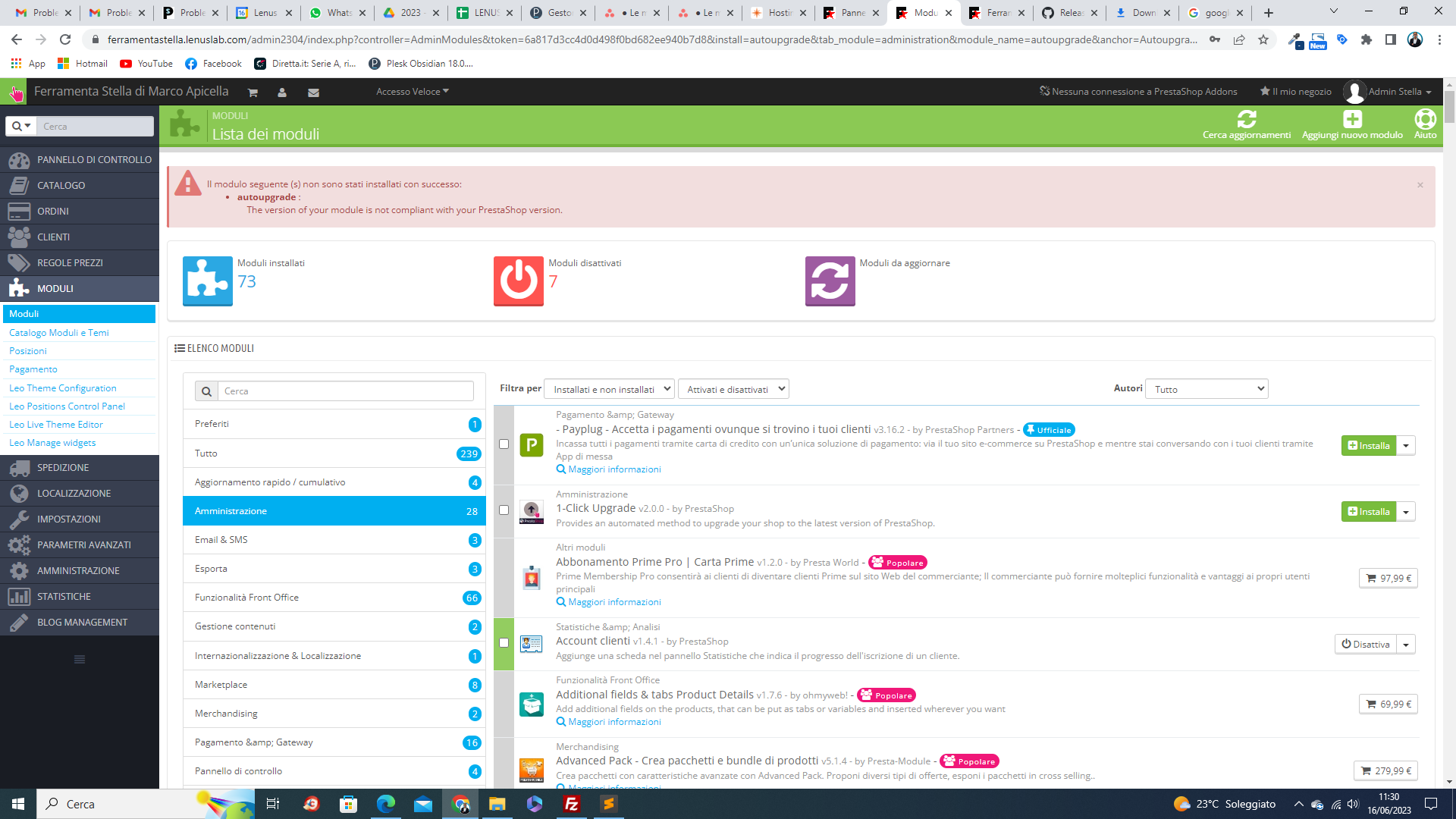

Support Lenus Media Posted June 28, 2023 Author Share Posted June 28, 2023 Good morning, we tried to activate old versions of the 1-Click Upgrade module including the most obsolete, 2.0.0, but it returns the error visible in the attached file. Could you tell us which version of this module is compatible with the Prestashop version active on the site in question which is 1.6.0.8? Thank you Link to comment Share on other sites More sharing options...
