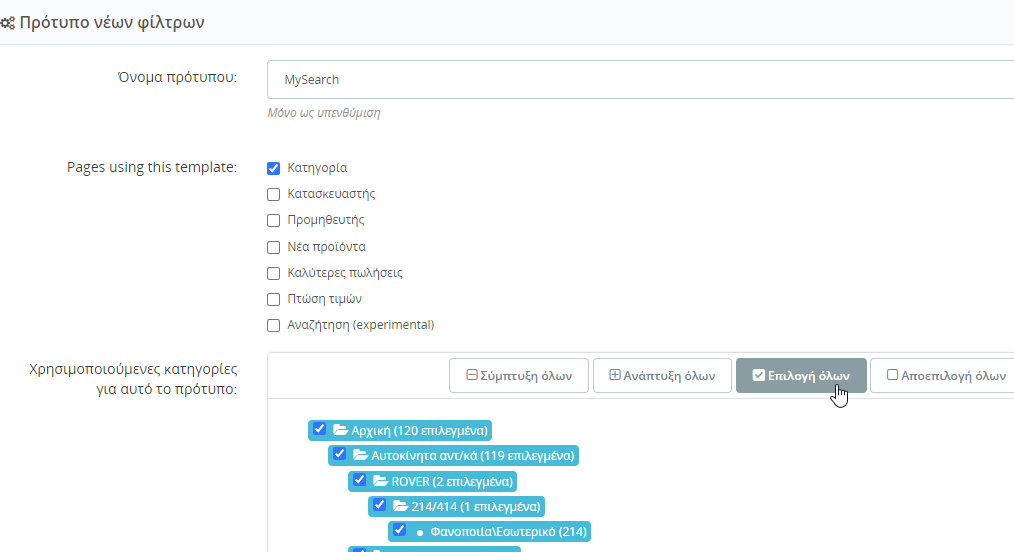

geochrist Posted June 7, 2023 Author Share Posted June 7, 2023 Yes the hooks are DisplayLeftColumn and DisplaySearch. Should I hook it somewhere else? Yes I have created a new filter , assigned the product page at the top and selected all categories of products. I have also rebuilt all indexes. Link to comment Share on other sites More sharing options...
geochrist Posted June 7, 2023 Author Share Posted June 7, 2023 This is the top of the setup page. Link to comment Share on other sites More sharing options...

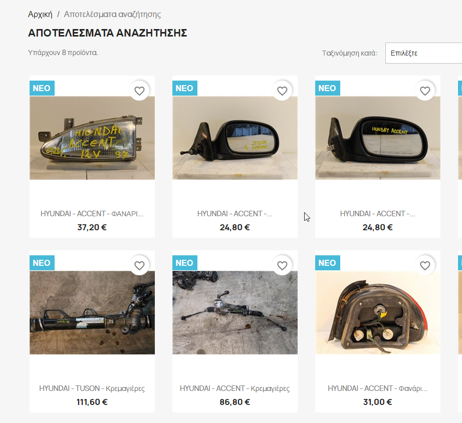

geochrist Posted June 7, 2023 Author Share Posted June 7, 2023 And this is how the search result are displayed without the faceted search on the left. Link to comment Share on other sites More sharing options...

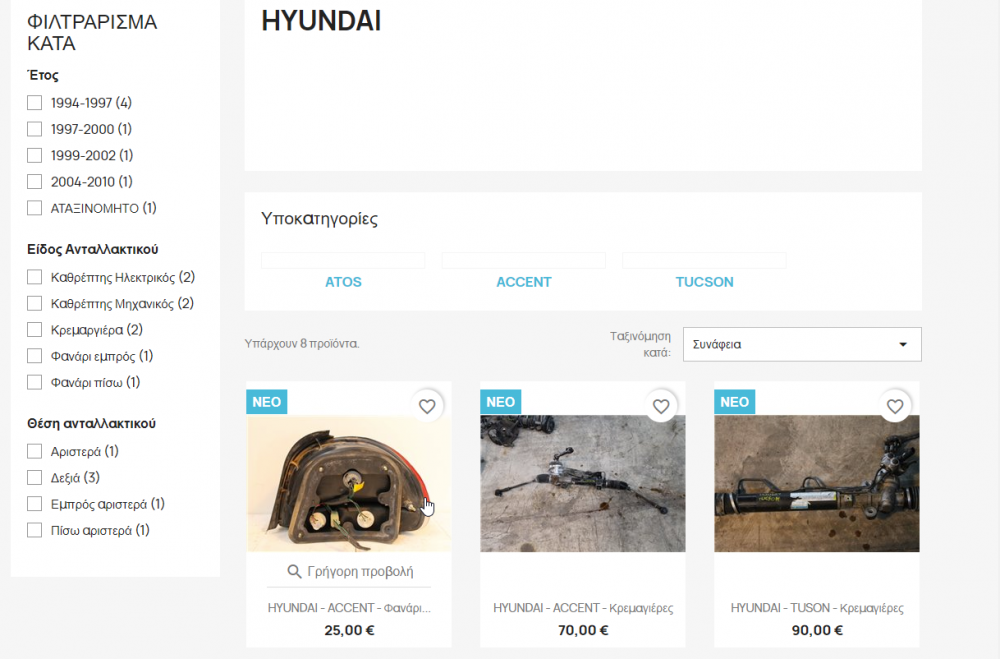

geochrist Posted June 7, 2023 Author Share Posted June 7, 2023 When I select a manufactor from the stock prestashop menu such as Hyundai I get the correct reply with the faceted search working. Link to comment Share on other sites More sharing options...

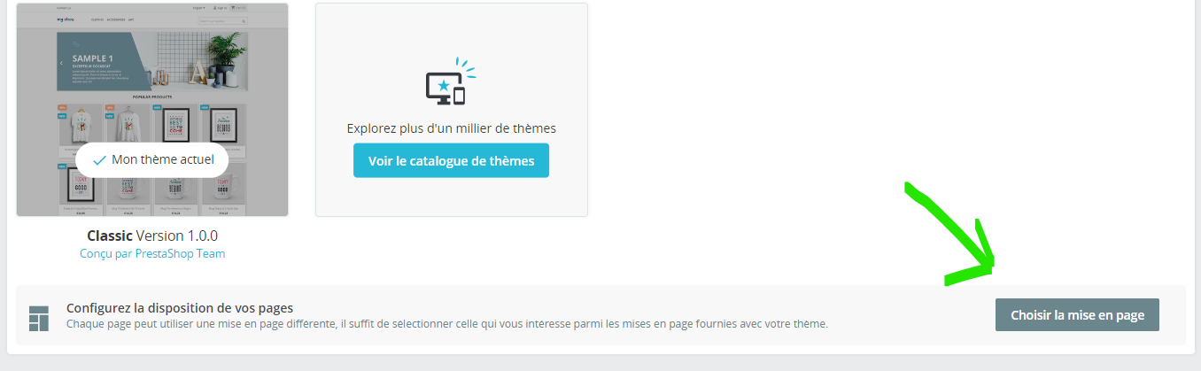

geochrist Posted June 9, 2023 Author Share Posted June 9, 2023 The problem was the setup of the search page as a two colum page. You can do it in the backoffice seetings for the classic theme. 1 Link to comment Share on other sites More sharing options...
