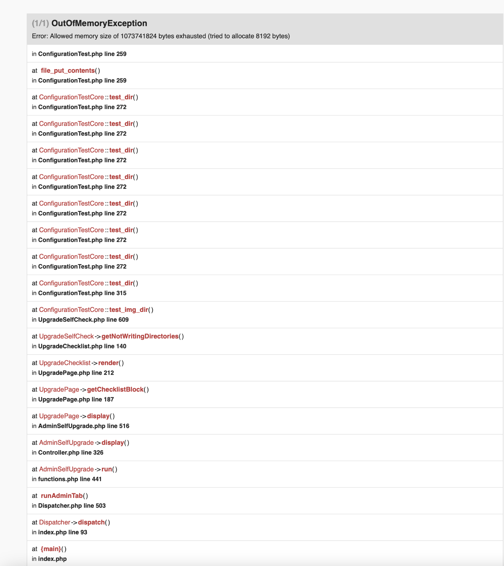

newgeneration Posted May 6, 2023 Share Posted May 6, 2023 Good morning everyone, I have a problem in upgrading prestashop version 1.7.8.8 to 1.8.0.4. The error is the following: OutOfMemoryException in ConfigurationTest.php line 259. Waiting for your feedback.. Thank you very much Link to comment Share on other sites More sharing options...

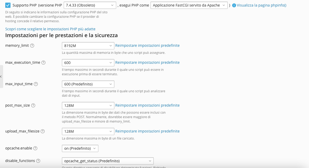

ComGrafPL Posted May 6, 2023 Share Posted May 6, 2023 What's your PHP version and memory_limit settings? Also, any serious reason to upgrade to 1.8+? 1 Link to comment Share on other sites More sharing options...
newgeneration Posted May 6, 2023 Author Share Posted May 6, 2023 I use php 7.4 with 4096mb memory limit… ionos cloud server.. I would like to upgrade to version 8 to switch to php 8.. I should optimize everything… Link to comment Share on other sites More sharing options...

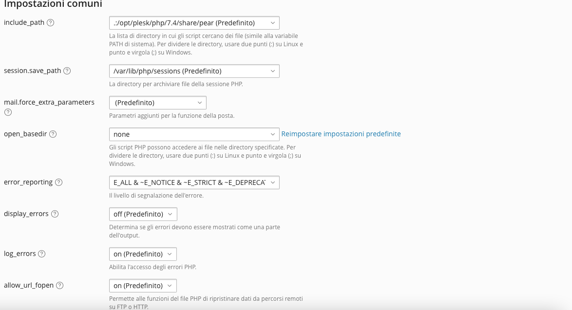

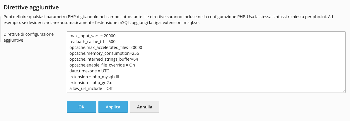

Nickz Posted May 7, 2023 Share Posted May 7, 2023 5 hours ago, newgeneration said: ionos cloud server Details for the server plus php.ini settings, please Link to comment Share on other sites More sharing options...
newgeneration Posted May 7, 2023 Author Share Posted May 7, 2023 6 hours ago, Nickz said: Details for the server plus php.ini settings, please Hi, here is my setup...thanks Link to comment Share on other sites More sharing options...
