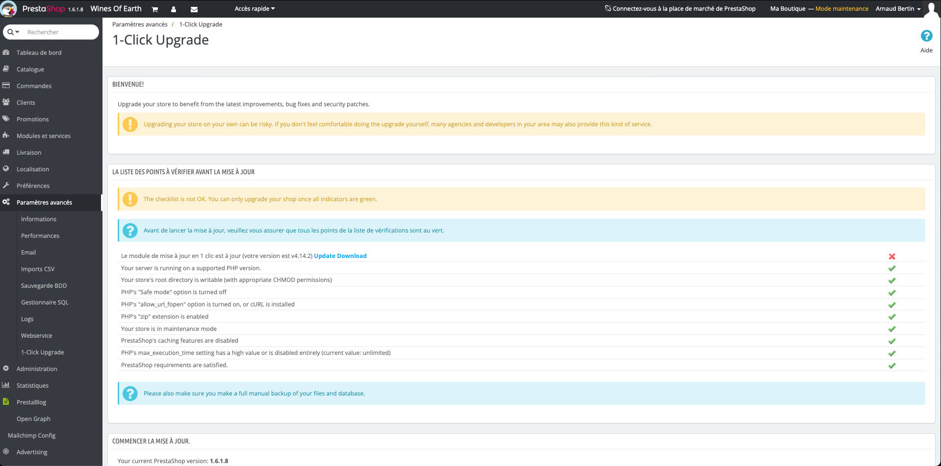

KATANA-CONSULTING Posted May 2, 2023 Share Posted May 2, 2023 Hi, I don't know if it's the good place to post that but I try to get some help. I need to update my client's/custommer (I'm a web agency) website with is on PS 1.6.1.8 to PS 1.6.1.24 for now. I can't do it, because 1 click upgrade, with is up to date, continue to tell me that the module is not up to date ... then ... it is ! It tried to change upgrade mode to 'local archive' ou 'local folder', minor or major release, it does not change anything. Cold you please help with a process ? Regards. Link to comment Share on other sites More sharing options...

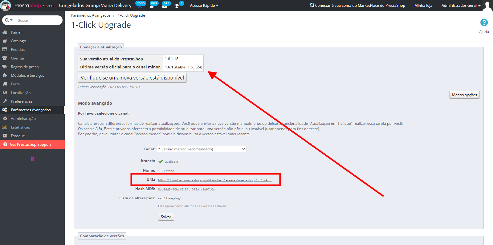

Internet360 Posted May 9, 2023 Share Posted May 9, 2023 On 5/2/2023 at 9:55 AM, Eolia said: Delete (uninstall & delete) and try this autoupgrade.zip 468.17 kB · 3 downloads Hi, thank you very much for sharing this module. When I try to use it to update to version 1.6.24, the download URL is broken - https://download.prestashop.com/download/releases/prestashop_1.6.1.24.zip Is there any other URL+Hash that we can use? Tks Link to comment Share on other sites More sharing options...
Eolia Posted May 10, 2023 Share Posted May 10, 2023 https://www.prestashop.com/download/old/prestashop_1.6.1.24.zip Link to comment Share on other sites More sharing options...
