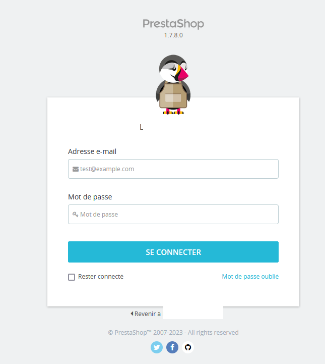

isdngirl Posted March 31, 2023 Share Posted March 31, 2023 Hello, I am having an issue where when trying to log on to backend it goes into a loop and nothing happens it goes to the screen like the attached. I enabled debug and no errors. I have deleted cache in the var folders and killed browser cache but nothing. I do no have any additional caching enabled. I have even tried to restore a few days back and still the same issue so it appears that something maybe had a problem awhile ago but since I left myself logged in I didnt see it and now I cant restore to where it was working. I havent installed anything for months, so Im not sure what could have caused the problem but here it is. The theme I am using is a child theme of warehouse but even if i reset the theme to warehouse in the db it doesnt fix the issue. The front end side is fine for clients and they are still making orders but I cant get in via backend. I can however see and access database with phpadmin. Being its becoming a very big headache, is there something else I can try? Or is there a module that will allow me to move my client and product data over without having access to the production database? The onyl ones I find work by installing on BO of the data producing side which wont work if I cant get in. The production is 1.7.8 but now my host only offers 1.7.8.8 so it would need to migrate to the new one at the same time without BO access on production. thank you for any ideas in advance Link to comment Share on other sites More sharing options...

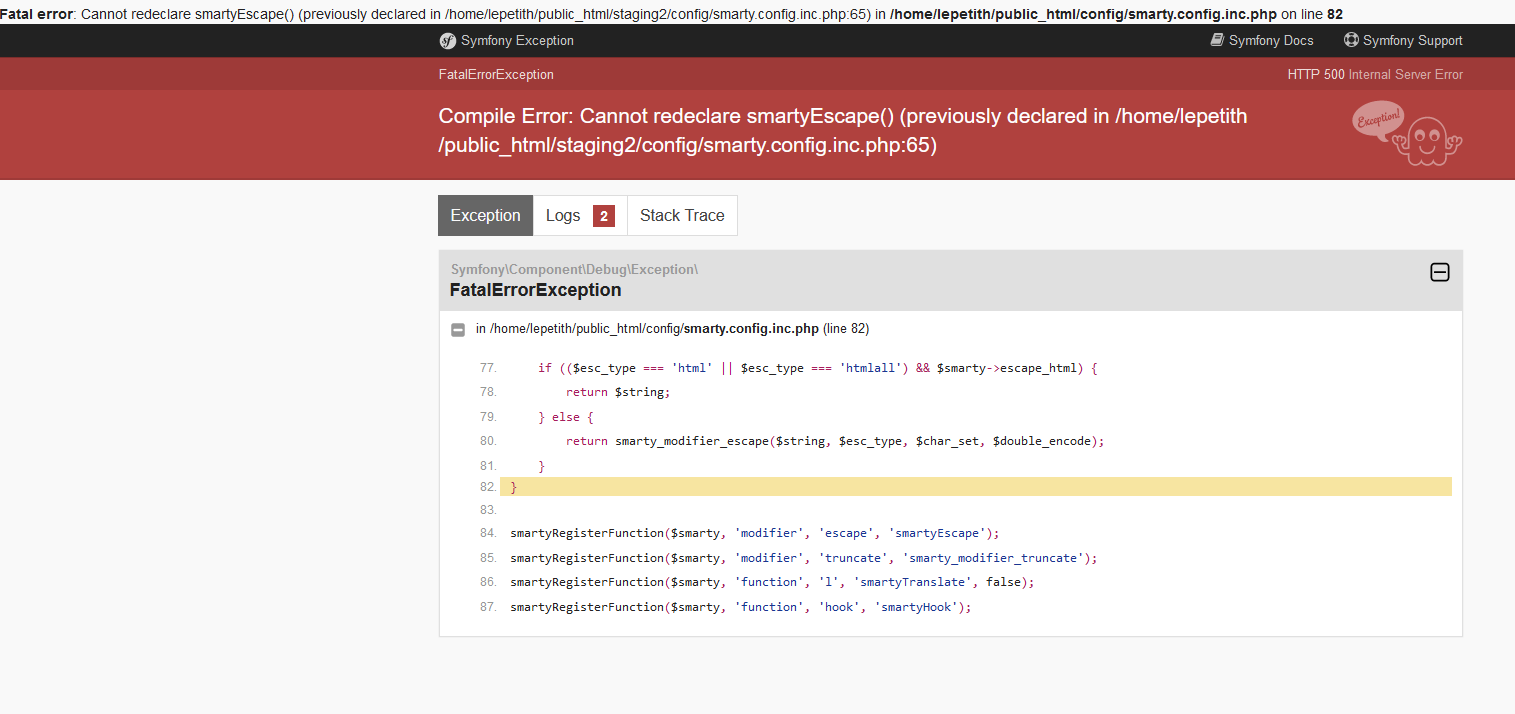

isdngirl Posted April 1, 2023 Author Share Posted April 1, 2023 Hello thank you for your reply, I have checked those and removed all blocking in the http access but no luck. Reset all cache again on server and local disk and now I have clones the database which finally gives a smarty error Fatal error: Cannot redeclare smartyEscape() (previously declared in /home/lepetith/public_html/staging2/config/smarty.config.inc.php:65) in /home/lepetith/public_html/config/smarty.config.inc.php on line 82 but no idea how to reset or how it arrived like that. At this point I would be happy to find a tool or way to just move the client data and products into a clean db but it seems all of the migration addons listed are needing access to the BO of the source file which I cant get to Link to comment Share on other sites More sharing options...
