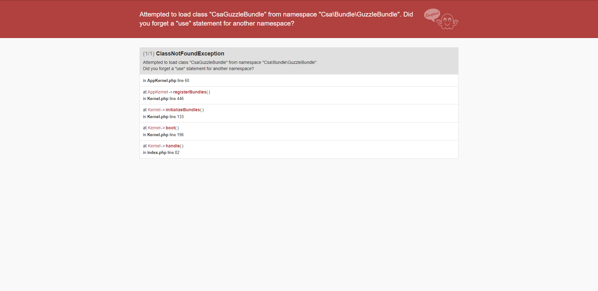

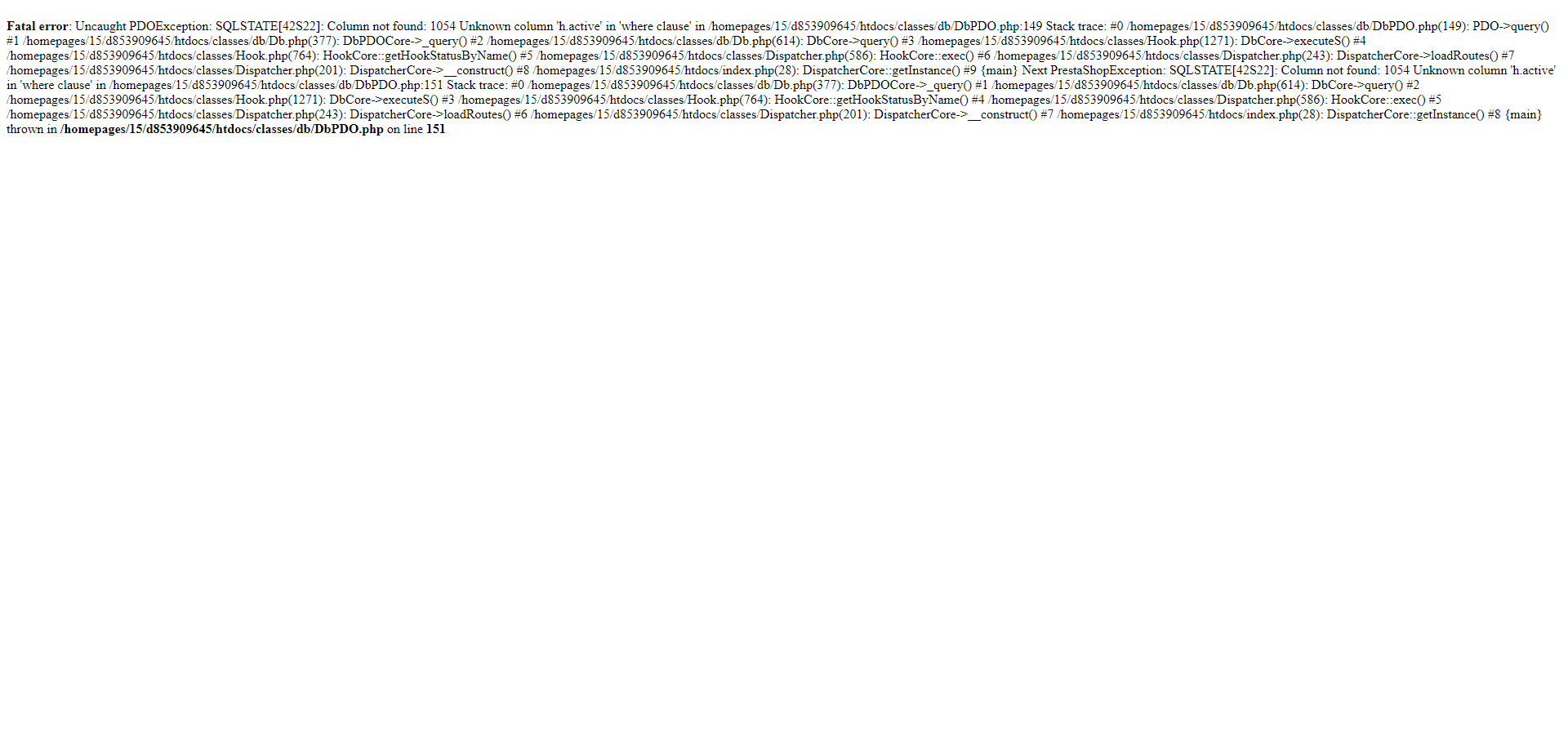

sacha bouhey Posted March 27, 2023 Share Posted March 27, 2023 Hey so I'm new to this and I needed to upgrade my prestashop to the newest version but now I get this error when entering admin panel (also the entier website does not work, [see: Second image]) I checked everything, tried many things but nothing seems to work... Anyone have an idea of what to do ? Link to comment Share on other sites More sharing options...
JBW Posted March 28, 2023 Share Posted March 28, 2023 Seems the update was broken and now you are missing core files and database updates - I recommend to roll-back to prevoius version and do a controlled upgrade again taking note/care about the upgrade issues. Link to comment Share on other sites More sharing options...
sacha bouhey Posted March 28, 2023 Author Share Posted March 28, 2023 20 minutes ago, JBW said: Seems the update was broken and now you are missing core files and database updates - I recommend to roll-back to prevoius version and do a controlled upgrade again taking note/care about the upgrade issues. First thanks for your fast reply, I had some problems with the update using the 1 click upgrade (it said something like he doesn't have the permission to close the zip file) So I tried to do a manual update. Doesn't seems to have much documentation for that online tho... Have you any idea of how I could do the upgrade ? Link to comment Share on other sites More sharing options...
JBW Posted March 28, 2023 Share Posted March 28, 2023 I'm usually using the 1-click module. If there are error like you mentioned fix this first before doing next steps/try becuase mostz probably you would face same when doing it manually but maybe won't see the error immediately Link to comment Share on other sites More sharing options...
