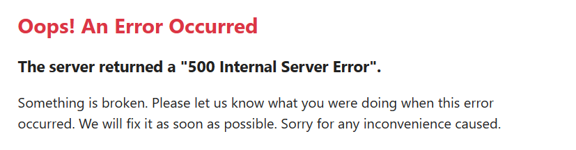

Lidovi Posted March 10, 2023 Share Posted March 10, 2023 (edited) Hello, I had issues setting up my new store with Hostinger, PrestaShop 8.0.1 and Printful module. Module was successfully installed, but when I click "Configuration" or "Dashboard" or "Orders", I get "500 Internal Server Error" like this. Is there any way to solve this? Any help would be much appreciated. Thank you & have a nice day. Edited April 20, 2023 by Lidovi Enquiry is solved. Thank you very much! (see edit history) Link to comment Share on other sites More sharing options...
