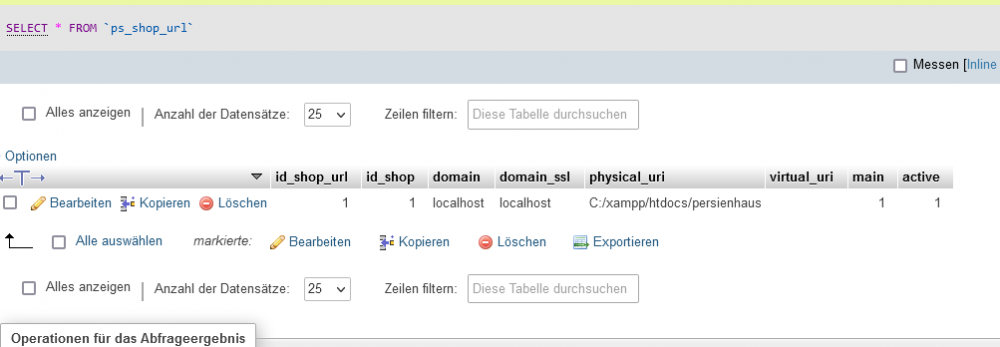

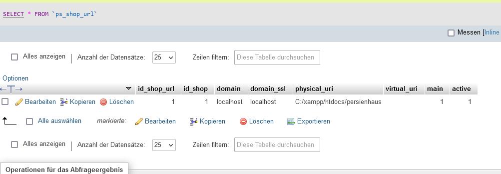

peter_lang Posted March 1, 2023 Author Share Posted March 1, 2023 DB screen anbei .. sek .. muss ggf unter physical_url der pfad zum shop vlt rein? Link to comment Share on other sites More sharing options...
juanrojas Posted March 1, 2023 Share Posted March 1, 2023 genau physical_uri Link to comment Share on other sites More sharing options...
peter_lang Posted March 1, 2023 Author Share Posted March 1, 2023 hmm, will auch net, habe versucht localhost/myfolder myfolder C:\xampp\htdocs\myfolder C:/xampp/htdocs/myfolder Nichts greift und er leiter weiter auf URL Link to comment Share on other sites More sharing options...

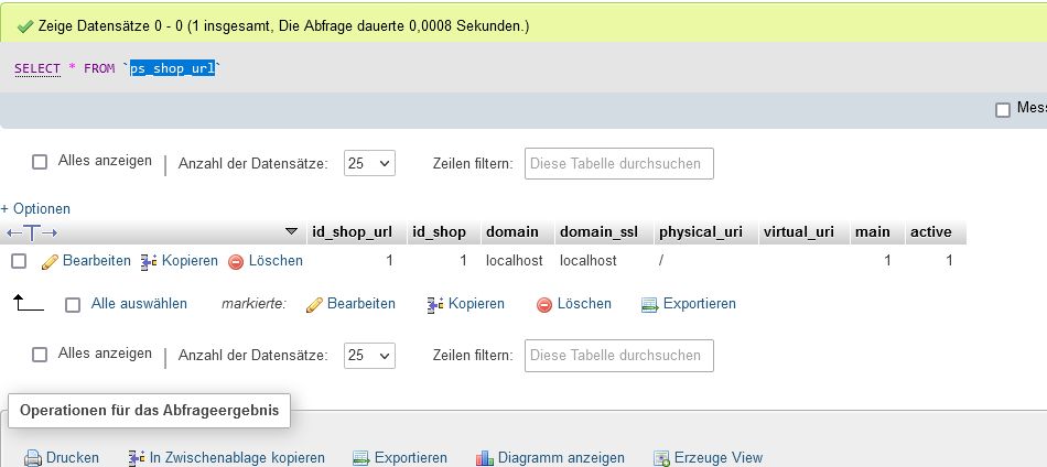

peter_lang Posted March 1, 2023 Author Share Posted March 1, 2023 Link to comment Share on other sites More sharing options...
juanrojas Posted March 1, 2023 Share Posted March 1, 2023 physical_uri /persienhaus/ 😉 1 Link to comment Share on other sites More sharing options...
peter_lang Posted March 1, 2023 Author Share Posted March 1, 2023 Holy Moly, das war ne Geburt .. aber TOP, funzt ... vielen lieben Dank Link to comment Share on other sites More sharing options...
