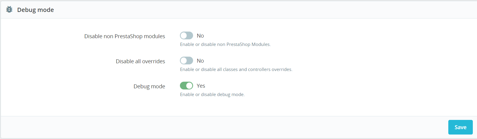

endriu107 Posted February 14, 2023 Share Posted February 14, 2023 Turn on debug mode and then check maybe some other error messages will show up and tell more where is issue. Link to comment Share on other sites More sharing options...
Sairon Posted February 14, 2023 Author Share Posted February 14, 2023 I turned it on, but I am not sure where I can see all the fault codes. Could you maybe guide me? Link to comment Share on other sites More sharing options...

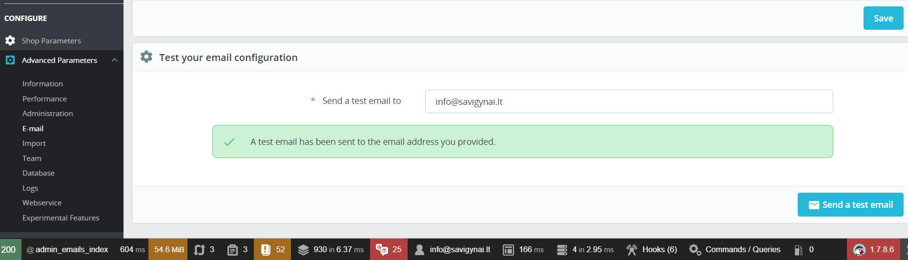

s4lvozesta Posted February 14, 2023 Share Posted February 14, 2023 In Back Office, there is a button to do testing on sending email. Try that and see if it works. Anyway, this topic might be interesting for youhttps://www.prestashop.com/forums/topic/1066402-solved-video-how-to-set-up-gmail-smtp-in-prestashop/ Link to comment Share on other sites More sharing options...
idnovate.com Posted February 15, 2023 Share Posted February 15, 2023 18 hours ago, Sairon said: I turned it on, but I am not sure where I can see all the fault codes. Could you maybe guide me? Make a test sending a contact form message. Link to comment Share on other sites More sharing options...
Sairon Posted February 17, 2023 Author Share Posted February 17, 2023 The test email works fine. It is very strange. If I use the email provided for the test email in the contact form module, it works fine. If I use another email, it does not work. Link to comment Share on other sites More sharing options...
idnovate.com Posted February 17, 2023 Share Posted February 17, 2023 1 hour ago, Sairon said: The test email works fine. It is very strange. If I use the email provided for the test email in the contact form module, it works fine. If I use another email, it does not work. But do you get any error with DEBUG mode enabled? Link to comment Share on other sites More sharing options...
Sairon Posted February 17, 2023 Author Share Posted February 17, 2023 Where can I see my errors? Somewhere here? Link to comment Share on other sites More sharing options...
idnovate.com Posted February 17, 2023 Share Posted February 17, 2023 First turn on DEBUG mode: Then retry the action where you get the problem and check if you get an error. It will be displayed in the screen. Link to comment Share on other sites More sharing options...
Sairon Posted February 17, 2023 Author Share Posted February 17, 2023 It was, and still is ON. Link to comment Share on other sites More sharing options...
idnovate.com Posted February 17, 2023 Share Posted February 17, 2023 13 minutes ago, Sairon said: It was, and still is ON. But have you tried to send the contact form from the frontoffice? Link to comment Share on other sites More sharing options...
Prestachamps Posted February 17, 2023 Share Posted February 17, 2023 Hi @Sairon, Have you checked Prestahop's error/extception log for the error message? as there is most likely an error or exception in this file: /var/logs/dev.log or /var/logs/prod.log You can also try to reset the contact form module, or see if the contact form module was updated and has an override *.tpl file inside the theme folder, and rename or delete that file temporarily to see if the contact form module still has the error after this modification. I hope that I could help. Have a nice day, Leo. Link to comment Share on other sites More sharing options...
