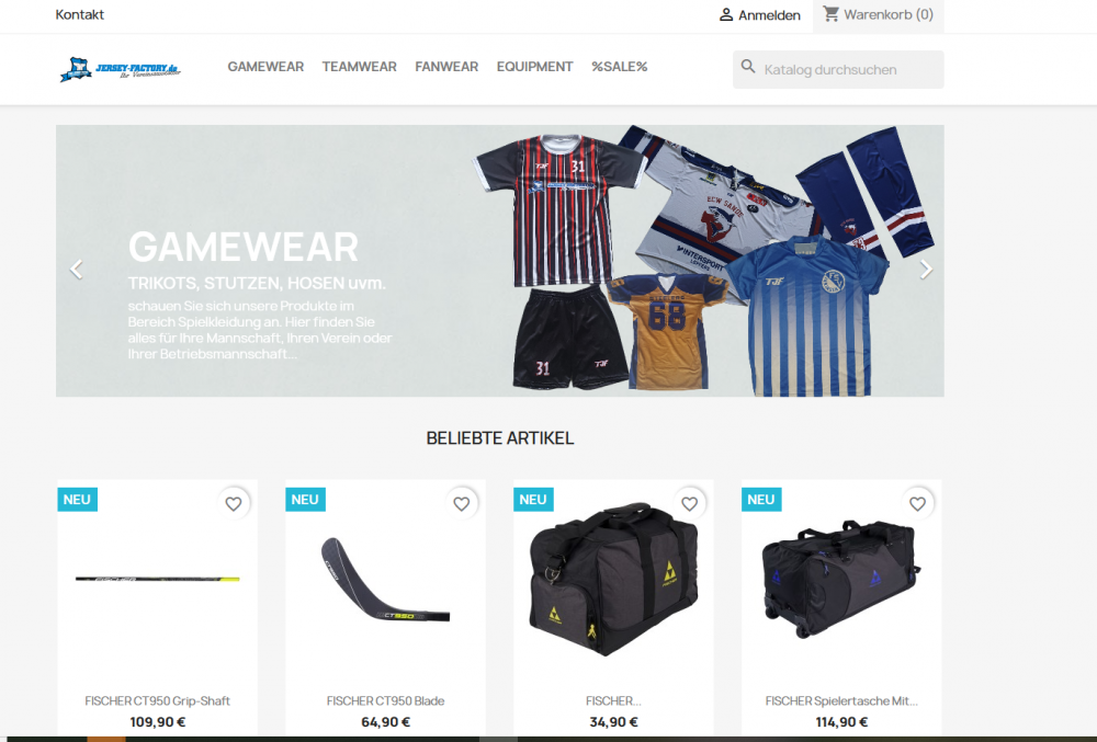

idnovate.com Posted February 10, 2023 Share Posted February 10, 2023 Welches Theme verwenden Sie? Wie sieht Ihre Website aus? Link to comment Share on other sites More sharing options...
TheJerseyFactory Posted February 10, 2023 Author Share Posted February 10, 2023 Ich verwende Classic Version 1.0.0 und arbeite gerade den Shop an zBlueStore Version 1.0.0 anzupassen. Link to comment Share on other sites More sharing options...
