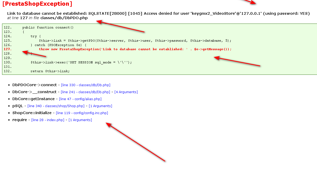

KeyVideo Posted February 10, 2023 Share Posted February 10, 2023 hello i have problem with database first i have old hosting i'm close this hosting But before closing it I pulled a copy of the database and a copy of all my store files I uploaded my store files to the new hosting Then I created a new database with the password Then I uploaded the database that I downloaded from the old hosting Then the data of the new rule was inserted into a file app/config/prematers.php and saved file done i'm going to refresh my store i get error I changed the password several times for the database, but to no avail Link to comment Share on other sites More sharing options...
arunvishwakarama Posted February 11, 2023 Share Posted February 11, 2023 On 2/10/2023 at 6:50 AM, KeyVideo said: hello i have problem with database first i have old hosting i'm close this hosting But before closing it I pulled a copy of the database and a copy of all my store files I uploaded my store files to the new hosting Then I created a new database with the password Then I uploaded the database that I downloaded from the old hosting Then the data of the new rule was inserted into a file app/config/prematers.php and saved file done i'm going to refresh my store i get error I changed the password several times for the database, but to no avail Hi First verify the password you created new also using password allowed If that's ok then remove cache folders and check again if still same check host for database or contact server guys Link to comment Share on other sites More sharing options...
KeyVideo Posted February 13, 2023 Author Share Posted February 13, 2023 On 2/11/2023 at 3:12 PM, arunvishwakarama said: Hi First verify the password you created new also using password allowed If that's ok then remove cache folders and check again if still same check host for database or contact server guys thank you for replay sir i'm fixed this problem from prameter.php change database host server from 1.7.0.0.1 to localhost Link to comment Share on other sites More sharing options...
