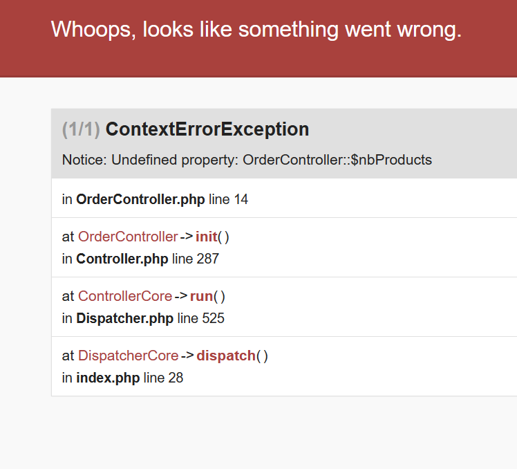

ChristianCH4 Posted February 10, 2023 Author Share Posted February 10, 2023 je viens de créer le fichier override, l'installer, vider le cache, créer le "produit" frais de gestion, récupérer son Id, mettre à jour et simuler un achat de produit inférieur à mon seuil de 150 euros et j'ai un erreur <?php class OrderController extends OrderControllerCore { public function init() { parent::init(); $this->cartChecksum = new CartChecksum(new AddressChecksum()); /* modification pour frais de gestion en dessous de 150 euros code produit frais de gestion 361 */ $id_fee_product = 361; $minimum_amount = 150; if ($this->nbProducts && $this->context->cart->getOrderTotal(true, Cart::ONLY_PRODUCTS) < $minimum_amount) { $this->context->cart->updateQty(1, $id_fee_product, 0, false, 'up', 0, null, false); } else { if ($result = $this->context->cart->containsProduct($id_fee_product)) $this->context->cart->deleteProduct($id_fee_product); } } } Link to comment Share on other sites More sharing options...
Eolia Posted February 10, 2023 Share Posted February 10, 2023 Remplacez $this->nbProducts() par $this->context->cart->nbProducts() Link to comment Share on other sites More sharing options...
ChristianCH4 Posted February 10, 2023 Author Share Posted February 10, 2023 Toujours en erreur. Ne faut-il pas forcer le nBProducts() à 1 ? Parse error: syntax error, unexpected '$this' (T_VARIABLE), expecting '(' in /home/epicerieka/www/ps/override/controllers/front/OrderController.php on line 14 <?php class OrderController extends OrderControllerCore { public function init() { parent::init(); $this->cartChecksum = new CartChecksum(new AddressChecksum()); /* modification pour frais de gestion en dessous de 150 euros code produit frais de gestion 361 */ $id_fee_product = 361; $minimum_amount = 150; if $this->context->cart->nbProducts() && $this->context->cart->getOrderTotal(true, Cart::ONLY_PRODUCTS) < $minimum_amount) { $this->context->cart->updateQty(1, $id_fee_product, 0, false, 'up', 0, null, false); } else { if ($result = $this->context->cart->containsProduct($id_fee_product)) $this->context->cart->deleteProduct($id_fee_product); } } } Link to comment Share on other sites More sharing options...
