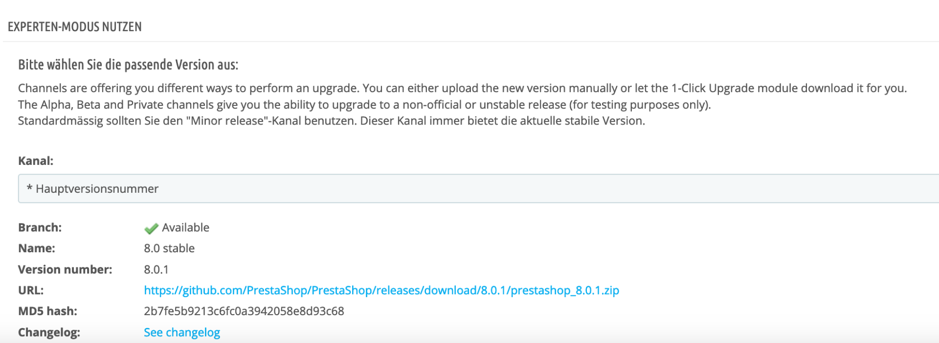

1. i wanted to update prestashop to version 8, cause this version seemed to be supported for php 8. i tried it via the 1 click update addon but i couldnt see the prestashop version 8.0. i found out, if i am changing the channel in expert mode to main releases, i could see it.
471977821_Bildschirmfoto2023-02-07um13_17_25.thumb.png.28e0eba2106aa0195a59c7e534a0aa84.png

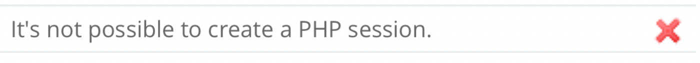

2. then i couldnt start the autoupgrade because of an error.
i didnt got a check for the php session part:
16210093_Bildschirmfoto2023-02-07um13_18_49.thumb.png.4a3180fd95bea3f8da1d36295d7b69d5.png

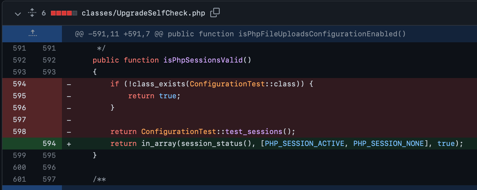

So i spend some time on guthub and found a solution, implementing some code in my modules > autoupgrade > classes > upgradeselfcheck.php
138256292_Bildschirmfoto2023-02-07um13_20_51.thumb.png.55db8e050419c3895200c55ec3c98f40.png
i could fix the bug with the autoupdate module and startet it.
