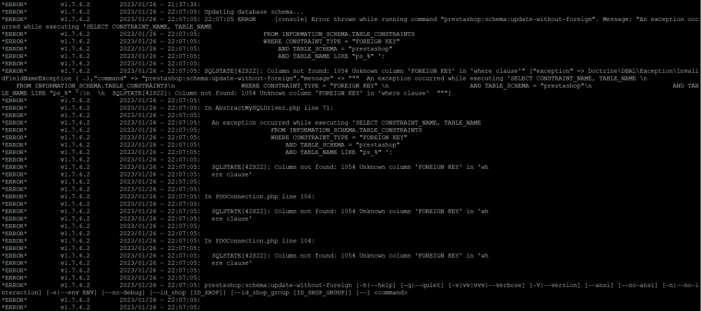

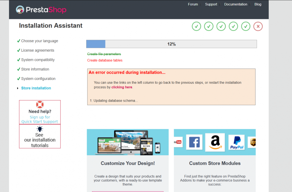

During a fresh Prestashop installation, I got this issue: "1: Updating database schema...".
The thing that I need to mention is, it would install properly on local mysql but not on the DigitalOcean managed databases.

and also here is the log info in the following path:
/var/www/html/MY.DOMAIN.NAME/var/logs
Any information you can provide me would be greatly appreciated!
