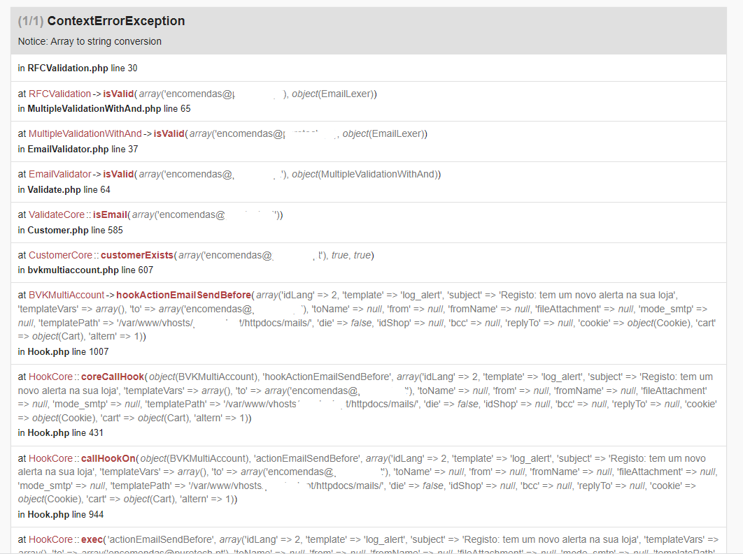

SaraCastro Posted January 26, 2023 Author Share Posted January 26, 2023 47 minutes ago, juanrojas said: performs the same operation but with debug mode active. Does it even happen to you with the bank transfer payment method? or what payment method are we talking about? Hi, yes it happens with bank transfer payment method also. The debug mode show error as image attached. Thanks. Link to comment Share on other sites More sharing options...
Nickz Posted January 26, 2023 Share Posted January 26, 2023 What do those hooklines say? 24 minutes ago, SaraCastro said: The debug mode show error as image attached. Thanks Link to comment Share on other sites More sharing options...
SaraCastro Posted January 26, 2023 Author Share Posted January 26, 2023 5 minutes ago, Nickz said: What do those hooklines say? I have translated to EN. in BVKMultiAccount->hookActionEmailSendBefore(array('idLang' => 2, 'template' => 'log_alert', 'subject' => 'Log: you have a new alert in your store', 'templateVars' => array(), 'to' => array('[email protected]'), 'toName' => null, 'from' => null, 'fromName' => null, 'fileAttachment' => null, 'mode_smtp' => null , 'templatePath' => '/var/www/vhosts/websitename.pt/httpdocs/mails/', 'die' => false, 'idShop' => null, 'bcc' => null, 'replyTo' => null, 'cookie' => object(Cookie), 'cart' => object(Cart), 'altern' => 1)) in Hook.php line 1007 at HookCore::coreCallHook(object(BVKMultiAccount), 'hookActionEmailSendBefore', array('idLang' => 2, 'template' => 'log_alert', 'subject' => 'Log: You have a new alert in your store', 'templateVars' => array(), 'to' => array('[email protected]'), 'toName' => null, 'from' => null, 'fromName' => null, 'fileAttachment' = > null, 'mode_smtp' => null, 'templatePath' => '/var/www/vhosts/websitename.pt/httpdocs/mails/', 'die' => false, 'idShop' => null, 'bcc' => null, 'replyTo' => null, 'cookie' => object(Cookie), 'cart' => object(Cart), 'altern' => 1)) in Hook.php line 431 at HookCore::callHookOn(object(BVKMultiAccount), 'actionEmailSendBefore', array('idLang' => 2, 'template' => 'log_alert', 'subject' => 'Log: You have a new alert in your store', 'templateVars' => array(), 'to' => array('[email protected]'), 'toName' => null, 'from' => null, 'fromName' => null, 'fileAttachment' = > null, 'mode_smtp' => null, 'templatePath' => '/var/www/vhosts/websitename.pt/httpdocs/mails/', 'die' => false, 'idShop' => null, 'bcc' => null, 'replyTo' => null, 'cookie' => object(Cookie), 'cart' => object(Cart), 'altern' => 1)) in Hook.php line 944 at HookCore::exec('actionEmailSendBefore', array('idLang' => 2, 'template' => 'log_alert', 'subject' => 'Log: You have a new alert in your store', 'templateVars' => array(), 'to' => array('[email protected]'), 'toName' => null, 'from' => null, 'fromName' => null, 'fileAttachment' => null, 'mode_smtp ' => null, 'templatePath' => '/var/www/vhosts/websitename.pt/httpdocs/mails/', 'die' => false, 'idShop' => null, 'bcc' => null, ' replyTo' => null, 'cookie' => object(Cookie), 'cart' => object(Cart), 'altern' => 1), null, true) in Mail.php line 174 Link to comment Share on other sites More sharing options...

SaraCastro Posted January 26, 2023 Author Share Posted January 26, 2023 7 minutes ago, juanrojas said: when you do an email test from advanced parameters> email address does it work for you? I have figure it out! It was related with an override file that i have. Thank you so much, for your help. Sara Link to comment Share on other sites More sharing options...
