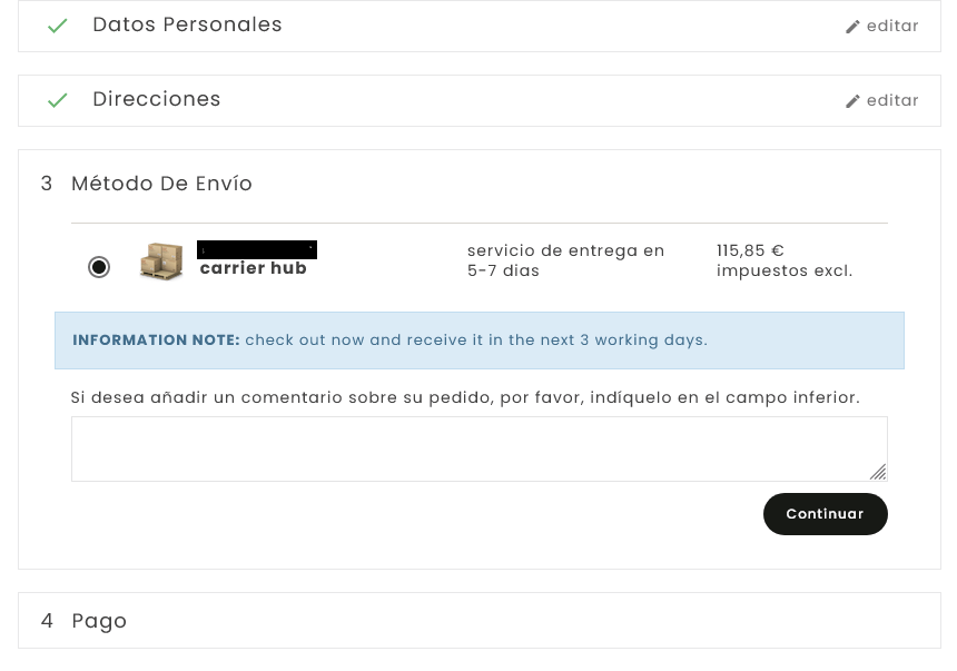

Manuel_GT Posted January 26, 2023 Share Posted January 26, 2023 Hola! Yo por descartar probaría a enviar primero html directo. A mi me funciona: return '<div class="col-sm-12 alert alert-warning" role="alert"><b>' . $this->trans('INFORMATION NOTE',[],'Modules.Aqdelivery.Admin') . ':</b> ' . $this->trans('The products you have selected require extra preparation and the expected shipment could be delayed up to 5 working days', [],'Modules.Aqdelivery.Admin') . '</div>'; Así ves si se te ha pasado algo en la llamada a la plantilla. No se. Link to comment Share on other sites More sharing options...

Manuel_GT Posted January 26, 2023 Share Posted January 26, 2023 /** * Podemos añadir mensajes específicos del cálculo de envío * @param $params * @param int $moduleId * @return string */ public function hookDisplayCarrierExtraContent($params, $moduleId = 0){ ... if ($delayed){ return '<div class="col-sm-12 alert alert-warning" role="alert"><b>' . $this->trans('INFORMATION NOTE',[],'Modules.Aqdelivery.Admin') . ':</b> ' . $this->trans('The products you have selected require extra preparation and the expected shipment could be delayed up to 5 working days', [],'Modules.Aqdelivery.Admin') . '</div>'; } else { return '<div class="col-sm-12 alert alert-info" role="alert"><b>' . $this->trans('INFORMATION NOTE',[],'Modules.Aqdelivery.Admin') . ':</b> ' . $this->trans('check out now and receive it in the next 3 working days.',[],'Modules.Aqdelivery.Admin') .'</div>'; } } registro del hook public function install() { ... return parent::install() && $this->registerHook('header') && $this->registerHook('backOfficeHeader') && $this->registerHook('updateCarrier') && $this->registerHook('actionValidateOrder') && $this->registerHook('displayCarrierExtraContent') && $this->registerHook('actionGetAdminOrderButtons') && $this->registerHook('actionCarrierProcess') && $this->registerHook('actionPaymentConfirmation'); } Se ve así (cuadro azul) MI versión actual de prestashop es 1.7.8.8 Link to comment Share on other sites More sharing options...
