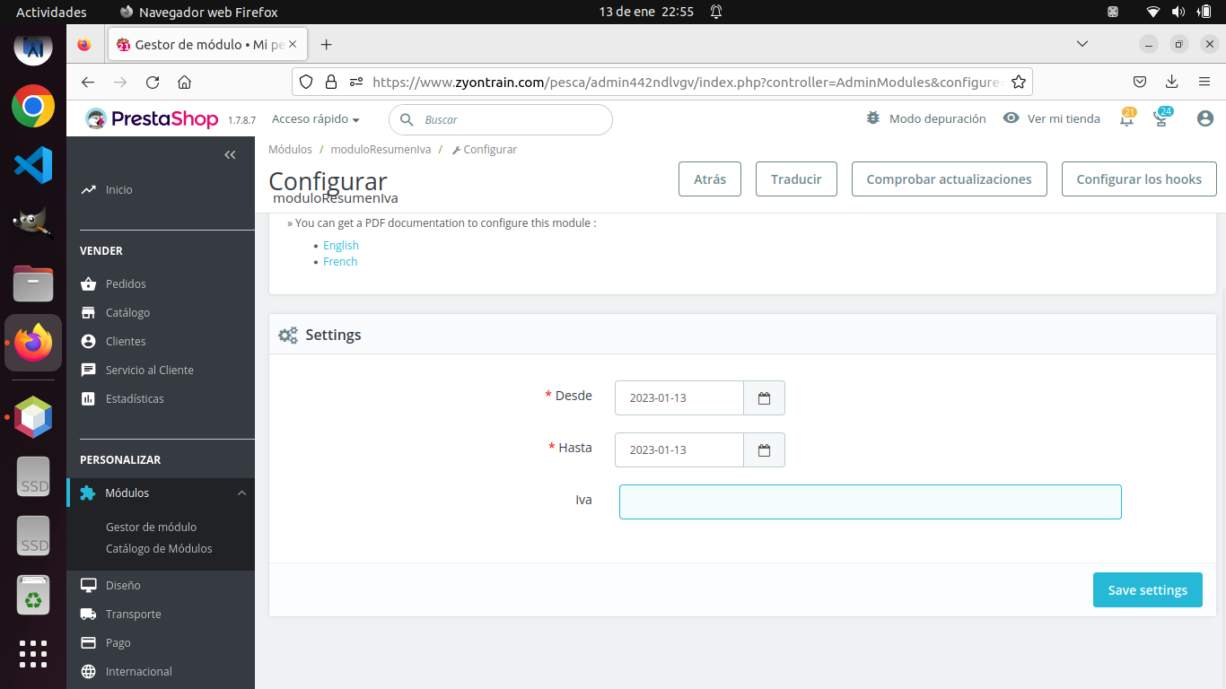

Update the VAT value in the configuration screen of the module.
hi, I am designing a module to calculate the VAT between two dates. I already have everything working, it already calculates the VAT perfectly, but now I want it to be displayed on the configuration screen of the module when clicking on save settings. It's the only thing I'm missing. Right now if I want the VAT to be shown I have to exit and re-enter the module configuration screen. Attached the complete code of the module. Right now where I try to update the VAT field is in the postProcess() function, with this line:Configuration::updateValue($this->name . '_iva', $ivaAcumulado);
<?php

an here's an screenshot of the configuration screen:
