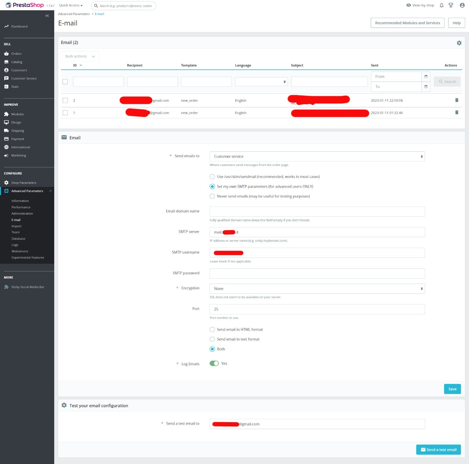

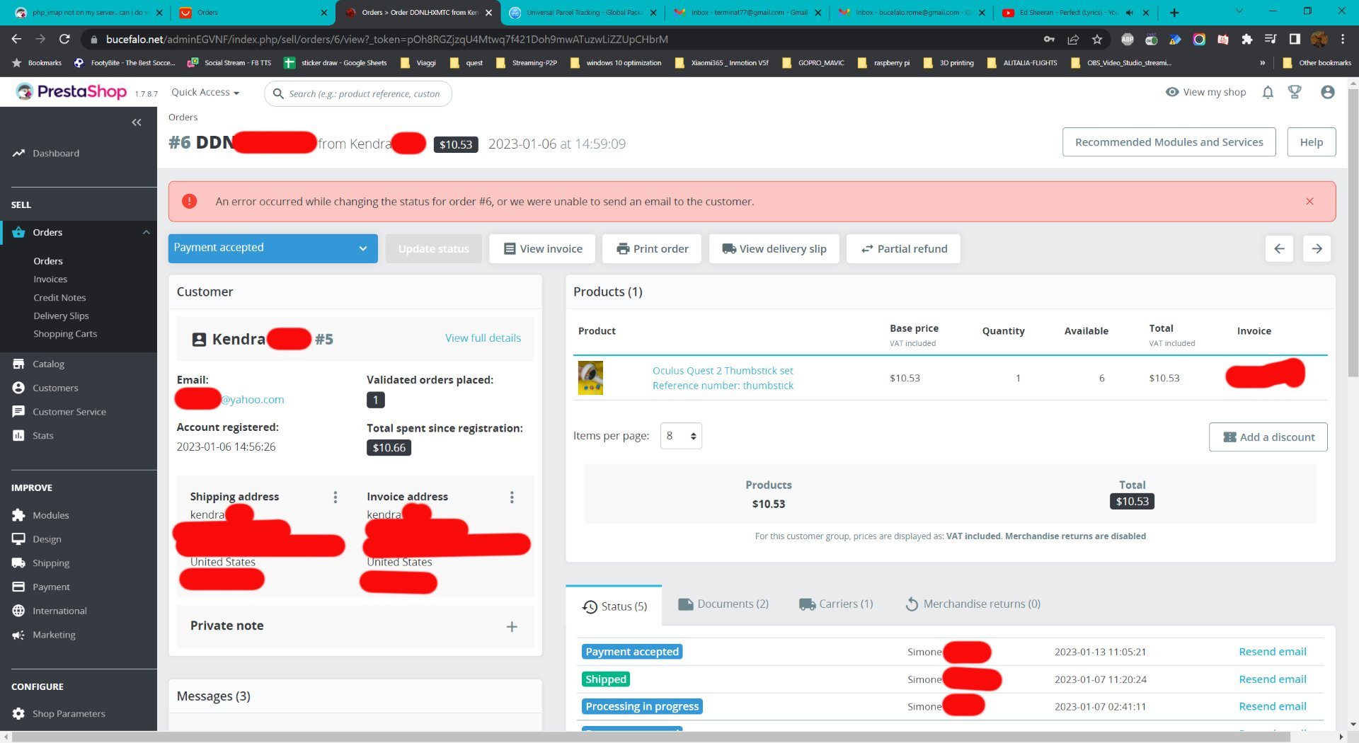

simirome Posted January 13, 2023 Author Share Posted January 13, 2023 @endriu107 thank you for your prompt reply i try to explain myself better I use Classic them version 1.0.0 ( if that helps ) if i go to ORDERS ---> ORDERS Order status and i change it to " shipped" ( or any other status ) i get this warning : "an error occured while changing the status for order #6, or we were unable to send an email to the customer" now i suppose that when i change the status an email is sent " automatically "to customer " but i get this error ! Now if i go to ADVANCED parameters ----> EMAIL ( i attach a second image ) and i try to send a TEST email , well this works, i get email sent and over the test email address i get the TEST email! Last " problem " connected to this email setup is this.. if i go in CUSTOMER SERVICE select " 1 new message " i write an answer and i SEND it i get this error: Error - The following e-mail template is missing: reply_msg So all seems to be connected to email setting but i don't really know how to make those changing ! thank you for any further help ! Link to comment Share on other sites More sharing options...
