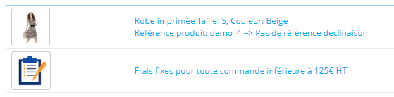

Eolia Posted August 30, 2023 Share Posted August 30, 2023 (edited) Si ref sur attribut: Si pas de ref sur l'attribut ou ref identique: Edited August 30, 2023 by Eolia (see edit history) Link to comment Share on other sites More sharing options...
Eolia Posted August 30, 2023 Share Posted August 30, 2023 On peut adapter le texte si les références sont les mêmes: Link to comment Share on other sites More sharing options...
