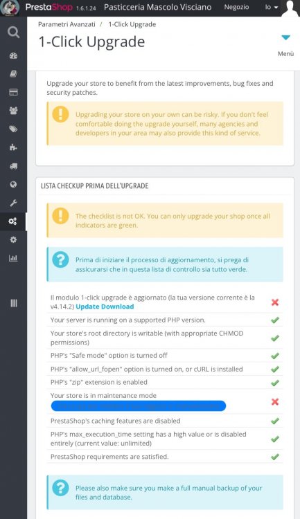

MoltenBoron81 Posted January 4, 2023 Share Posted January 4, 2023 Hello, i need to upgrade my prestashop from 1.6 to the 1.7 version. Tried to update it with 1-Click module, but the checklist shows a red cross near the request “1-Click updater must be up-to-date” even if the module is already up-to-date. Consequently, I can’t run the prestashop update. Does anybody know how to solve? Thanks in advance Link to comment Share on other sites More sharing options...

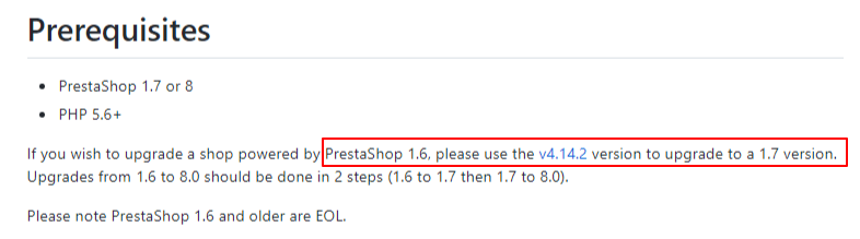

nxtc Posted January 24, 2023 Share Posted January 24, 2023 Hi, As specified on the link you provide, the 4.14.2 is the good version for Pretashop 1.6: I have the same problem on a 1.6, I can't upgrade to 1.7 either to newer 1.6: It says "The module is up to date", with red cross and "Update" and "Download" links, but impossible to update the module from Prestashop backoffice, and the version is the one required as I said previously. If anyone has an idea... Regards Link to comment Share on other sites More sharing options...

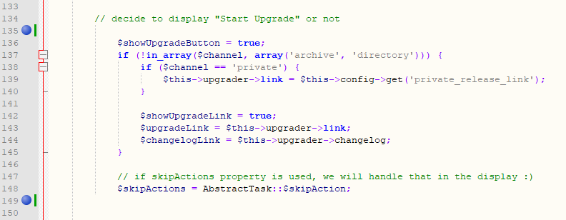

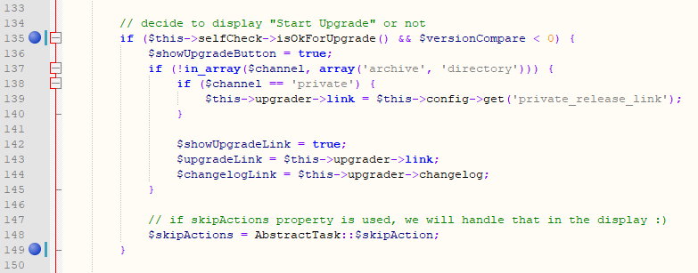

skinnybloke Posted February 8, 2023 Share Posted February 8, 2023 I've got a solution to this - a bit of a hack but hey ho, it works for what I want... Remove lines 135 and 149 from the following file so that it does not check on the status of the items: \modules\autoupgrade\classes\Twig\Block\UpgradeButtonBlock.php From: To Link to comment Share on other sites More sharing options...
