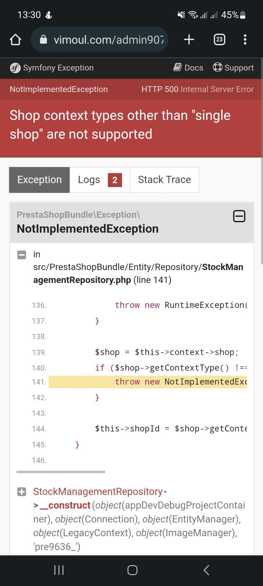

ViMOUL Posted December 26, 2022 Author Share Posted December 26, 2022 Bonj , J ai fais et ça marché sauf que je rencontre une erreur en modifiant les commandes a "livré" Shop context types other than "single shop" are not supported Prestashop : 1.7.4.4 Link to comment Share on other sites More sharing options...
Mediacom87 Posted December 26, 2022 Share Posted December 26, 2022 il y a 33 minutes, ViMOUL a dit : Shop context types other than "single shop" are not supported Peut-être un bug de PrestaShop, essayez de vous mettre dans le contexte de la boutique à laquelle correspond cette commande. Link to comment Share on other sites More sharing options...
