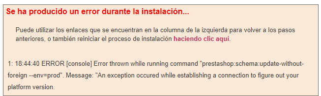

dwilden Posted December 21, 2022 Share Posted December 21, 2022 (edited) Hi, I try to install new version 1.7.8.8 on a clean server but the installation stops creating the tables with this error "An exception occured while establishing a connection to figure out your platform version" I using PHP 7.2.34, MySQL 5.7.40, InnoDB and DbPDO driver (Upgrading from a working 1.7.8.7 to 1.7.8.8 same error) Can somebody help me? Edited March 10, 2023 by dwilden (see edit history) Link to comment Share on other sites More sharing options...

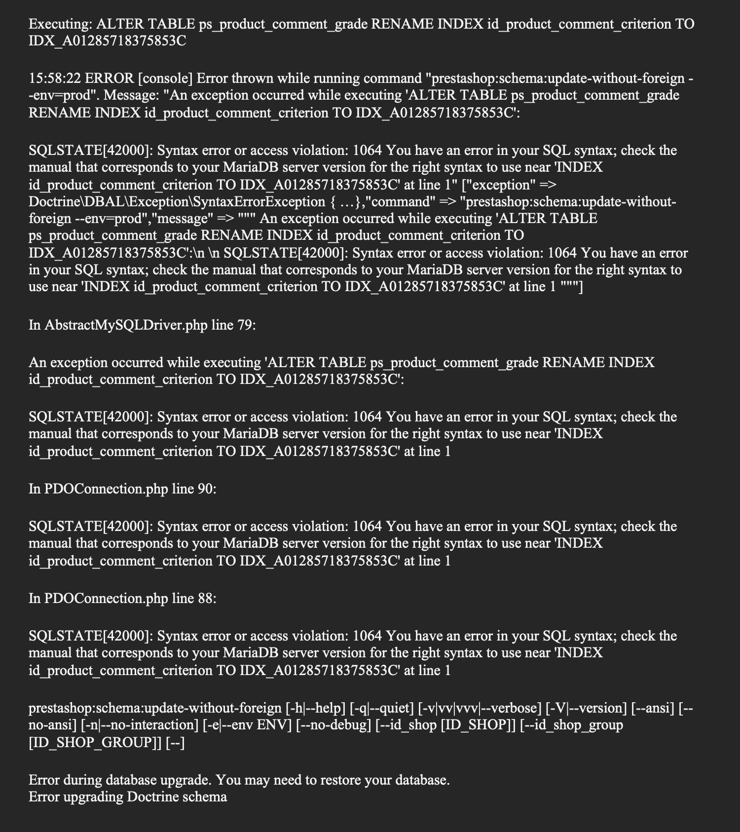

metlive Posted January 12, 2023 Share Posted January 12, 2023 I was updating from 1.7.8.5 to 1.7.8.8 and I got this error. Can you tell me what it is? The e-shop works correctly, the orders work. I have PHP 7.4 and MariaDB 10.5 Thank you Link to comment Share on other sites More sharing options...
