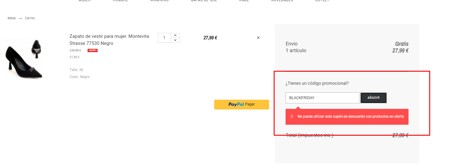

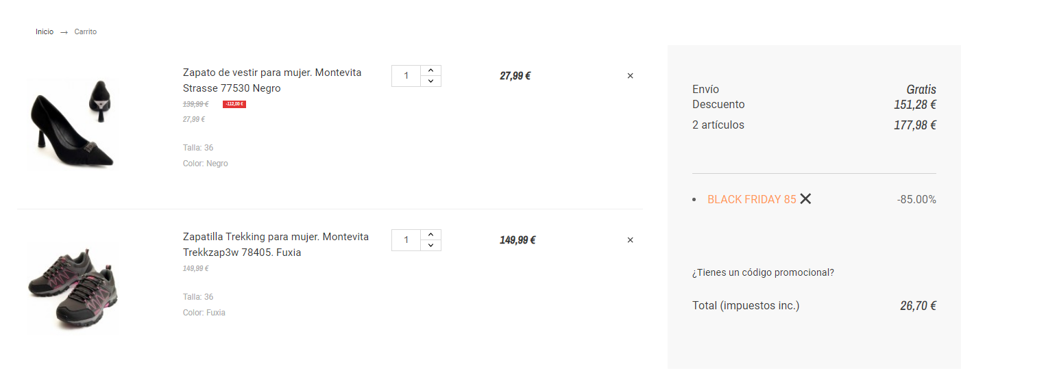

bozoom Posted November 24, 2022 Share Posted November 24, 2022 Buenos días Tenemos un problema con los códigos descuento: 1. Creamos un cupón descuento no compatible con productos ofertados 2. Si se mete en el carrito un producto ofertado y se le da al cupón, efectivamente NO LO APLICA el cupón ( funciona correcto) 3. Pero si se mete en el carrito un producto sin descuento + un producto con descuento SI APLICA EL CUPÓN A AMBOS. Debería aplicar el cupon al producto SIN DESCUENTO pero no al producto con descuento ¿ podéis ayudarnos? Gracias Link to comment Share on other sites More sharing options...

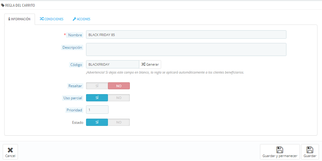

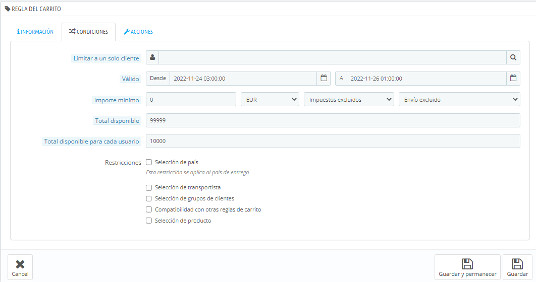

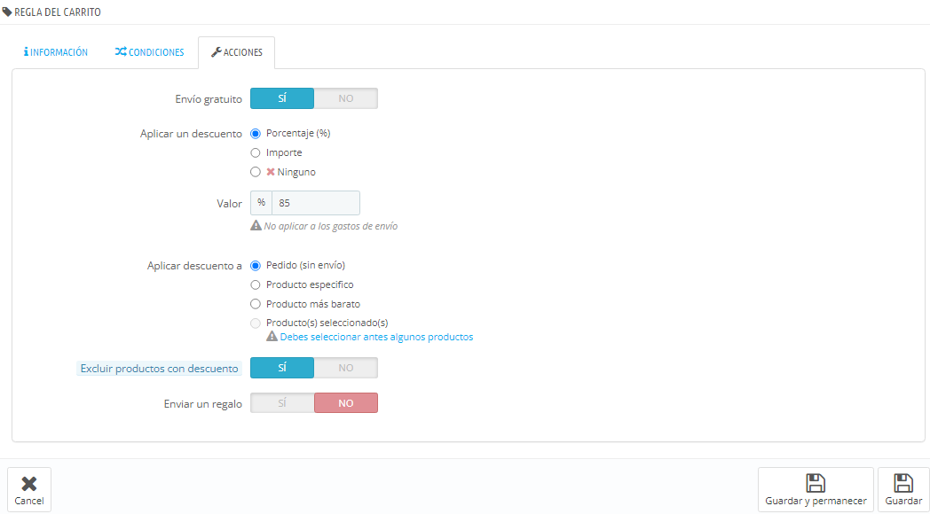

rthakur Posted November 24, 2022 Share Posted November 24, 2022 1 minute ago, bozoom said: Hello We have a problem with discount codes: 1. We create a discount coupon that is not compatible with products offered 2. If an offered product is placed in the cart and the coupon is given, the coupon DOES NOT APPLY (it works correctly) 3. But if a product without a discount + a product with a discount is put in the cart IF THE COUPON APPLIES TO BOTH. The coupon should be applied to the NO DISCOUNT product but not to the discounted product can you help us? Gracias Can you share some screenshot backoffice. What condition you are using in coupon create? Link to comment Share on other sites More sharing options...
bozoom Posted November 24, 2022 Author Share Posted November 24, 2022 Hello rthakur, here you have ( thank you..) Link to comment Share on other sites More sharing options...

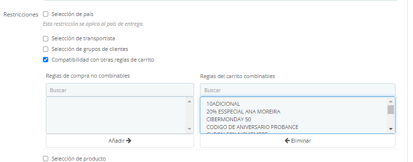

juanrojas Posted November 24, 2022 Share Posted November 24, 2022 hola en la pestaña condiciones, abajo dice restricciones deberias de poner alli donde no quieres que aplique Link to comment Share on other sites More sharing options...
bozoom Posted November 24, 2022 Author Share Posted November 24, 2022 Hola @ Juan Rojas Gracias por tu respuesta. No obstante sigo sin tenerlo claro. Aquí es donde tu me dices... pero el problema no es ese El problema es que si eljo un producto con descuento, no le aplica el cupon ( bien) pero si elijo en la cesta uno con descuento y otro sin descuento , en ese caso si aplica el cupón pero no solo al que tendría que aplicar ( el que no tiene descuento) sino que lo aplica a los dos... tanto al que debería como que no. No se si me explico... UN SOLO PRODUCTO DE OFERTA: bien, no deja aplicar. AQUÍ EL MISMO PERO AÑADIENDO UN PRODUCTO SIN DESCUENTO ANTERIOR: MAL, puesto que aplica el descuento en ambos. ( mientras que antes no lo hacia al que no debía hacerlo) Link to comment Share on other sites More sharing options...

joseantgv Posted November 25, 2022 Share Posted November 25, 2022 Es así como funciona PS 🤷♂️ No es un problema de configuración. Deberías buscar un módulo para solucionar eso. Link to comment Share on other sites More sharing options...
