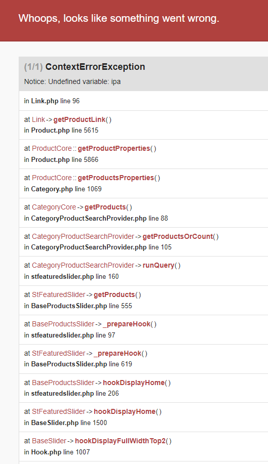

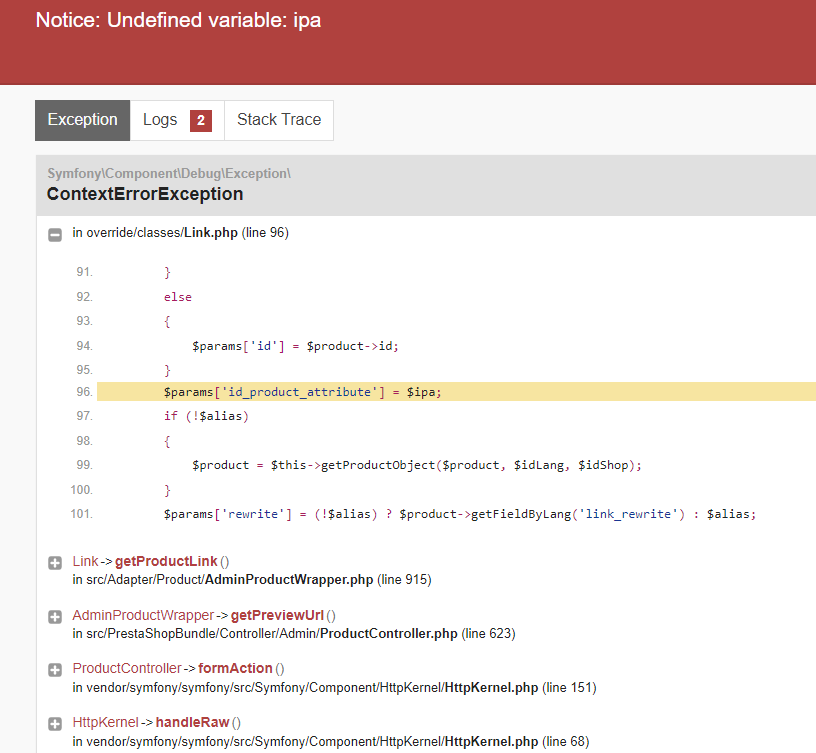

ollys Posted November 19, 2022 Author Share Posted November 19, 2022 But unfortunatly only backend is running.... frontend gave this problems: (1/1) ContextErrorException Notice: Undefined variable: ipa in Link.php line 96 at Link->getProductLink()in Product.php line 5615 .... Link to comment Share on other sites More sharing options...
juanrojas Posted November 19, 2022 Share Posted November 19, 2022 disable friendly urls Link to comment Share on other sites More sharing options...
ollys Posted November 19, 2022 Author Share Posted November 19, 2022 good idea.. but still not working! when i try to open an article in backend to edit i also get an error. i deleted the cache via ftp etc... but still the error... Link to comment Share on other sites More sharing options...
