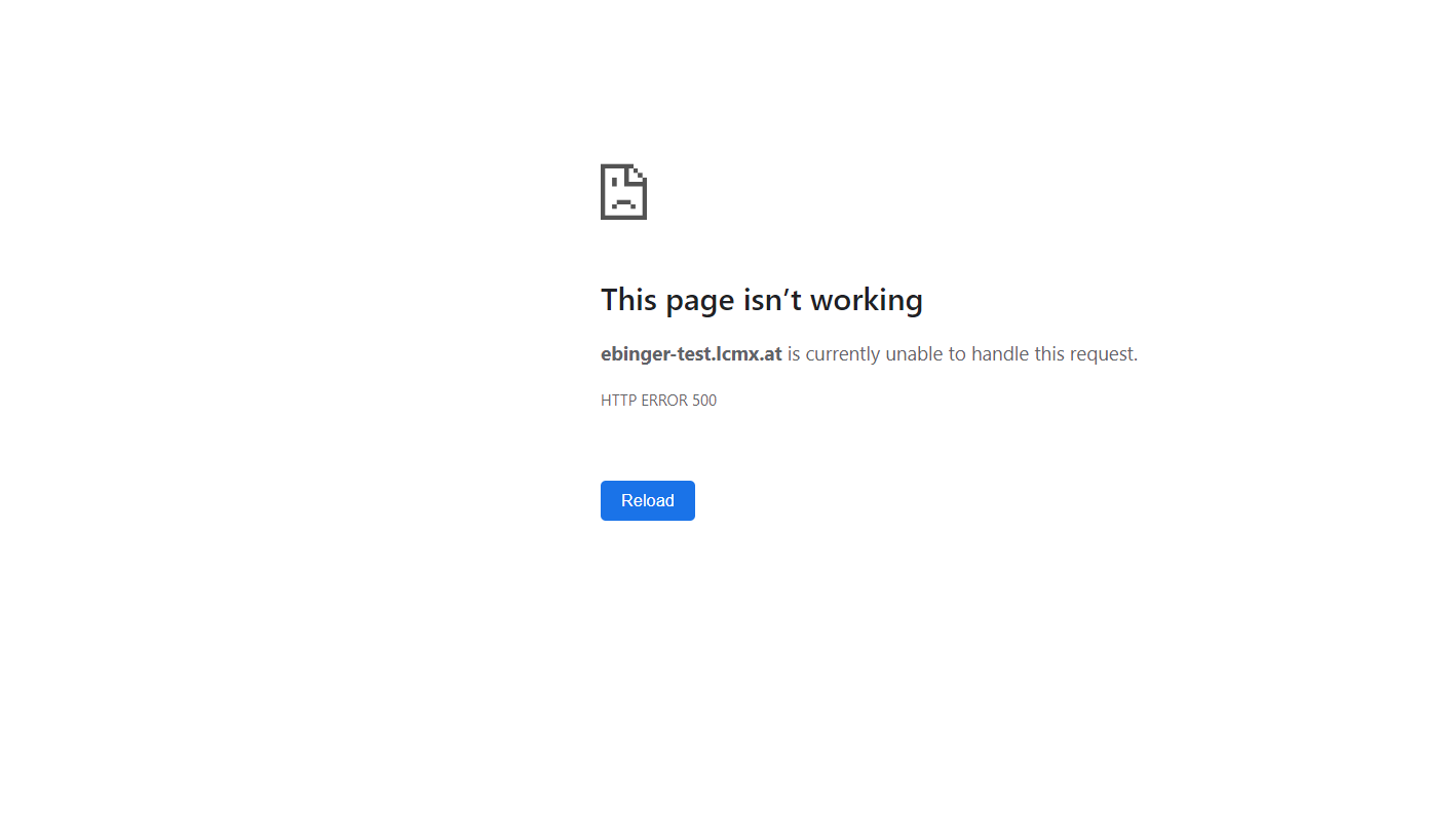

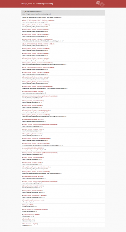

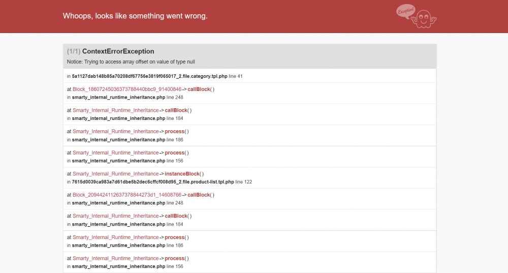

Pragati P Posted November 11, 2022 Share Posted November 11, 2022 I had created the new category from admin panel but when i try to access it from frontside it gives the below error can any one help me for solution. Link to comment Share on other sites More sharing options...

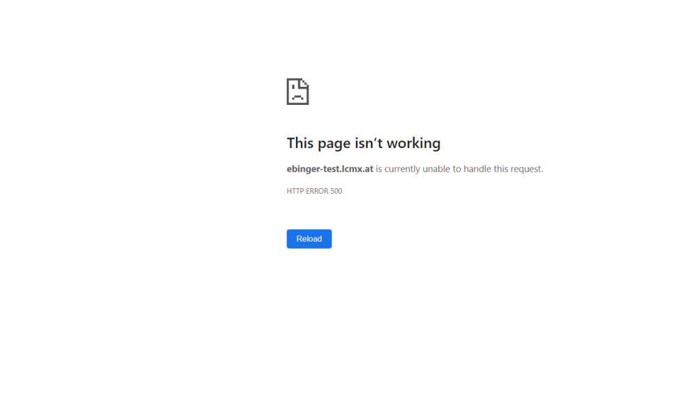

Pragati P Posted November 11, 2022 Author Share Posted November 11, 2022 (edited) On 11/11/2022 at 7:41 AM, endriu107 said: Turn off debug mode. Expand if off the debug mode it throughs the another issue below is screen shot site gets failed Edited November 11, 2022 by Pragati P (see edit history) Link to comment Share on other sites More sharing options...
Mediacom87 Posted November 11, 2022 Share Posted November 11, 2022 Hi, have you tried to clear PrestaShop's cache manually? https://www.mediacom87.fr/en/faq-how-to-clear-the-cache-manually-on-prestashop-17/ Link to comment Share on other sites More sharing options...
Pragati P Posted November 14, 2022 Author Share Posted November 14, 2022 YEs On 11/11/2022 at 8:07 PM, Mediacom87 said: Hi, have you tried to clear PrestaShop's cache manually? https://www.mediacom87.fr/en/faq-how-to-clear-the-cache-manually-on-prestashop-17/ Expand Thanks for your reply, I have tried the above solution when I delete the dev and prod folder site works fine but again that folder are created so every time I need to delete this folder when I faced issue like above? Link to comment Share on other sites More sharing options...
Mediacom87 Posted November 14, 2022 Share Posted November 14, 2022 On 11/14/2022 at 5:10 AM, Pragati P said: I have tried the above solution when I delete the dev and prod folder site works fine but again that folder are created so every time I need to delete this folder when I faced issue like above? Expand It is normal that this folder is created, it is the normal functioning of PrestaShop, it corresponds to the cache of PrestaShop, we force its deletion when there is an inconsistency in the data. Link to comment Share on other sites More sharing options...
Pragati P Posted November 15, 2022 Author Share Posted November 15, 2022 On 11/14/2022 at 8:39 AM, Mediacom87 said: It is normal that this folder is created, it is the normal functioning of PrestaShop, it corresponds to the cache of PrestaShop, we force its deletion when there is an inconsistency in the data. Expand but again and again facing this issue Link to comment Share on other sites More sharing options...
Mediacom87 Posted November 15, 2022 Share Posted November 15, 2022 So, you have a problem on your theme concerning the category.tpl page Link to comment Share on other sites More sharing options...
Pragati P Posted November 17, 2022 Author Share Posted November 17, 2022 On 11/15/2022 at 7:10 PM, Mediacom87 said: So, you have a problem on your theme concerning the category.tpl page Expand Now its working fine, i had disabled the debugging mode and deleted the dev and prod folder from var/cache Link to comment Share on other sites More sharing options...
Mediacom87 Posted November 17, 2022 Share Posted November 17, 2022 On 11/17/2022 at 5:17 AM, Pragati P said: Now its working fine, i had disabled the debugging mode and deleted the dev and prod folder from var/cache Expand You have hidden the error, but it is still there. Link to comment Share on other sites More sharing options...
Pragati P Posted November 17, 2022 Author Share Posted November 17, 2022 On 11/17/2022 at 7:46 AM, Mediacom87 said: You have hidden the error, but it is still there. Expand What's the solution for this ? Link to comment Share on other sites More sharing options...
Mediacom87 Posted November 18, 2022 Share Posted November 18, 2022 On 11/17/2022 at 9:41 AM, Pragati P said: What's the solution for this ? Expand It is enough to correct the displayed error, for that, it is necessary to analyze the code in question to bring the adapted solution, there, one has only the error, not the code causing the error. But often, the solution is to apply an isset() to the called variable to check that it exists before trying to process it. Link to comment Share on other sites More sharing options...
