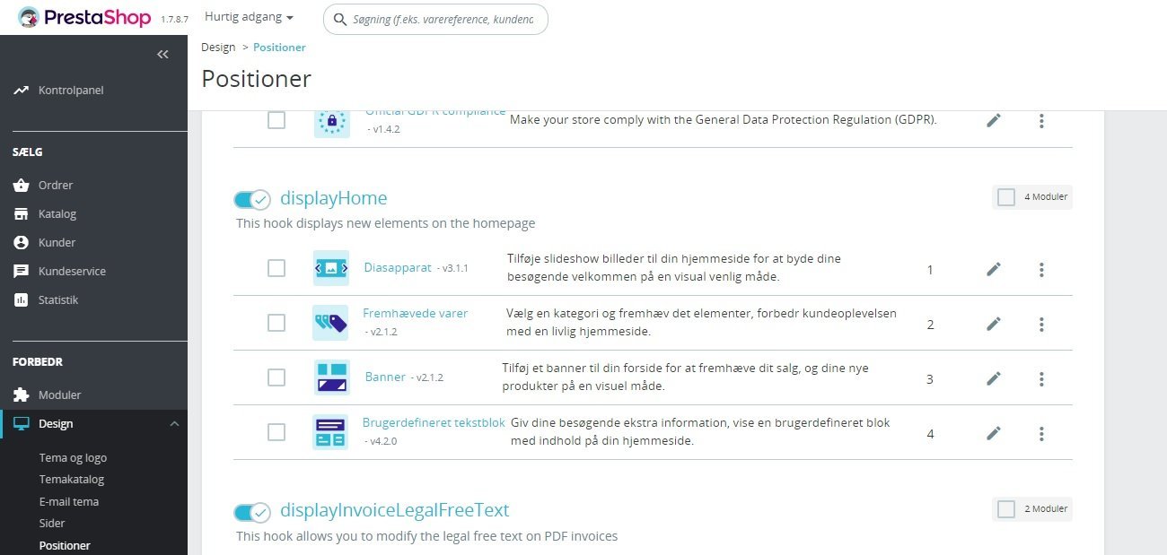

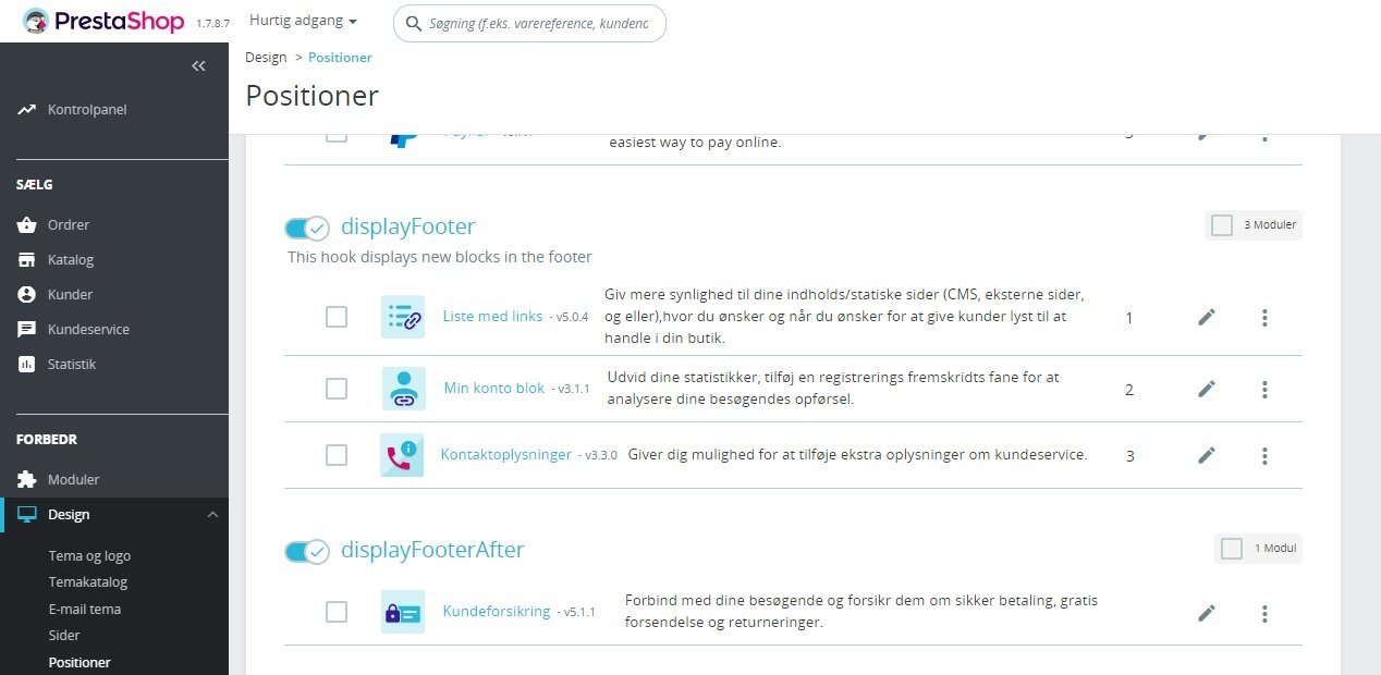

ZIKODK Posted November 3, 2022 Share Posted November 3, 2022 Hello again, ComGrafPL has a point here. Can you try this: Go to Design>Positions. Take a screenshot of the contents of the following: displayHome, displayFooter, displayFooterAfter. They must be the most interesting ones. Link to comment Share on other sites More sharing options...

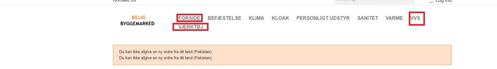

Muzammil Mac Posted November 3, 2022 Share Posted November 3, 2022 I think the categories are causing these large spaces. if you inspect the submenu of these three categories I have marked in image, You will see. Link to comment Share on other sites More sharing options...
ZIKODK Posted November 3, 2022 Share Posted November 3, 2022 (edited) 4 hours ago, Muzammil Mac said: I think the categories are causing these large spaces. if you inspect the submenu of these three categories I have marked in image, You will see. Good point!!! Supply. Kurt, try to disable"Hovedmenu". If your problem disappears, you have to restructure your category structure. Edited November 3, 2022 by ZIKODK Supply text. (see edit history) Link to comment Share on other sites More sharing options...
Danmant_DK Posted November 3, 2022 Author Share Posted November 3, 2022 10 hours ago, ZIKODK said: Hello again, ComGrafPL has a point here. Can you try this: Go to Design>Positions. Take a screenshot of the contents of the following: displayHome, displayFooter, displayFooterAfter. They must be the most interesting ones. Hello Attached are the screenshots Link to comment Share on other sites More sharing options...
Danmant_DK Posted November 3, 2022 Author Share Posted November 3, 2022 6 hours ago, ZIKODK said: Good point!!! Supply. Kurt, try to disable"Hovedmenu". If your problem disappears, you have to restructure your category structure. It solve the problem! How do i restructure the category structure? I have all the categories as a csv file and import them in BO Link to comment Share on other sites More sharing options...
Danmant_DK Posted November 3, 2022 Author Share Posted November 3, 2022 2 minutes ago, Danmant_DK said: It solve the problem! How do i restructure the category structure? I have all the categories as a csv file and import them in BO Quite by chance, I discovered that the empty space corresponds exactly to the space used by the drop-down menu for the front page. Could that be where the problem lies? Link to comment Share on other sites More sharing options...
Danmant_DK Posted November 3, 2022 Author Share Posted November 3, 2022 5 minutes ago, Danmant_DK said: Quite by chance, I discovered that the empty space corresponds exactly to the space used by the drop-down menu for the front page. Could that be where the problem lies? I remember from earlier versions, that the display of the drop-down menu could be changed. But i do not remember where? Link to comment Share on other sites More sharing options...

Danmant_DK Posted November 6, 2022 Author Share Posted November 6, 2022 On 11/3/2022 at 9:21 PM, Danmant_DK said: I manually added a category for every product in the supplyer product file. After importing all the products with category, i exported all the categories in a csv file for backup and for future clean ps installations. Therefor i have disbelieve in how i, in this way, can change the structure I have deleted 2 of the categories from the top menu and it solves the problem. The empty space is created by the space needed in the drop-down menu. Why, I don't know Link to comment Share on other sites More sharing options...
