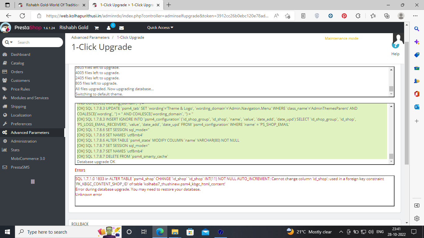

rushaboswal.rdx Posted October 28, 2022 Share Posted October 28, 2022 SQL 1.7.1.0 1833 in ALTER TABLE `psm4_shop` CHANGE `id_shop` `id_shop` INT(11) NOT NULL AUTO_INCREMENT: Cannot change column 'id_shop': used in a foreign key constraint 'FK_KBGC_CONTENT_SHOP_ID' of table 'kolhabs7_thushinew.psm4_kbgc_html_content'Error during database upgrade. You may need to restore your database.Unknown error This is the error i get. i tried it multiple times to no avail. knidly help out Link to comment Share on other sites More sharing options...

rushaboswal.rdx Posted October 29, 2022 Author Share Posted October 29, 2022 Just now, ComGrafPL said: Getting any errors on database? Upgrade still with issues? Have you change theme to classic and remove custom modules before update? 1.6 to 1.7 is pain sometime, also because PHP. This errror SQL 1.7.1.0 1833 in ALTER TABLE `psm4_shop` CHANGE `id_shop` `id_shop` INT(11) NOT NULL AUTO_INCREMENT: Cannot change column 'id_shop': used in a foreign key constraint 'FK_KBGC_CONTENT_SHOP_ID' of table'kolhabs7_thushinew.psm4_kbgc_html_content'Error during database upgrade. You may need to restore your database.Unknown error Yes theme change to classic . Non prestashop modules removed tried different php too Link to comment Share on other sites More sharing options...
