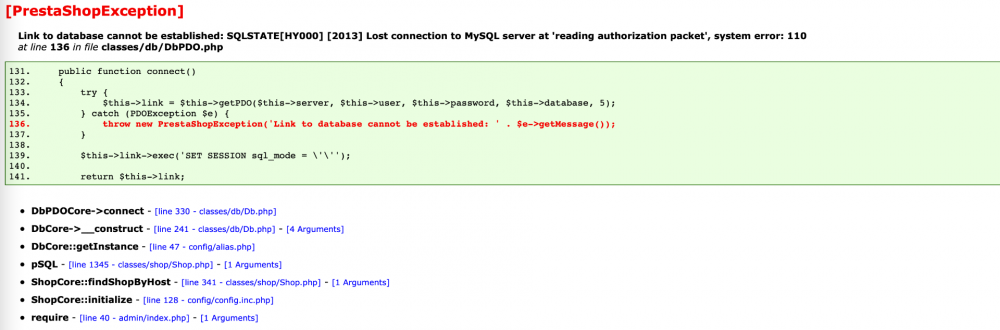

www.exclusivepen.eu Posted October 24, 2022 Share Posted October 24, 2022 Greetings everybody. Recently we are experiencing more and more, totally random 500 erros as shown below (backoffice and frontoffice). The hosting provider says everything is ok from their side so I need someone experienced to look at this from our side. Anyone who can help? Thank you very much:) Link to comment Share on other sites More sharing options...

www.exclusivepen.eu Posted October 24, 2022 Author Share Posted October 24, 2022 1 hour ago, joseantgv said: I'd say that this error should be fixed by your provider 🤷♂️ Hi @joseantgv. Well, this is the thing. I have contacted them twice because of this and they say the problem is not on their side. Do you have any suggestions, what exactly they should check on the server side? Thanks a lot for any help! Andrej Link to comment Share on other sites More sharing options...
joseantgv Posted October 25, 2022 Share Posted October 25, 2022 On 10/24/2022 at 3:52 PM, www.exclusivepen.eu said: Hi @joseantgv. Well, this is the thing. I have contacted them twice because of this and they say the problem is not on their side. Do you have any suggestions, what exactly they should check on the server side? Thanks a lot for any help! Andrej Unfortunately I don't have the system knowledge to give you the solution but according to this thread from SO https://stackoverflow.com/questions/21091850/error-2013-hy000-lost-connection-to-mysql-server-at-reading-authorization-pa you could try to increase the connection timeout. As you can read, all the possible solutions are from the server side, not from the software. Link to comment Share on other sites More sharing options...
QuickUpdate.net Posted November 14, 2022 Share Posted November 14, 2022 if your db config is correct and you get this error it is most probably on the hoster side Link to comment Share on other sites More sharing options...
