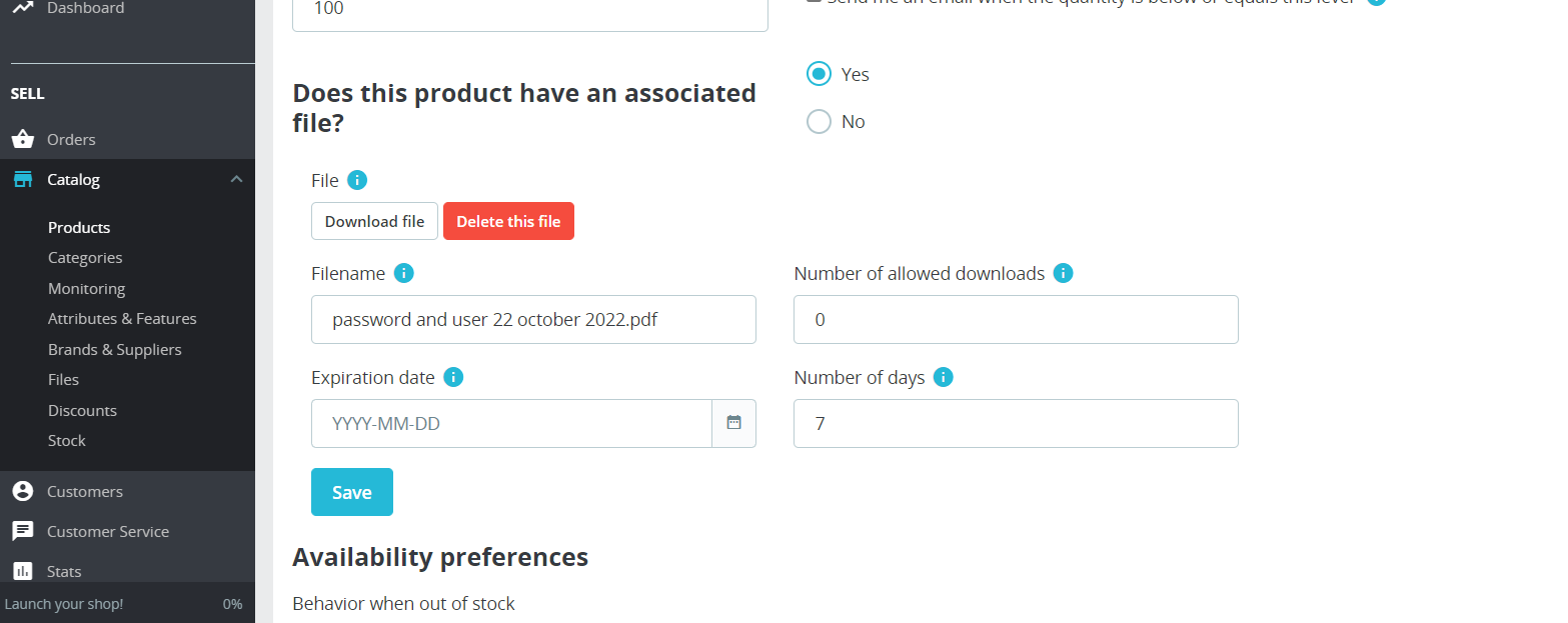

jsgastoniriartecabre Posted October 22, 2022 Author Share Posted October 22, 2022 Hi, the function I have to create ... sounds complicated for me to do in my first 24 h of php ... can you help me with this? (please help) For the products I just whent to catalogue -> productos, I created some products -> one of them virtual product (for the password for the iframe) ->and one of them gave 7 days Link to comment Share on other sites More sharing options...

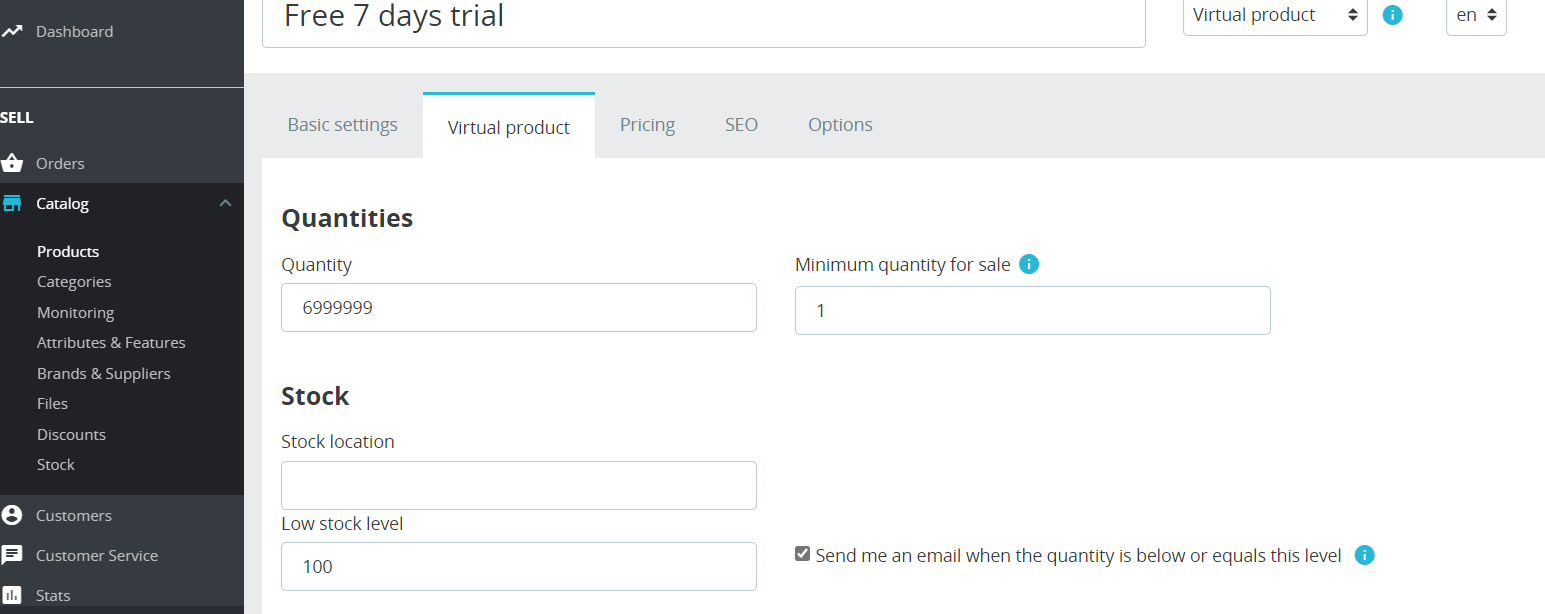

jsgastoniriartecabre Posted October 25, 2022 Author Share Posted October 25, 2022 (edited) On 10/24/2022 at 10:32 AM, ZiedDams said: and also what you mean by a virtual product for the iframe password ? I didn't get your point at all. I just tried to explain how I made my virtual products, it doesn't matter. I need to show a iframe or a web page when accesing to : my-account. And don't know how to create the function (don't whant to try and break the database). Also, sorry ... I would love to pay for your skills ... but just dont have $ and need help to finish this job Edited October 25, 2022 by jsgastoniriartecabre (see edit history) Link to comment Share on other sites More sharing options...
jsgastoniriartecabre Posted October 26, 2022 Author Share Posted October 26, 2022 On 10/24/2022 at 10:32 AM, ZiedDams said: and also what you mean by a virtual product for the iframe password ? I didn't get your point at all. hi, I think I havent explained correctly .... dont know much more about functions than this: public function __subscription() { } ***please help with the subscription. This is what I did to add subscriptions to the products Link to comment Share on other sites More sharing options...
