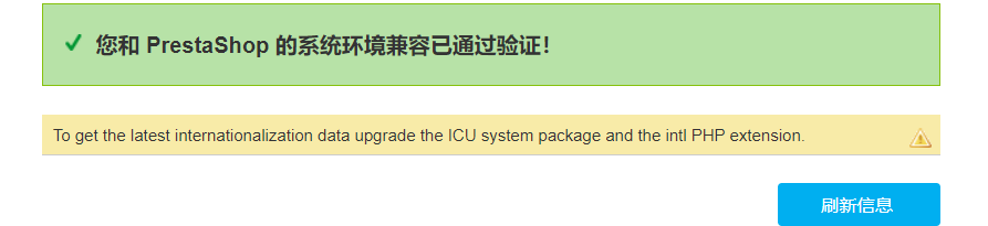

user8139 Posted November 15, 2022 Share Posted November 15, 2022 When I install prestashop 1.7.8.7, this message appears. What can I do Link to comment Share on other sites More sharing options...

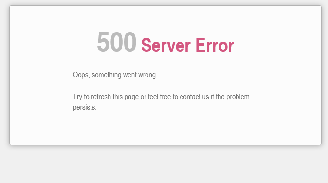

ketamina Posted December 2, 2022 Author Share Posted December 2, 2022 I was forced to move from another hosting. I saved the backup of the site directly from the one.com provider with a comfortable compressed archive + the sql database. I uploaded everything on the new hosting but I can't get out of this problem: Link to comment Share on other sites More sharing options...
juanrojas Posted December 2, 2022 Share Posted December 2, 2022 - clear cache via ftp - enable debug mode via ftp Link to comment Share on other sites More sharing options...

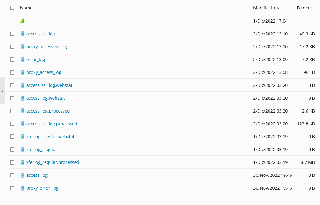

ketamina Posted December 2, 2022 Author Share Posted December 2, 2022 3 minutes ago, juanrojas said: - clear cache via ftp - enable debug mode via ftp thanks for your quick reply. By "delete the cache" do you mean FTP access to the /cache/ path and delete ALL the content there? i'm usind PLESK 18.0.48 on AlmaLinux 8.7, I already have all the active logs, which ones would you like to see? Link to comment Share on other sites More sharing options...

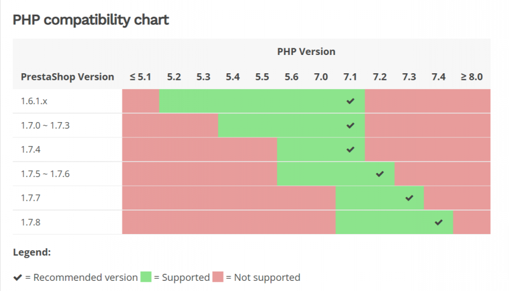

greg_m Posted April 4, 2023 Share Posted April 4, 2023 @Pragati P - PS 1.7.8 doesn't support PHP 8.0. Updated compatibility chart below (source: link) If you can't downgrade PHP, perhaps you can upgrade PS? PS 8.x supports PHP 8.0. Check the compatibility of other addons, themes you use with PS 8.0 first. 1 Link to comment Share on other sites More sharing options...
