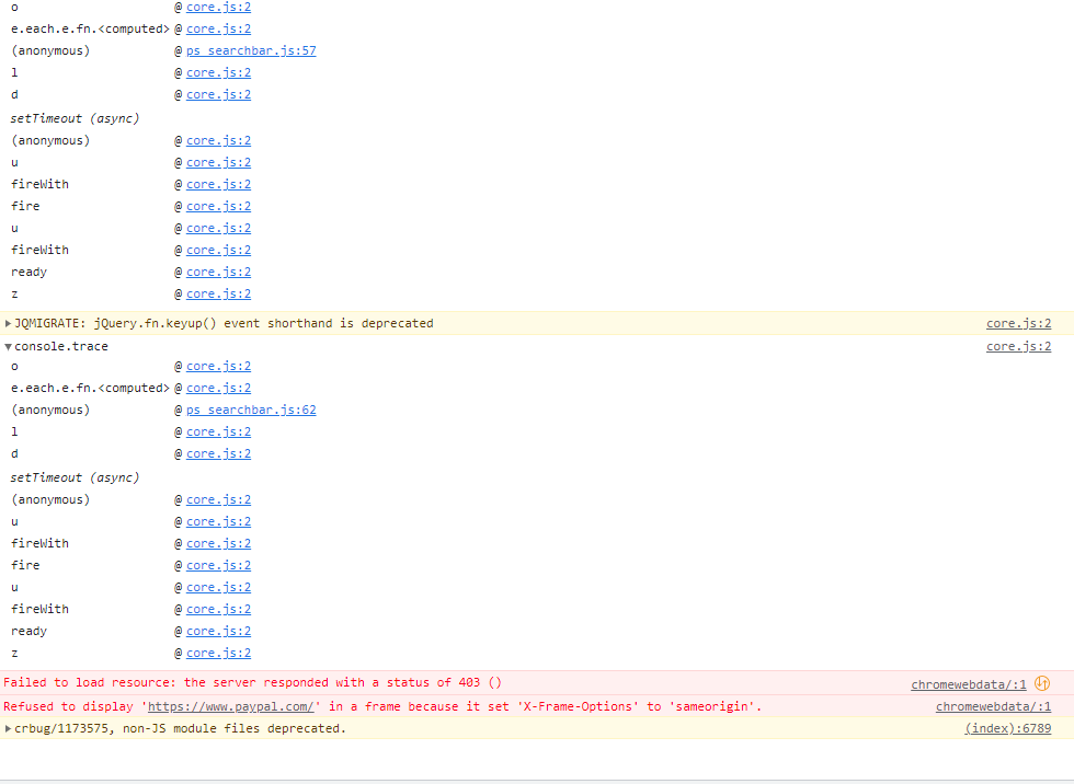

MorpheusUno Posted October 12, 2022 Share Posted October 12, 2022 (edited) I don't know what happened, but shopping cart modal suddenly not working. I tried all methods suggested on previous issues such as uninstalling modules recently installed, unistalling and installing shoppingcart module, cleared cache, and all tpl files in module directory for both themes/module and myshop/module is there but nothing seems to work, please help. Here is my website for reference www.mariekitcanada.com Thank you in advance 🙂 Edited October 13, 2022 by MorpheusUno url suggesting its ssl is invalid (see edit history) Link to comment Share on other sites More sharing options...

MorpheusUno Posted October 13, 2022 Author Share Posted October 13, 2022 4 hours ago, Inform-All said: Your site does not have a valid SSL certificate and the site in unreachable. I'd start with that. When that is done, check your console if you are missing any js files. Hello, I turned of my server earlier this day, sorry for that thho it should be up and running now. I recently disable all modules as per advice, and this is my console. Link to comment Share on other sites More sharing options...
Inform-All Posted October 14, 2022 Share Posted October 14, 2022 It looks like your theme is not fully functional. Also check if you have a proper PayPal module (and version) installed. Link to comment Share on other sites More sharing options...
