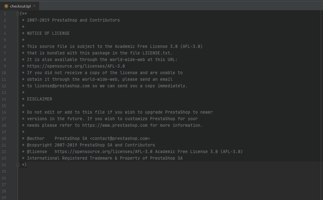

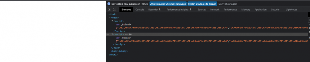

Julien Posted October 7, 2022 Share Posted October 7, 2022 Hi, I have a problem with a customer website. Someone found a way to insert custom script on the website checkout page to insert a fake paiement method to get cards numbers.. I already saw the post about the critical security vulnerability caused by SQL injection (https://www.nethues.com/blog/prestashop-1-7-8-7-security-vulnerability/) I didn't updated the website to the version 1.7.8 but I did the fix by removing the smarty configuration lines: if (Configuration::get('PS_SMARTY_CACHING_TYPE') == 'mysql') { include _PS_CLASS_DIR_.'Smarty/SmartyCacheResourceMysql.php'; $smarty->caching_type = 'mysql'; } I already find the script in my website directories (/js/1KUfS.js) wich contain code to insert the fake paiement method and send informations : (Code is blocked by the website, I put it on archive attach file but Avast alarm me about this file so be aware about it) I deleted it, but the script still being inserted (only on checkout page). I already deleted the cache, and try to find where the script is inserted but I cant find it.. When I delete the checkout.tpl file content, the script persist on <head> (even is the file dont have layout defined) : I really need help to find a solution.. I wish you can help me, Thanks in advance iKUfS.js Julien iKUfS.zip Link to comment Share on other sites More sharing options...
