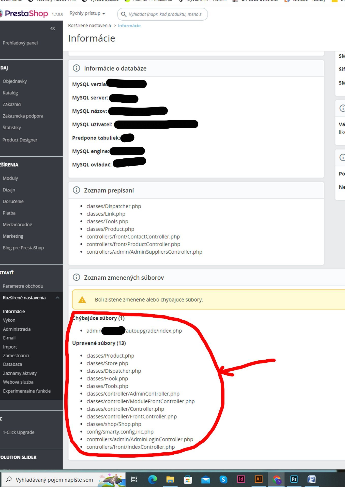

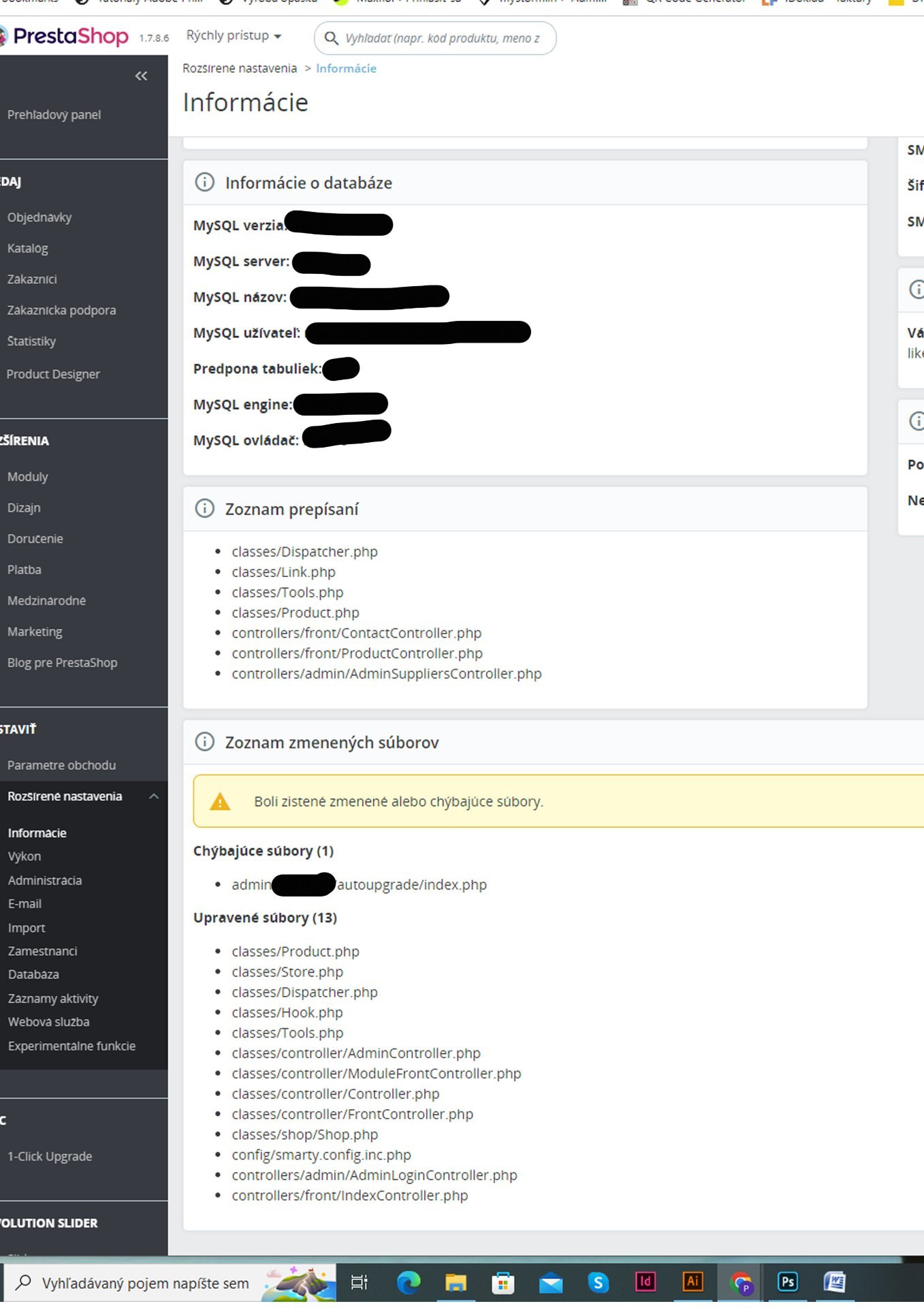

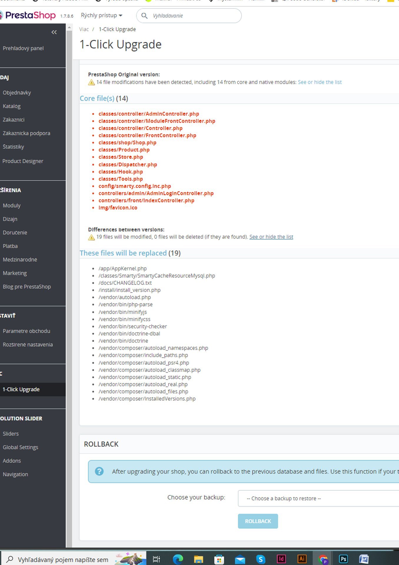

Maxflor Posted October 6, 2022 Share Posted October 6, 2022 Please, I have a problem with upgrading to a higher version of prestashop. I had a hacked e-shop, the hack should have been removed by now and I would like to upgrade to the latest version, but it throws me errors. I am attaching printscreen errors. Also, after logging out, I can't log into the backoffice again. I looked in the information about the page in the backoffice, it shows me changed and missing files, but I didn't delete anything. Does anyone have any advice on what to do with it? I am also attaching a printscreen. Thank you very much for your willingness to advise. Link to comment Share on other sites More sharing options...
ComGrafPL Posted October 6, 2022 Share Posted October 6, 2022 Hacked files was removed but not replaced. In affected files you had lines of code with the issues. So files then should have been replaced. Download clean 1.7.8.6 and replace that files and then try to upgrade. 1 Link to comment Share on other sites More sharing options...
Maxflor Posted October 6, 2022 Author Share Posted October 6, 2022 Thank you, I will try it, and do you mean all that are marked in the attachment? Link to comment Share on other sites More sharing options...
musicmaster Posted November 27, 2022 Share Posted November 27, 2022 Provided you didn't change files you can replace the following complete directories: classes, core, controllers, src, vendor and your admin directory. Just copy them from a fresh 1.7.8.6 installation. Link to comment Share on other sites More sharing options...
