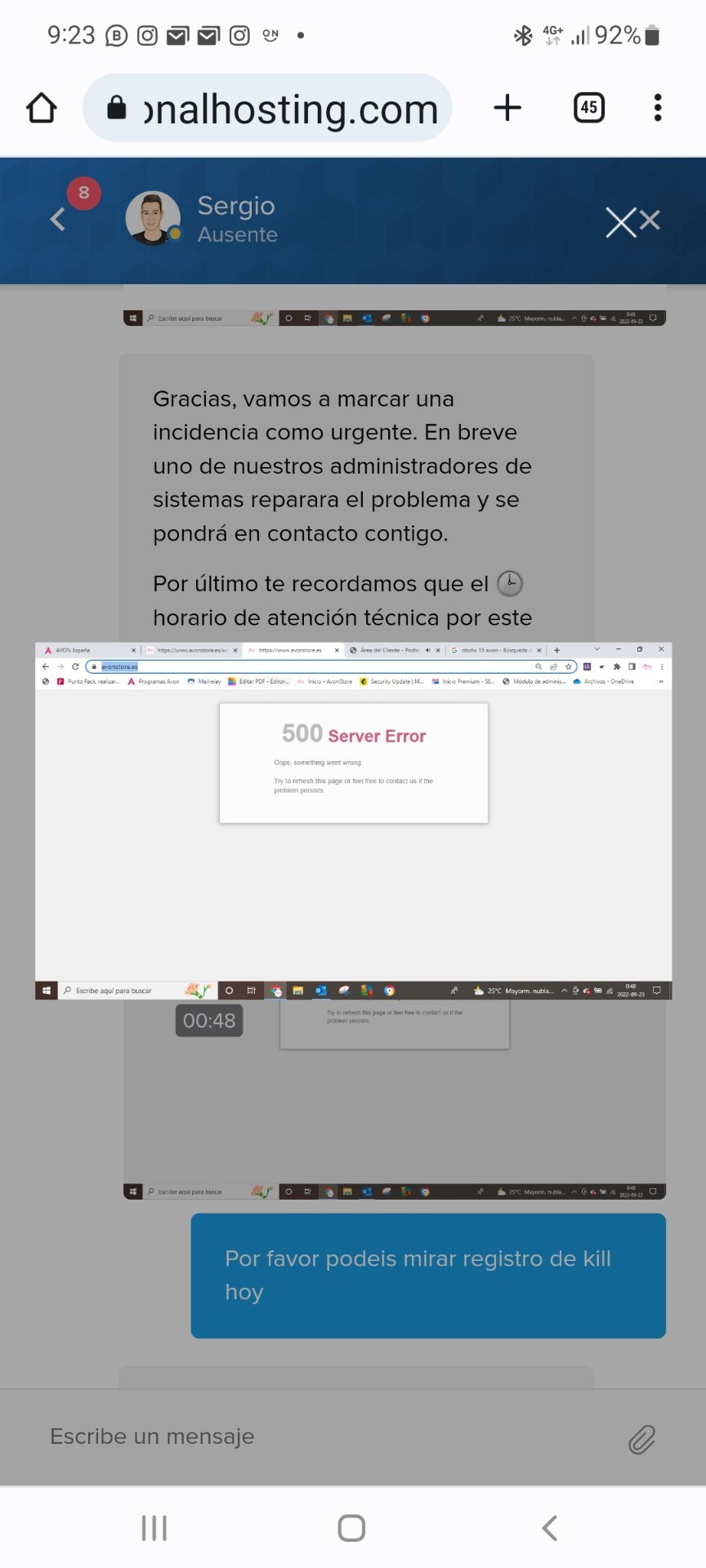

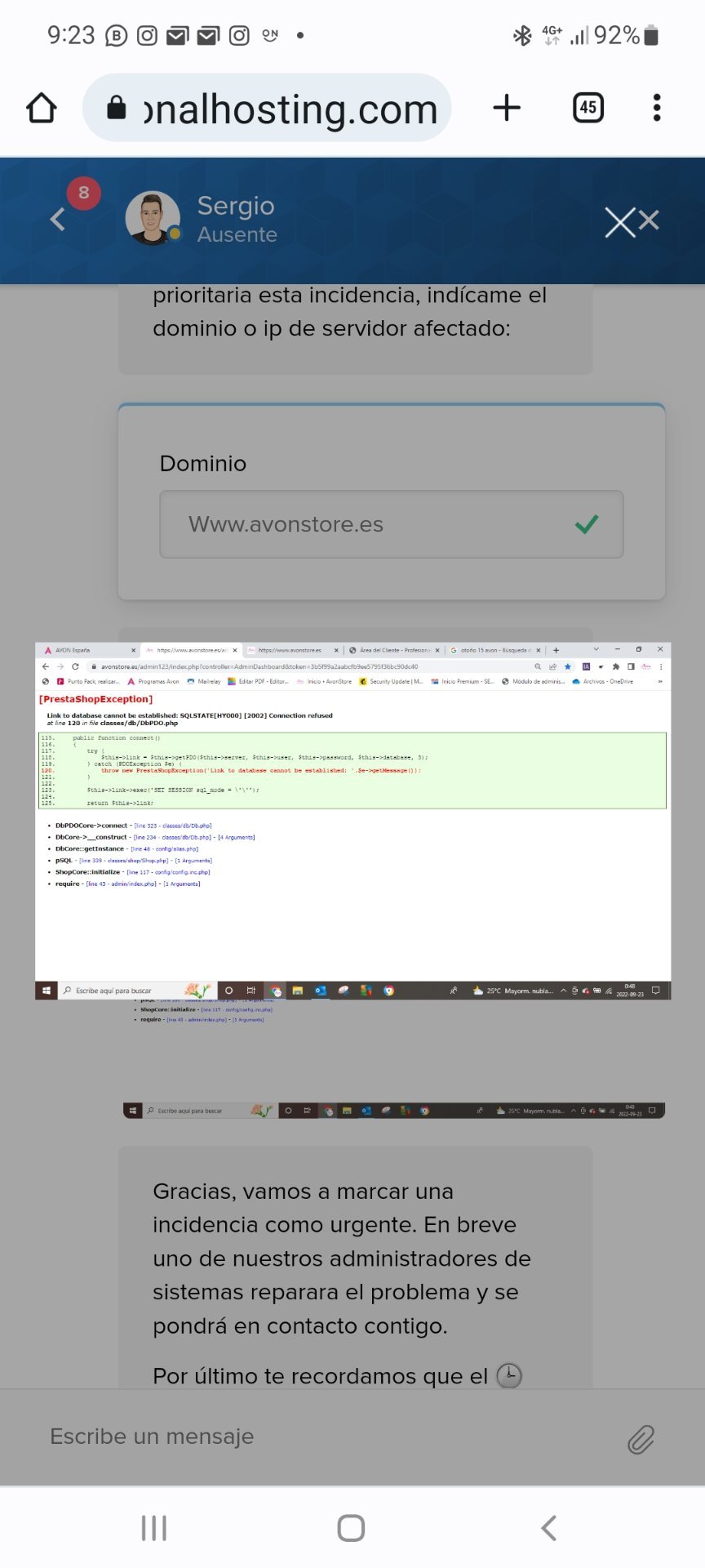

Lauraginergrao Posted September 23, 2022 Share Posted September 23, 2022 Hola a todos, espero que alguien me pueda ayudar... últimamente mi página se está quedando colgada con error 500. Ayer me mandaron esto desde atención al cliente de professional hosting que es lo que supuestamente da el error 500, tablas corruptas en mi web... 140473040017152 [ERROR] mysqld: Table './avonstor_pres287/pslm_cart' is marked as crashed and should be repaired 140473040017152 [Warning] Checking table: './avonstor_pres287/pslm_cart' 140473040017152 [ERROR] mysqld: Table './avonstor_pres287/pslm_orders' is marked as crashed and should be repaired 140473040017152 [Warning] Checking table: './avonstor_pres287/pslm_orders' 140473040017152 [ERROR] mysqld: Table './avonstor_pres287/pslm_cart_product' is marked as crashed and should be repaired 140473040017152 [ERROR] mysqld: Table './avonstor_pres287/pslm_cart_cart_rule' is marked as crashed and should be repaired 140473040017152 [Warning] Checking table: './avonstor_pres287/pslm_cart_cart_rule' 140473040017152 [ERROR] mysqld: Table './avonstor_pres287/pslm_pagenotfound' is marked as crashed and should be repaired 140473040017152 [Warning] Checking table: './avonstor_pres287/pslm_pagenotfound' ADJUNTO TAMBIEN CAPTURAS DEL ERROR 500 Y DE COMO SE VE EL ERROR EN EL BACK OFFICE. ¿Alguien sabría reparar esto? Gracias por vuestra ayuda. Link to comment Share on other sites More sharing options...
ComGrafPL Posted September 25, 2022 Share Posted September 25, 2022 Hola, Probablemente algo con base de datos. El error indica un problema de conexión a la base de datos. Verifique los detalles en la configuración de db y prestashop. Link to comment Share on other sites More sharing options...
