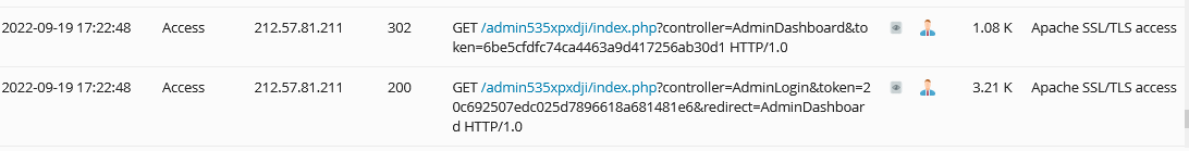

Marta Diaz Posted September 19, 2022 Share Posted September 19, 2022 Hi I have prestashop 1.7.7.0 php 7.3.33 Suddenly I cant login in backend. No errors; just loop of login page. I have tried many solutions as. clear cache, clear browser. Several browsers... also incognito I have tried: https://bobcares.com/blog/prestashop-admin-login-problem/ I´ve seen log of server: /admin535xpxdji/index.php?controller=AdminLogin&token=20c692507edc025d7896618a681481e6 cod 302 /admin535xpxdji/index.php?controller=AdminLogin&token=20c692507edc025d7896618a681481e6&redirect=AdminDashboard code 200 I have tried a new htaccess (basic) and the proble persist. I apreciate help Thank you Link to comment Share on other sites More sharing options...

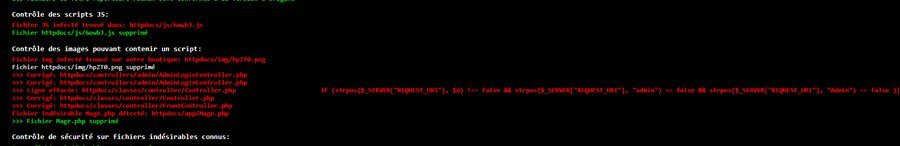

Mediacom87 Posted September 19, 2022 Share Posted September 19, 2022 It’s possible your site be hacked. first, put your site in maintenance mode. after that use eolia script like you canread in this article to check your site, don’t forget to make your full backup before. https://www.mediacom87.fr/en/how-to-prevent-hacking-on-prestashop-and-thirty-bees/ Link to comment Share on other sites More sharing options...
Marta Diaz Posted September 20, 2022 Author Share Posted September 20, 2022 Thanks a lot to Mediacom87. The site was hacked. I follow your instruction to clean the site with the script recommended in https://www.mediacom87.fr/en/how-to-prevent-hacking-on-prestashop-and-thirty-bees/ I cleaned with the script and I have uploaded three files of new installation of prestashop 1.7.7.0: FrontController.php, Controller.php, AdminLoginController.php You are great!!. Thank you very much Link to comment Share on other sites More sharing options...
Mediacom87 Posted September 20, 2022 Share Posted September 20, 2022 il y a 9 minutes, Marta Diaz a dit : I cleaned with the script and I have uploaded three files of new installation of prestashop 1.7.7.0: FrontController.php, Controller.php, AdminLoginController.php Remember, if you have cleaned up, you must now close all the doors to prevent it from happening again. Basically, you've done the easy part. Link to comment Share on other sites More sharing options...
