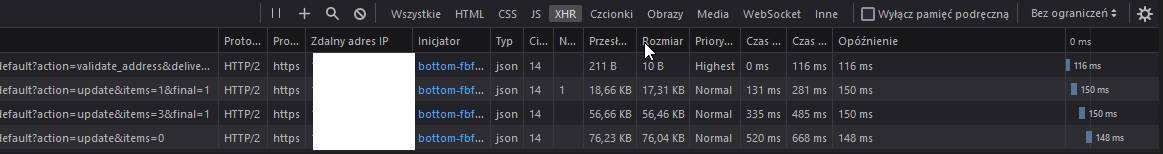

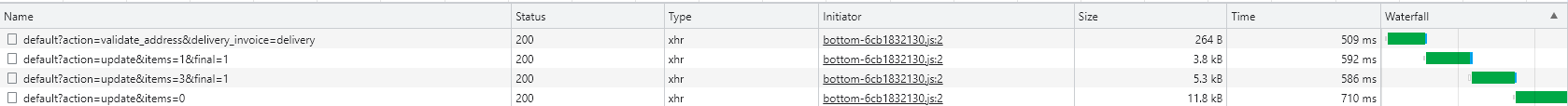

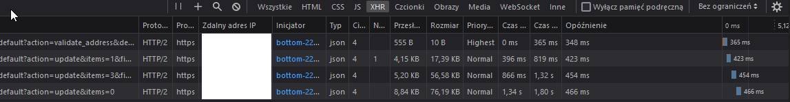

c64girl Posted September 15, 2022 Share Posted September 15, 2022 (edited) Hello i have a VPS that have 16GB ram 8 CORES and SSD drive php 8.4 and litespeed. I facing a very strange problem with executing scripts in basket remove, add to cart, next step in basket etc. But hosting that is 2x slower and have litespeed works like rocket. Is this a problem with configuration of server? Like firewall, modsecurity, security script checking problem? This is a copy of store 1/1 HOSTING VPS Edited September 15, 2022 by c64girl (see edit history) Link to comment Share on other sites More sharing options...

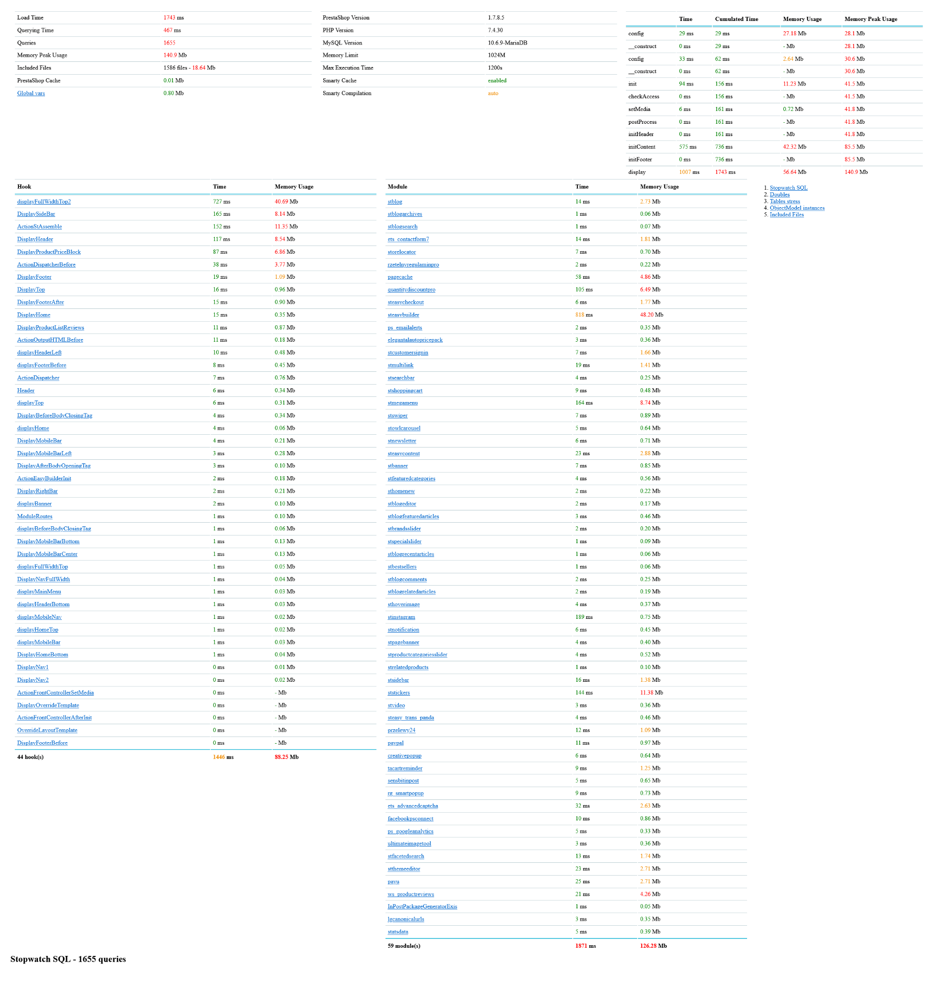

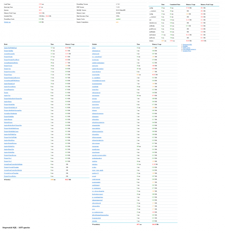

c64girl Posted September 15, 2022 Author Share Posted September 15, 2022 (edited) Here are clean prestashop on vps and on hosting HOSTING VPS Edited September 15, 2022 by c64girl (see edit history) Link to comment Share on other sites More sharing options...

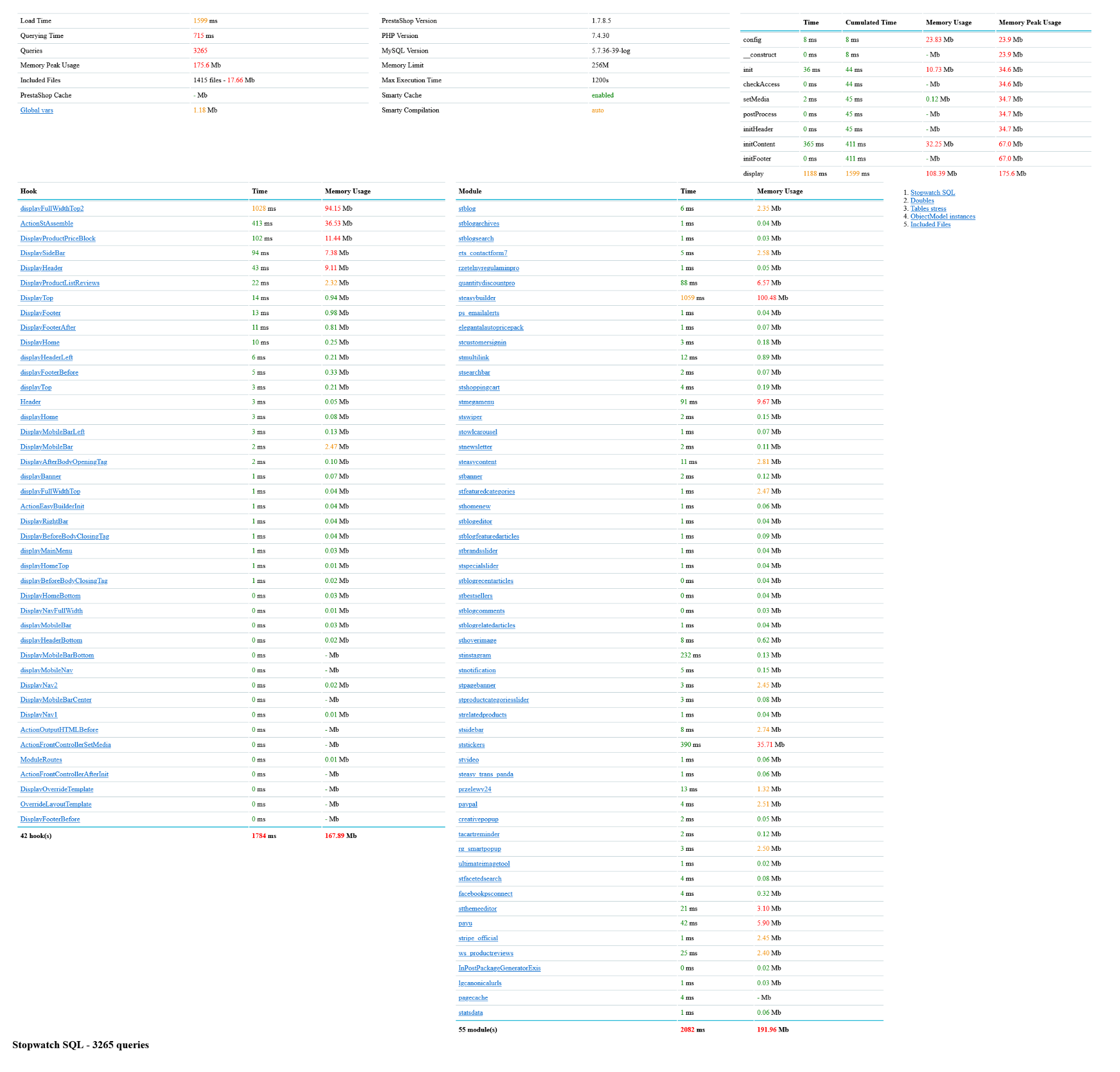

c64girl Posted September 19, 2022 Author Share Posted September 19, 2022 (edited) 18 hours ago, musicmaster said: Did you enable profiling and look whether certain queries caused the trouble? https://dh42.com/blog/prestashop-debug-profiling/ it seems hosting is getting more load but its not problem for him to execute the info with jquery/js Btw why in VPS this loaded 2x times? config29 ms29 ms27.18 Mb28.1 Mb __construct0 ms29 ms- Mb28.1 Mb config33 ms62 ms2.64 Mb30.6 Mb __construct0 ms62 ms- Mb30.6 Mb Hosting VPS Edited September 19, 2022 by c64girl (see edit history) Link to comment Share on other sites More sharing options...

musicmaster Posted September 19, 2022 Share Posted September 19, 2022 3265 queries is absolute madness. When I look at a basic shop it has 83 queries. So you should scroll further down and look which queries are run so often and from which modules they come.. Link to comment Share on other sites More sharing options...

c64girl Posted September 21, 2022 Author Share Posted September 21, 2022 (edited) On 9/20/2022 at 12:54 AM, Mediacom87 said: I think all troubles come from your template and precisely from the builder. On 9/19/2022 at 11:50 PM, musicmaster said: 3265 queries is absolute madness. When I look at a basic shop it has 83 queries. So you should scroll further down and look which queries are run so often and from which modules they come.. I use lementor, maybe thats why its getting so many queries Tables stress 513 category_lang 500 category 232 category_shop 194 quantity_discount_rule 193 quantity_discount_rule_lang 154 quantity_discount_rule_message 153 quantity_discount_rule_message_lang 109 category_group 73 product 69 product_shop 66 product_attribute_shop 63 module 61 module_shop 58 product_attribute 56 stock_available 55 currency 40 image 33 cart_product 32 image_lang 28 quantity_discount_rule_condition 28 product_lang 25 cms 25 specific_price 25 cms_shop 24 cms_lang 24 image_shop 24 ws_product_comment 24 pack 22 orders 16 st_mega_column 15 lang 14 st_mega_menu_lang 14 st_mega_menu 13 cart_rule 13 customer 11 hook 10 cart_rule_lang 9 st_sticker_shop 9 st_easy_builder_yuyan 9 st_sticker_lang 9 st_sticker 9 st_easy_builder_postmeta 8 attribute_group_lang 8 product_attribute_combination 8 attribute_lang 8 attribute 8 feature_shop 8 feature 8 feature_value_lang 8 category_product 8 feature_product 8 product_tag 8 tag 8 product_group_reduction_cache 8 specific_price_priority 8 feature_lang 8 quantity_discount_rule_family 8 st_sticker_map 8 product_attribute_image 8 tax_rules_group 7 tax_rule 6 shop 6 quantity_discount_rule_order 6 order_cart_rule 6 image_type 5 ets_ctf_contact 5 st_easy_content_setting 5 country 5 country_lang 5 meta 5 meta_lang 5 st_multi_link_lang 5 st_easy_builder_shop 5 st_easy_builder 5 st_multi_link 5 ets_ctf_contact_shop 5 shop_url 5 address 5 ets_ctf_contact_lang 5 currency_shop 4 st_easy_content_column 4 lang_shop 4 quantity_discount_rule_action 4 tax_lang 4 tax 4 group_shop 3 group 3 currency_lang 3 st_blog_lang 3 st_blog_shop 3 hook_alias 3 hook_module 3 country_shop 3 quantity_discount_rule_group 3 st_blog_category_lang 3 st_blog_category 3 st_blog 2 quantity_discount_rule_action_product 2 quantity_discount_rule_condition_currency 2 jm_pagecache 2 st_easy_content_element 2 rg_smartpopup_popup_shop 2 shop_group 2 fbpsc_connector_position 2 module_group 2 manufacturer 2 customer_group 2 configuration 2 st_notification 2 rg_smartpopup_popup 2 st_notification_shop 2 st_notification_lang 2 st_sidebar 2 st_sidebar_shop 2 st_sidebar_lang 2 group_lang 2 state 1 customer_session 1 cart 1 hook_module_exceptions 1 configuration_lang 1 supplier 1 st_news_letter 1 st_news_letter_shop 1 st_news_letter_lang 1 guest 1 st_multi_link_group_shop 1 operating_system 1 web_browser 1 connections 1 page_type 1 page 1 jm_pagecache_mods 1 st_multi_link_group_lang 1 quantity_discount_rule_condition_product 1 st_multi_link_group 1 store_shop 1 multi_specific_price 1 st_blog_image_lang 1 st_blog_image 1 st_blog_comment 1 st_easy_content_lang 1 st_easy_content_shop 1 st_easy_content 1 store_lang 1 store 1 ganalytics_data 1 creativepopup_revisions 1 st_instagram_bind 1 required_field 1 address_format 1 manufacturer_shop 1 multi_specific_price_categories 1 jm_pagecache_details 1 tax_rules_group_shop 1 jm_pagecache_sp 1 jm_pagecache_bl ObjectModel instances Name Instances Source Category 292 /modules/ststickers/classes/StStickersMapClass.php [159] /modules/ststickers/classes/StStickersMapClass.php [168] /modules/ststickers/classes/StStickersMapClass.php [159] /modules/ststickers/classes/StStickersMapClass.php [168] /modules/ststickers/classes/StStickersMapClass.php [159] /modules/ststickers/classes/StStickersMapClass.php [168] /modules/ststickers/classes/StStickersMapClass.php [159] /modules/ststickers/classes/StStickersMapClass.php [168] /modules/ststickers/classes/StStickersMapClass.php [159] /modules/ststickers/classes/StStickersMapClass.php [168] /modules/ststickers/classes/StStickersMapClass.php [159] /modules/ststickers/classes/StStickersMapClass.php [168] /modules/ststickers/classes/StStickersMapClass.php [159] /modules/ststickers/classes/StStickersMapClass.php [168] /modules/ststickers/classes/StStickersMapClass.php [159] /modules/ststickers/classes/StStickersMapClass.php [168] /modules/ststickers/classes/StStickersMapClass.php [159] /modules/ststickers/classes/StStickersMapClass.php [168] /modules/ststickers/classes/StStickersMapClass.php [159] /modules/ststickers/classes/StStickersMapClass.php [168] /modules/ststickers/classes/StStickersMapClass.php [159] /modules/ststickers/classes/StStickersMapClass.php [168] /modules/ststickers/classes/StStickersMapClass.php [159] /modules/ststickers/classes/StStickersMapClass.php [168] /modules/ststickers/classes/StStickersMapClass.php [159] /modules/ststickers/classes/StStickersMapClass.php [168] /modules/ststickers/classes/StStickersMapClass.php [159] /modules/ststickers/classes/StStickersMapClass.php [168] /modules/ststickers/classes/StStickersMapClass.php [159] /modules/ststickers/classes/StStickersMapClass.php [168] /modules/ststickers/classes/StStickersMapClass.php [159] /modules/ststickers/classes/StStickersMapClass.php [168] /modules/ststickers/classes/StStickersMapClass.php [159] /modules/ststickers/classes/StStickersMapClass.php [168] /modules/ststickers/classes/StStickersMapClass.php [159] /modules/ststickers/classes/StStickersMapClass.php [168] /modules/ststickers/classes/StStickersMapClass.php [159] /modules/ststickers/classes/StStickersMapClass.php [168] /modules/ststickers/classes/StStickersMapClass.php [159] /modules/ststickers/classes/StStickersMapClass.php [159] /modules/ststickers/classes/StStickersMapClass.php [168] /modules/ststickers/classes/StStickersMapClass.php [159] /modules/ststickers/classes/StStickersMapClass.php [168] /modules/ststickers/classes/StStickersMapClass.php [159] /modules/ststickers/classes/StStickersMapClass.php [168] /modules/ststickers/classes/StStickersMapClass.php [159] /modules/ststickers/classes/StStickersMapClass.php [168] /modules/ststickers/classes/StStickersMapClass.php [159] /modules/ststickers/classes/StStickersMapClass.php [168] /modules/ststickers/classes/StStickersMapClass.php [159] /modules/ststickers/classes/StStickersMapClass.php [168] /modules/ststickers/classes/StStickersMapClass.php [159] /modules/ststickers/classes/StStickersMapClass.php [168] /modules/ststickers/classes/StStickersMapClass.php [159] /modules/ststickers/classes/StStickersMapClass.php [168] /modules/ststickers/classes/StStickersMapClass.php [159] /modules/ststickers/classes/StStickersMapClass.php [168] /modules/ststickers/classes/StStickersMapClass.php [159] /modules/ststickers/classes/StStickersMapClass.php [168] /modules/ststickers/classes/StStickersMapClass.php [159] /modules/ststickers/classes/StStickersMapClass.php [168] /modules/ststickers/classes/StStickersMapClass.php [159] /modules/ststickers/classes/StStickersMapClass.php [168] /modules/ststickers/classes/StStickersMapClass.php [159] /modules/ststickers/classes/StStickersMapClass.php [168] /modules/ststickers/classes/StStickersMapClass.php [159] /modules/ststickers/classes/StStickersMapClass.php [168] /modules/ststickers/classes/StStickersMapClass.php [159] /modules/ststickers/classes/StStickersMapClass.php [168] /modules/ststickers/classes/StStickersMapClass.php [159] /modules/ststickers/classes/StStickersMapClass.php [168] /modules/ststickers/classes/StStickersMapClass.php [159] /modules/ststickers/classes/StStickersMapClass.php [168] /modules/ststickers/classes/StStickersMapClass.php [159] /modules/ststickers/classes/StStickersMapClass.php [168] /modules/ststickers/classes/StStickersMapClass.php [159] /modules/ststickers/classes/StStickersMapClass.php [168] /modules/ststickers/classes/StStickersMapClass.php [159] /modules/ststickers/classes/StStickersMapClass.php [168] /modules/ststickers/classes/StStickersMapClass.php [159] /modules/ststickers/classes/StStickersMapClass.php [168] /modules/ststickers/classes/StStickersMapClass.php [159] /modules/ststickers/classes/StStickersMapClass.php [168] /modules/ststickers/classes/StStickersMapClass.php [159] /modules/ststickers/classes/StStickersMapClass.php [168] /modules/ststickers/classes/StStickersMapClass.php [159] /modules/ststickers/classes/StStickersMapClass.php [168] /modules/ststickers/classes/StStickersMapClass.php [159] /modules/ststickers/classes/StStickersMapClass.php [168] /modules/ststickers/classes/StStickersMapClass.php [159] /modules/ststickers/classes/StStickersMapClass.php [168] /modules/ststickers/classes/StStickersMapClass.php [159] /modules/ststickers/classes/StStickersMapClass.php [159] /modules/ststickers/classes/StStickersMapClass.php [168] /modules/ststickers/classes/StStickersMapClass.php [159] /modules/ststickers/classes/StStickersMapClass.php [168] /modules/ststickers/classes/StStickersMapClass.php [159] /modules/ststickers/classes/StStickersMapClass.php [168] /modules/ststickers/classes/StStickersMapClass.php [159] /modules/ststickers/classes/StStickersMapClass.php [168] /modules/ststickers/classes/StStickersMapClass.php [159] /modules/ststickers/classes/StStickersMapClass.php [168] /modules/ststickers/classes/StStickersMapClass.php [159] /modules/ststickers/classes/StStickersMapClass.php [168] /modules/ststickers/classes/StStickersMapClass.php [159] /modules/ststickers/classes/StStickersMapClass.php [168] /modules/ststickers/classes/StStickersMapClass.php [159] /modules/ststickers/classes/StStickersMapClass.php [168] /modules/ststickers/classes/StStickersMapClass.php [159] /modules/ststickers/classes/StStickersMapClass.php [168] /modules/ststickers/classes/StStickersMapClass.php [159] /modules/ststickers/classes/StStickersMapClass.php [168] /modules/ststickers/classes/StStickersMapClass.php [159] /modules/ststickers/classes/StStickersMapClass.php [168] /modules/ststickers/classes/StStickersMapClass.php [159] /modules/ststickers/classes/StStickersMapClass.php [168] /modules/ststickers/classes/StStickersMapClass.php [159] /modules/ststickers/classes/StStickersMapClass.php [168] /modules/ststickers/classes/StStickersMapClass.php [159] /modules/ststickers/classes/StStickersMapClass.php [168] /modules/ststickers/classes/StStickersMapClass.php [159] /modules/ststickers/classes/StStickersMapClass.php [168] /modules/ststickers/classes/StStickersMapClass.php [159] /modules/ststickers/classes/StStickersMapClass.php [168] /modules/ststickers/classes/StStickersMapClass.php [159] /modules/ststickers/classes/StStickersMapClass.php [168] /modules/ststickers/classes/StStickersMapClass.php [159] /modules/ststickers/classes/StStickersMapClass.php [168] /modules/ststickers/classes/StStickersMapClass.php [159] /modules/ststickers/classes/StStickersMapClass.php [168] /modules/ststickers/classes/StStickersMapClass.php [159] /modules/ststickers/classes/StStickersMapClass.php [168] /modules/ststickers/classes/StStickersMapClass.php [159] /modules/ststickers/classes/StStickersMapClass.php [168] /modules/ststickers/classes/StStickersMapClass.php [159] /modules/ststickers/classes/StStickersMapClass.php [168] /modules/ststickers/classes/StStickersMapClass.php [159] /modules/ststickers/classes/StStickersMapClass.php [168] /modules/ststickers/classes/StStickersMapClass.php [159] /modules/ststickers/classes/StStickersMapClass.php [168] /modules/ststickers/classes/StStickersMapClass.php [159] /modules/ststickers/classes/StStickersMapClass.php [168] /modules/ststickers/classes/StStickersMapClass.php [159] /modules/ststickers/classes/StStickersMapClass.php [159] /modules/ststickers/classes/StStickersMapClass.php [168] /modules/ststickers/classes/StStickersMapClass.php [159] /modules/ststickers/classes/StStickersMapClass.php [168] /modules/ststickers/classes/StStickersMapClass.php [159] /modules/ststickers/classes/StStickersMapClass.php [168] /modules/ststickers/classes/StStickersMapClass.php [159] /modules/ststickers/classes/StStickersMapClass.php [159] /modules/ststickers/classes/StStickersMapClass.php [168] /modules/ststickers/classes/StStickersMapClass.php [159] /modules/ststickers/classes/StStickersMapClass.php [168] /modules/ststickers/classes/StStickersMapClass.php [159] /modules/ststickers/classes/StStickersMapClass.php [168] /modules/ststickers/classes/StStickersMapClass.php [159] /modules/ststickers/classes/StStickersMapClass.php [168] /modules/ststickers/classes/StStickersMapClass.php [159] /modules/ststickers/classes/StStickersMapClass.php [168] /modules/ststickers/classes/StStickersMapClass.php [159] /modules/ststickers/classes/StStickersMapClass.php [168] /modules/ststickers/classes/StStickersMapClass.php [159] /modules/ststickers/classes/StStickersMapClass.php [168] /modules/ststickers/classes/StStickersMapClass.php [159] /modules/ststickers/classes/StStickersMapClass.php [159] /modules/ststickers/classes/StStickersMapClass.php [168] /modules/ststickers/classes/StStickersMapClass.php [159] /modules/ststickers/classes/StStickersMapClass.php [168] /modules/ststickers/classes/StStickersMapClass.php [159] /modules/ststickers/classes/StStickersMapClass.php [168] /modules/ststickers/classes/StStickersMapClass.php [159] /modules/ststickers/classes/StStickersMapClass.php [168] /modules/ststickers/classes/StStickersMapClass.php [159] /modules/ststickers/classes/StStickersMapClass.php [168] /modules/ststickers/classes/StStickersMapClass.php [159] /modules/ststickers/classes/StStickersMapClass.php [168] /modules/ststickers/classes/StStickersMapClass.php [159] /modules/ststickers/classes/StStickersMapClass.php [168] /modules/ststickers/classes/StStickersMapClass.php [159] /modules/ststickers/classes/StStickersMapClass.php [168] /modules/ststickers/classes/StStickersMapClass.php [159] /modules/ststickers/classes/StStickersMapClass.php [168] /modules/stmegamenu/stmegamenu.php [4251] /modules/stmegamenu/stmegamenu.php [4251] /modules/stmegamenu/stmegamenu.php [3927] /modules/stmegamenu/stmegamenu.php [3931] /modules/stmegamenu/stmegamenu.php [3931] /modules/stmegamenu/stmegamenu.php [3931] /modules/stmegamenu/stmegamenu.php [3931] /modules/stmegamenu/stmegamenu.php [3931] /modules/stmegamenu/stmegamenu.php [3931] /modules/stmegamenu/stmegamenu.php [4251] /modules/stmegamenu/stmegamenu.php [3927] /modules/stmegamenu/stmegamenu.php [3931] /modules/stmegamenu/stmegamenu.php [3931] /modules/stmegamenu/stmegamenu.php [3931] /modules/stmegamenu/stmegamenu.php [3931] /modules/stmegamenu/stmegamenu.php [3931] /modules/stmegamenu/stmegamenu.php [3931] /modules/stmegamenu/stmegamenu.php [3931] /modules/stmegamenu/stmegamenu.php [3931] /modules/stmegamenu/stmegamenu.php [3931] /modules/stmegamenu/stmegamenu.php [4251] /modules/stmegamenu/stmegamenu.php [3927] /modules/stmegamenu/stmegamenu.php [3931] /modules/stmegamenu/stmegamenu.php [3931] /modules/stmegamenu/stmegamenu.php [4251] /modules/stmegamenu/stmegamenu.php [3927] /modules/stmegamenu/stmegamenu.php [3931] /modules/stmegamenu/stmegamenu.php [3931] /modules/stmegamenu/stmegamenu.php [3931] /modules/stmegamenu/stmegamenu.php [3931] /modules/stmegamenu/stmegamenu.php [3931] /modules/stmegamenu/stmegamenu.php [3931] /modules/stmegamenu/stmegamenu.php [3931] /modules/stmegamenu/stmegamenu.php [4251] /modules/stmegamenu/stmegamenu.php [3927] /modules/stmegamenu/stmegamenu.php [3931] /modules/stmegamenu/stmegamenu.php [3931] /modules/stmegamenu/stmegamenu.php [3931] /modules/stmegamenu/stmegamenu.php [3931] /modules/stmegamenu/stmegamenu.php [3931] /modules/stmegamenu/stmegamenu.php [3931] /modules/stmegamenu/stmegamenu.php [3931] /modules/stmegamenu/stmegamenu.php [4251] /modules/stmegamenu/stmegamenu.php [3927] /modules/stmegamenu/stmegamenu.php [3931] /modules/stmegamenu/stmegamenu.php [3931] /modules/stmegamenu/stmegamenu.php [3931] /modules/stmegamenu/stmegamenu.php [3931] /modules/stmegamenu/stmegamenu.php [3931] /modules/stmegamenu/stmegamenu.php [3931] /modules/stmegamenu/stmegamenu.php [3931] /modules/stmegamenu/stmegamenu.php [4251] /modules/stmegamenu/stmegamenu.php [3927] /modules/stmegamenu/stmegamenu.php [3931] /modules/stmegamenu/stmegamenu.php [3931] /modules/stmegamenu/stmegamenu.php [3931] /modules/stmegamenu/stmegamenu.php [3931] /modules/stmegamenu/stmegamenu.php [3931] /modules/stmegamenu/stmegamenu.php [4251] /modules/stmegamenu/stmegamenu.php [3927] /modules/stmegamenu/stmegamenu.php [3931] /modules/stmegamenu/stmegamenu.php [3931] /modules/stmegamenu/stmegamenu.php [3931] /modules/stmegamenu/stmegamenu.php [3931] /modules/stmegamenu/stmegamenu.php [4251] /modules/stmegamenu/stmegamenu.php [3927] /modules/stmegamenu/stmegamenu.php [3931] /modules/stmegamenu/stmegamenu.php [3931] /modules/stmegamenu/stmegamenu.php [3931] /modules/stmegamenu/stmegamenu.php [4251] /modules/stmegamenu/stmegamenu.php [3927] /modules/stmegamenu/stmegamenu.php [3931] /modules/stmegamenu/stmegamenu.php [3931] /modules/stmegamenu/stmegamenu.php [3931] /modules/stmegamenu/stmegamenu.php [3931] /modules/stmegamenu/stmegamenu.php [4251] /modules/stmegamenu/stmegamenu.php [3927] /modules/stmegamenu/stmegamenu.php [3931] /modules/stmegamenu/stmegamenu.php [3931] /modules/stmegamenu/stmegamenu.php [3931] /modules/stmegamenu/stmegamenu.php [3931] /modules/stmegamenu/stmegamenu.php [3931] /modules/stmegamenu/stmegamenu.php [3931] /modules/stmegamenu/stmegamenu.php [3931] /modules/stmegamenu/stmegamenu.php [4251] /modules/stmegamenu/stmegamenu.php [3927] /modules/stmegamenu/stmegamenu.php [3931] /modules/stmegamenu/stmegamenu.php [3931] /modules/stmegamenu/stmegamenu.php [3931] /modules/stmegamenu/stmegamenu.php [3931] /modules/stmegamenu/stmegamenu.php [4251] /modules/stmegamenu/stmegamenu.php [3927] /modules/stmegamenu/stmegamenu.php [3931] /modules/stmegamenu/stmegamenu.php [3931] /modules/stmegamenu/stmegamenu.php [3931] /modules/stmegamenu/stmegamenu.php [3931] /modules/stmegamenu/stmegamenu.php [3931] /modules/stmegamenu/stmegamenu.php [3931] /modules/stmegamenu/stmegamenu.php [3931] /modules/stmegamenu/stmegamenu.php [3931] /modules/stmegamenu/stmegamenu.php [3931] /modules/stmegamenu/stmegamenu.php [3931] /modules/stmegamenu/stmegamenu.php [3931] /modules/stmegamenu/stmegamenu.php [3931] /modules/stmegamenu/stmegamenu.php [3931] /modules/stmegamenu/stmegamenu.php [3931] /modules/stmegamenu/stmegamenu.php [3931] /modules/stmegamenu/stmegamenu.php [3931] /modules/stmegamenu/stmegamenu.php [3931] Product 72 /modules/steasy_trans_panda/classes/EasyBuilderProductBase.php [995] /classes/Link.php [114] /modules/ststickers/classes/StStickersMapClass.php [152] /src/Adapter/Image/ImageRetriever.php [66] /modules/steasy_trans_panda/classes/EasyBuilderProductBase.php [995] /classes/Link.php [114] /modules/ststickers/classes/StStickersMapClass.php [152] /src/Adapter/Image/ImageRetriever.php [66] /modules/steasy_trans_panda/classes/EasyBuilderProductBase.php [995] /classes/Link.php [114] /modules/ststickers/classes/StStickersMapClass.php [152] /src/Adapter/Image/ImageRetriever.php [66] /modules/steasy_trans_panda/classes/EasyBuilderProductBase.php [995] /classes/Link.php [114] /modules/ststickers/classes/StStickersMapClass.php [152] /src/Adapter/Image/ImageRetriever.php [66] /classes/Link.php [114] /modules/przelewy24/przelewy24.php [840] /modules/quantitydiscountpro/classes/QuantityDiscountRule.php [5684] /modules/quantitydiscountpro/classes/QuantityDiscountRule.php [5684] /modules/quantitydiscountpro/classes/QuantityDiscountRule.php [5684] /classes/Link.php [114] /modules/przelewy24/przelewy24.php [840] /modules/quantitydiscountpro/classes/QuantityDiscountRule.php [5684] /modules/quantitydiscountpro/classes/QuantityDiscountRule.php [5684] /modules/quantitydiscountpro/classes/QuantityDiscountRule.php [5684] /classes/Link.php [114] /modules/przelewy24/przelewy24.php [840] /modules/quantitydiscountpro/classes/QuantityDiscountRule.php [5684] /modules/quantitydiscountpro/classes/QuantityDiscountRule.php [5684] /modules/quantitydiscountpro/classes/QuantityDiscountRule.php [5684] /classes/Link.php [114] /modules/przelewy24/przelewy24.php [840] /modules/quantitydiscountpro/classes/QuantityDiscountRule.php [5684] /modules/quantitydiscountpro/classes/QuantityDiscountRule.php [5684] /modules/quantitydiscountpro/classes/QuantityDiscountRule.php [5684] /modules/steasy_trans_panda/classes/EasyBuilderProductBase.php [995] /classes/Link.php [114] /modules/ststickers/classes/StStickersMapClass.php [152] /src/Adapter/Image/ImageRetriever.php [66] /modules/steasy_trans_panda/classes/EasyBuilderProductBase.php [995] /classes/Link.php [114] /modules/ststickers/classes/StStickersMapClass.php [152] /src/Adapter/Image/ImageRetriever.php [66] /modules/steasy_trans_panda/classes/EasyBuilderProductBase.php [995] /classes/Link.php [114] /modules/ststickers/classes/StStickersMapClass.php [152] /src/Adapter/Image/ImageRetriever.php [66] /modules/steasy_trans_panda/classes/EasyBuilderProductBase.php [995] /classes/Link.php [114] /modules/ststickers/classes/StStickersMapClass.php [152] /src/Adapter/Image/ImageRetriever.php [66] /classes/Link.php [114] /modules/przelewy24/przelewy24.php [840] /modules/quantitydiscountpro/classes/QuantityDiscountRule.php [5684] /modules/quantitydiscountpro/classes/QuantityDiscountRule.php [5684] /modules/quantitydiscountpro/classes/QuantityDiscountRule.php [5684] /classes/Link.php [114] /modules/przelewy24/przelewy24.php [840] /modules/quantitydiscountpro/classes/QuantityDiscountRule.php [5684] /modules/quantitydiscountpro/classes/QuantityDiscountRule.php [5684] /modules/quantitydiscountpro/classes/QuantityDiscountRule.php [5684] /classes/Link.php [114] /modules/przelewy24/przelewy24.php [840] /modules/quantitydiscountpro/classes/QuantityDiscountRule.php [5684] /modules/quantitydiscountpro/classes/QuantityDiscountRule.php [5684] /modules/quantitydiscountpro/classes/QuantityDiscountRule.php [5684] /classes/Link.php [114] /modules/przelewy24/przelewy24.php [840] /modules/quantitydiscountpro/classes/QuantityDiscountRule.php [5684] /modules/quantitydiscountpro/classes/QuantityDiscountRule.php [5684] /modules/quantitydiscountpro/classes/QuantityDiscountRule.php [5684] QuantityDiscountRule 32 /override/classes/CartRule.php [47] /override/classes/CartRule.php [107] /override/classes/CartRule.php [107] /override/classes/CartRule.php [107] /modules/quantitydiscountpro/quantitydiscountpro.php [759] /modules/quantitydiscountpro/quantitydiscountpro.php [759] /modules/quantitydiscountpro/quantitydiscountpro.php [759] /modules/quantitydiscountpro/quantitydiscountpro.php [774] /modules/quantitydiscountpro/quantitydiscountpro.php [774] /modules/quantitydiscountpro/quantitydiscountpro.php [774] /modules/quantitydiscountpro/quantitydiscountpro.php [774] /modules/quantitydiscountpro/quantitydiscountpro.php [774] /modules/quantitydiscountpro/quantitydiscountpro.php [774] /modules/quantitydiscountpro/quantitydiscountpro.php [774] /modules/quantitydiscountpro/quantitydiscountpro.php [774] /modules/quantitydiscountpro/quantitydiscountpro.php [774] /modules/quantitydiscountpro/quantitydiscountpro.php [774] /modules/quantitydiscountpro/quantitydiscountpro.php [774] /modules/quantitydiscountpro/quantitydiscountpro.php [774] /modules/quantitydiscountpro/quantitydiscountpro.php [774] /modules/quantitydiscountpro/quantitydiscountpro.php [774] /modules/quantitydiscountpro/quantitydiscountpro.php [774] /modules/quantitydiscountpro/quantitydiscountpro.php [774] /modules/quantitydiscountpro/quantitydiscountpro.php [774] /modules/quantitydiscountpro/quantitydiscountpro.php [774] /modules/quantitydiscountpro/quantitydiscountpro.php [774] /modules/quantitydiscountpro/quantitydiscountpro.php [774] /modules/quantitydiscountpro/quantitydiscountpro.php [774] /modules/quantitydiscountpro/quantitydiscountpro.php [774] /modules/quantitydiscountpro/quantitydiscountpro.php [774] /modules/quantitydiscountpro/quantitydiscountpro.php [774] /override/classes/CartRule.php [107] QuantityDiscountRuleCondition 24 /modules/quantitydiscountpro/classes/QuantityDiscountRule.php [4624] /modules/quantitydiscountpro/classes/QuantityDiscountRule.php [4624] /modules/quantitydiscountpro/classes/QuantityDiscountRule.php [4624] /modules/quantitydiscountpro/classes/QuantityDiscountRule.php [4624] /modules/quantitydiscountpro/classes/QuantityDiscountRule.php [4624] /modules/quantitydiscountpro/classes/QuantityDiscountRule.php [4624] /modules/quantitydiscountpro/classes/QuantityDiscountRule.php [4624] /modules/quantitydiscountpro/classes/QuantityDiscountRule.php [4624] /modules/quantitydiscountpro/classes/QuantityDiscountRule.php [4624] /modules/quantitydiscountpro/classes/QuantityDiscountRule.php [4624] /modules/quantitydiscountpro/classes/QuantityDiscountRule.php [4624] /modules/quantitydiscountpro/classes/QuantityDiscountRule.php [4624] /modules/quantitydiscountpro/classes/QuantityDiscountRule.php [4624] /modules/quantitydiscountpro/classes/QuantityDiscountRule.php [4624] /modules/quantitydiscountpro/classes/QuantityDiscountRule.php [4624] /modules/quantitydiscountpro/classes/QuantityDiscountRule.php [4624] /modules/quantitydiscountpro/classes/QuantityDiscountRule.php [4624] /modules/quantitydiscountpro/classes/QuantityDiscountRule.php [4624] /modules/quantitydiscountpro/classes/QuantityDiscountRule.php [4624] /modules/quantitydiscountpro/classes/QuantityDiscountRule.php [4624] /modules/quantitydiscountpro/classes/QuantityDiscountRule.php [4624] /modules/quantitydiscountpro/classes/QuantityDiscountRule.php [4624] /modules/quantitydiscountpro/classes/QuantityDiscountRule.php [4624] /modules/quantitydiscountpro/classes/QuantityDiscountRule.php [4624] Address 12 /modules/pagecache/pagecache.php [3107] /classes/shop/Shop.php [469] /classes/Product.php [733] /classes/Product.php [3762] /classes/Product.php [5840] /classes/Product.php [733] /classes/Product.php [733] /classes/Product.php [733] /classes/Product.php [733] /classes/Product.php [733] /classes/Product.php [733] /classes/Product.php [733] Language 10 /config/config.inc.php [222] /classes/Tools.php [658] /classes/Tools.php [581] /classes/Tools.php [581] /modules/steasycontent/classes/StEasyContentSettingClass.php [78] /modules/steasycontent/classes/StEasyContentSettingClass.php [78] /modules/steasycontent/classes/StEasyContentSettingClass.php [78] /modules/steasycontent/classes/StEasyContentSettingClass.php [78] /modules/steasycontent/classes/StEasyContentSettingClass.php [78] /classes/Tools.php [581] Customer 9 /config/config.inc.php [236] /classes/Product.php [848] /classes/Product.php [848] /classes/Product.php [848] /classes/Product.php [848] /classes/Product.php [848] /classes/Product.php [848] /classes/Product.php [848] /classes/Product.php [848] Combination 8 /classes/Product.php [5802] /classes/Product.php [5802] /classes/Product.php [5802] /classes/Product.php [5802] /classes/Product.php [5802] /classes/Product.php [5802] /classes/Product.php [5802] /classes/Product.php [5802] QuantityDiscountRuleMessage 8 /modules/quantitydiscountpro/quantitydiscountpro.php [779] /modules/quantitydiscountpro/quantitydiscountpro.php [779] /modules/quantitydiscountpro/quantitydiscountpro.php [779] /modules/quantitydiscountpro/quantitydiscountpro.php [779] /modules/quantitydiscountpro/quantitydiscountpro.php [779] /modules/quantitydiscountpro/quantitydiscountpro.php [779] /modules/quantitydiscountpro/quantitydiscountpro.php [779] /modules/quantitydiscountpro/quantitydiscountpro.php [779] Country 8 /config/config.inc.php [157] /modules/pagecache/pagecache.php [3120] /classes/controller/FrontController.php [478] /classes/AddressFormat.php [404] /classes/controller/FrontController.php [1677] /modules/paypal/paypal.php [380] /modules/storelocator/storelocator.php [1185] /modules/paypal/classes/AbstractMethodPaypal.php [71] StEasyBuilderClass 6 /modules/steasybuilder/classes/EasyBuilderBase.php [195] /modules/steasybuilder/classes/EasyBuilderBase.php [201] /modules/steasybuilder/classes/EasyBuilderBase.php [201] /modules/steasybuilder/classes/EasyBuilderBase.php [201] /modules/steasybuilder/classes/EasyBuilderBase.php [201] /modules/steasybuilder/classes/EasyBuilderBase.php [201] Tax 6 /classes/tax/TaxRulesTaxManager.php [116] /classes/tax/TaxRulesTaxManager.php [116] /classes/tax/TaxRulesTaxManager.php [116] /classes/tax/TaxRulesTaxManager.php [116] /classes/tax/TaxRulesTaxManager.php [116] /classes/tax/TaxRulesTaxManager.php [116] Cart 5 /modules/pagecache/pagecache.php [3075] /modules/pagecache/pagecache.php [3100] /modules/pagecache/pagecache.php [1326] /modules/pagecache/pagecache.php [1173] /classes/controller/FrontController.php [443] Currency 5 /classes/Tools.php [701] /src/Adapter/Currency/CurrencyDataProvider.php [101] /src/Adapter/Currency/CurrencyDataProvider.php [101] /classes/Tools.php [942] /modules/ps_googleanalytics/classes/Wrapper/ProductWrapper.php [48] QuantityDiscountRuleGroup 3 /modules/quantitydiscountpro/classes/QuantityDiscountRule.php [153] /modules/quantitydiscountpro/classes/QuantityDiscountRule.php [153] /modules/quantitydiscountpro/classes/QuantityDiscountRule.php [153] Shop 2 /config/config.inc.php [128] /modules/lgcanonicalurls/lgcanonicalurls.php [1600] QuantityDiscountRuleAction 2 /modules/quantitydiscountpro/classes/QuantityDiscountRule.php [177] /modules/quantitydiscountpro/classes/QuantityDiscountRule.php [177] Group 2 /classes/Cart.php [248] /classes/Cart.php [248] JprestaCustomer 2 /classes/Customer.php [227] /classes/Customer.php [227] Guest 1 /modules/statsdata/statsdata.php [77] Connection 1 /modules/statsdata/statsdata.php [111] Risk 1 /classes/controller/FrontController.php [1609] StEasyBuilderPostmetaClass 1 /modules/steasybuilder/classes/EasyBuilderBase.php [210] State 1 /classes/controller/FrontController.php [1676] AddressFormat 1 /classes/controller/FrontController.php [1671] Gender 1 /classes/controller/FrontController.php [1606] CustomerSession 1 /classes/Cookie.php [589] ShopGroup 1 /classes/shop/Shop.php [557] ShopUrl 1 /modules/pagecache/pagecache.php [3280] Edited September 21, 2022 by c64girl (see edit history) Link to comment Share on other sites More sharing options...
