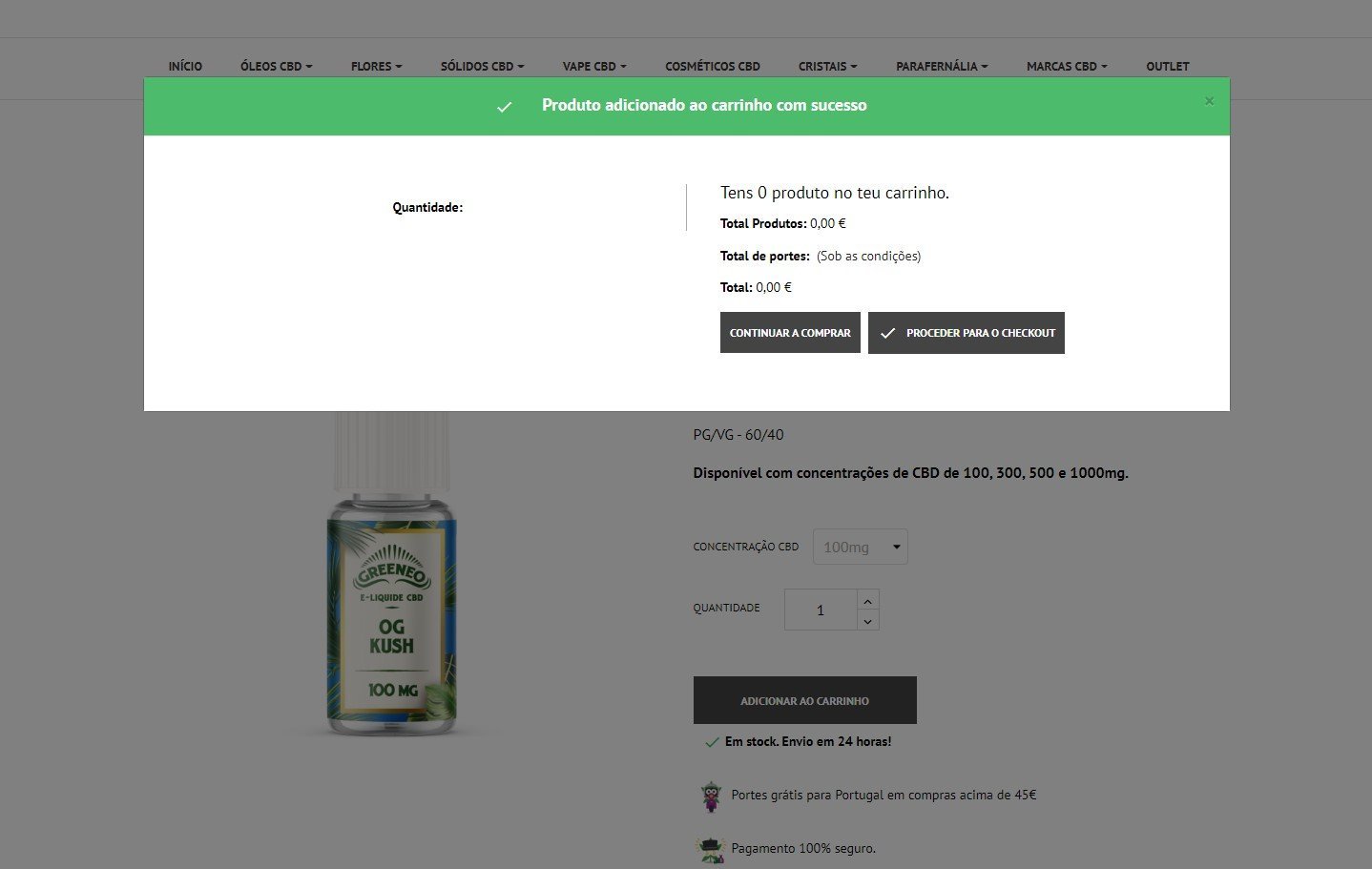

I am currently facing an issue with my website when I try to add the products to cart, sometimes it works, sometimes it simply doesn't. Ajax pop-up opens up everytime you click on "Add to cart" but sometimes it shows as follow:

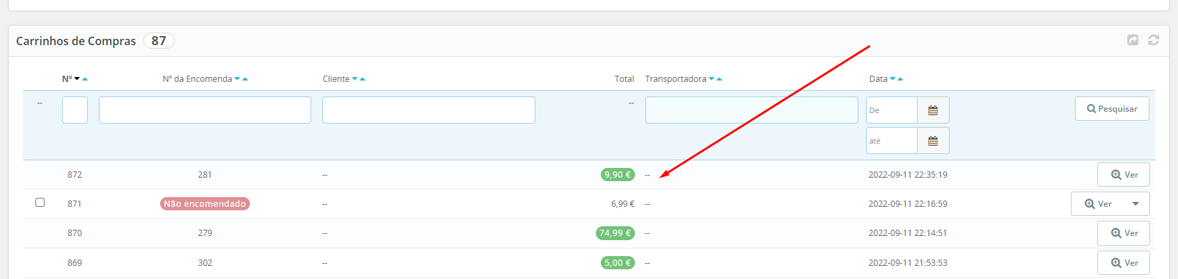

Even though it shows 0 and no product information, when I check my backoffice the product is added to a cart and it is not displayed to the customer on the frontpage (shows as empty card):

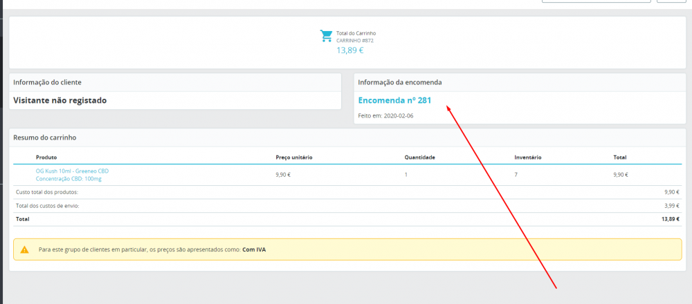

The thing about this error is that I know the reason why it happens but I cannot find the way to sort it out properly. For some reason, and if you notice on the image above, Prestashop automatically linked the new cart from a customer created to an order ID on the left side. If I open the cart information to check it, it attached the cart to an order made previously like 2 years ago, as seen here:
I am aware that if I delete all the database order history, that might solve it but I don't want to delete the order history. Does anyone knows what is going on or can pinpoint towards the file I need to make some changes or be looking at?
