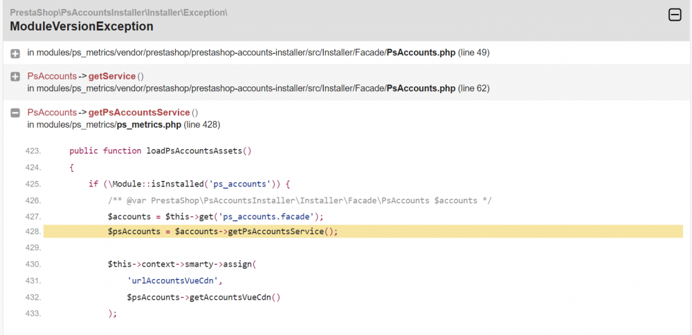

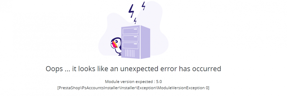

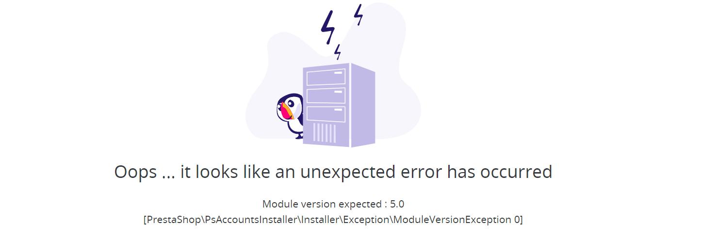

mati7716 Posted September 9, 2022 Share Posted September 9, 2022 I connected prestashop to a new database imported from another server. Virtually everything works, the problem is logging into the administrators panel. After logging into the back office, the following error pops up: Oops ... it looks like an unexpected error has occurred Module version expected : 5.0 [PrestaShop\PsAccountsInstaller\Installer\Exception\ModuleVersionException 0] Link to comment Share on other sites More sharing options...
Knowband Plugins Posted September 9, 2022 Share Posted September 9, 2022 Kindly enable the debug mode for more details. FYI, to enable error debugging you can follow the steps below. - open file: config/defines.inc.php (using FTP or hosting control panel) - change false-->true: define('_PS_MODE_DEV_', false); define('_PS_MODE_DEV_', true); After that if there is any error message showing on the page for that please let us know also you can check the error log directory and share the same for the error details. Link to comment Share on other sites More sharing options...

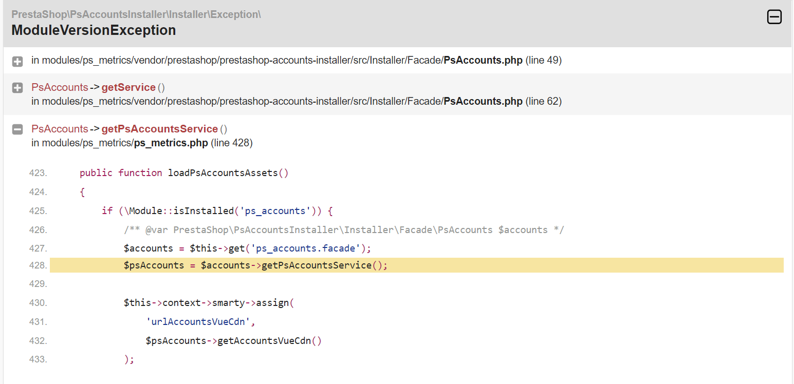

mati7716 Posted September 9, 2022 Author Share Posted September 9, 2022 The problem is resolved. The reason for the error was the module "ps_metrics". Before connecting to a new base, turn off the above module. Link to comment Share on other sites More sharing options...
