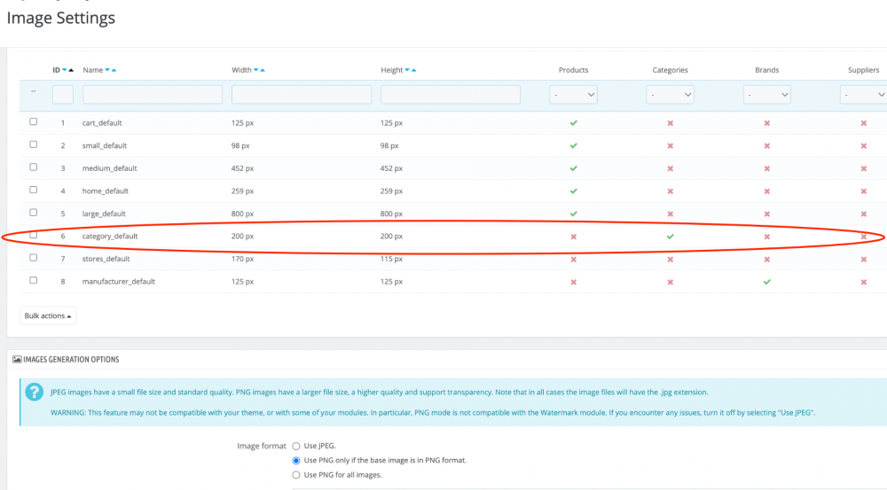

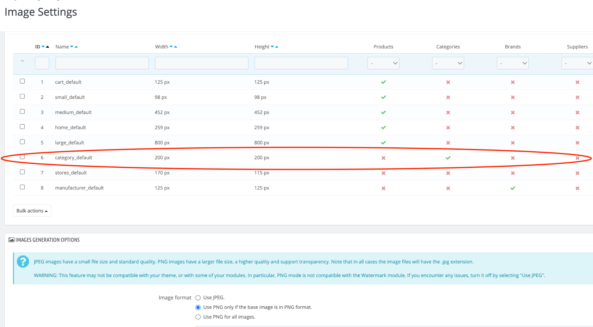

webbrent Posted August 25, 2022 Author Share Posted August 25, 2022 Once selected it then allows the upload and shows the image in the category configuration page, however it does not display the image in the front-end. I assume this is because there is a 200 px x 200px configured to display with the categories option selected as per attached. I am assuming the them is referencing that Image Settings to display the category image. Perhaps these additional Apache Errors could be an accomplice to the issue: Quote PHP Notice: Trying to get property 'value' of non-object in /var/www/domain.co.za/html/var/cache/prod/smarty/compile/AngarTheme/5e/ee/24/5eee242e5cbca9bb89b8ffa439cebef7beaaf2e4_2.module.psgdprviewstemplateshookd.php on line 28, referer: https://domain.co.za Quote PHP Notice: Trying to get property 'value' of non-object in /var/www/domain.co.za/html/var/cache/prod/smarty/compile/AngarTheme/5e/ee/24/5eee242e5cbca9bb89b8ffa439cebef7beaaf2e4_2.module.psgdprviewstemplateshookd.php on line 25, referer: https://domain.co.za Link to comment Share on other sites More sharing options...
