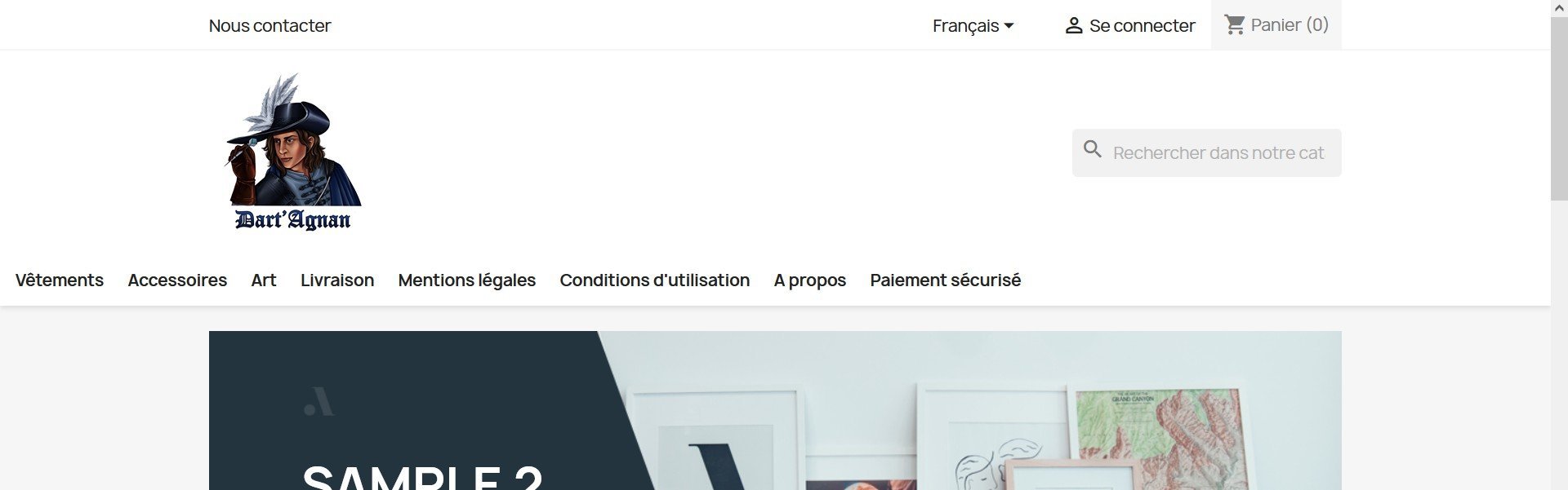

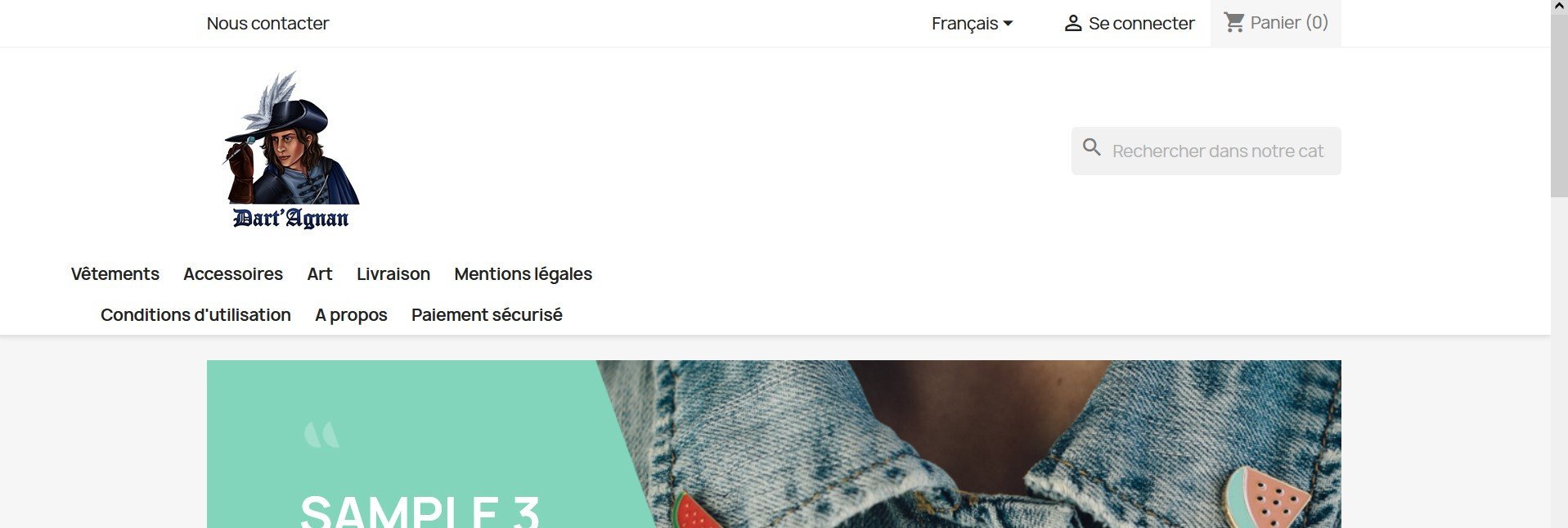

Kreykoui Posted August 18, 2022 Share Posted August 18, 2022 Hello everyone, In order to find space, I try to integrate the main menu of my site in production, with the hook "displayNavFullWidth". But as you can see, the menu remains sticking to the left margin. I tried different possibilities found on the web but none seem to work under version 1.7.8.7. Is there a solution to center the menu so that it is compatible with different screen formats? Thank you for any help you can give me. Link to comment Share on other sites More sharing options...

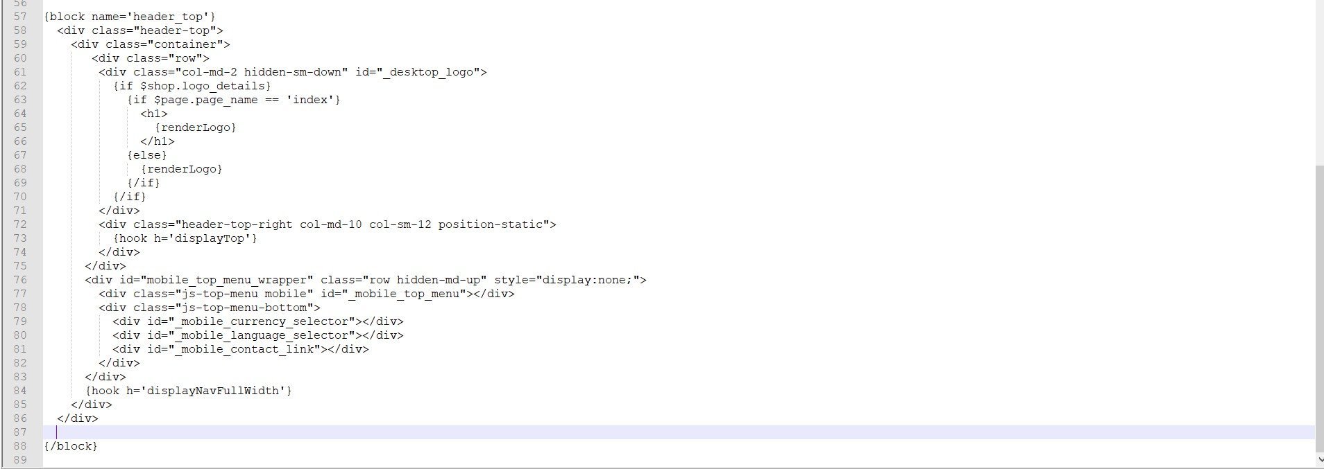

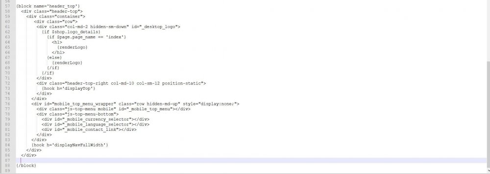

Kreykoui Posted August 20, 2022 Author Share Posted August 20, 2022 Le 2022-08-19 à 7:41 AM, stifler97 a dit : i think this is missing a container class. because it seems to be wider than normal That's also the impression I had but, not being a programmer... Your intervention gave me the courage to dive in and after careful consideration, I took the plunge! So instead of "building" a container to drop "displayNavFullWidth" hook into it, I decided to use the already existing container in: /mysite/themes/classic/templates/_partials/header.tpl, and just move {hook h='displayNavFullWidth'} in the right place. Simple clean handling that responds well on all screen formats. Magic Magic !! 1 Link to comment Share on other sites More sharing options...
