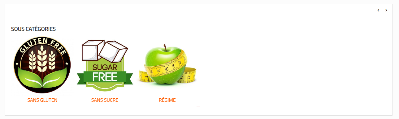

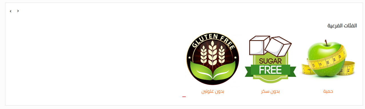

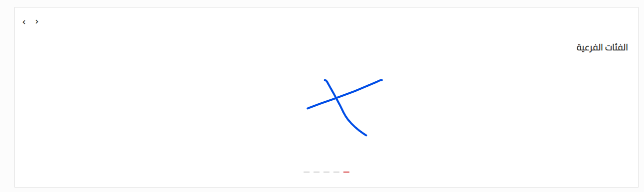

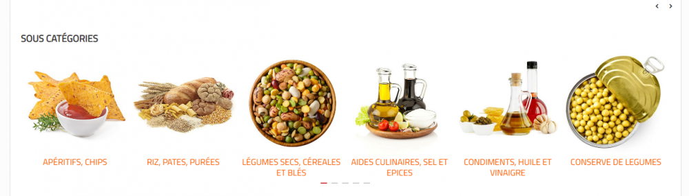

scoopsat Posted August 16, 2022 Share Posted August 16, 2022 Hello, I want to help me with the direction of the subcategories left to right for LTR mode and right to left for RTL mode. For example, there are three subcategories here:http://sc2scoopsat.universe.wf/fr/90-sans-gluten-et-diete And here there is a carousel for the parish categories because there are more than 6 sub-categories: http://sc2scoopsat.universe.wf/fr/92-epicerie-alimentation How to make subcategories appear from right to left in .lang-rtl . mode http://sc2scoopsat.universe.wf/ar/90-- http://sc2scoopsat.universe.wf/ar/92-- I tried changing the float with the following code: .lang-rtl .wt_subcategory .owl-carousel .owl-stage { float: right; } Only works with subcategories containing 5 or fewer subcategories Categories that fill the page when there are 6 disappear in RTL mode Thank you so much Link to comment Share on other sites More sharing options...
