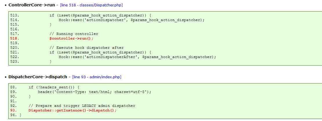

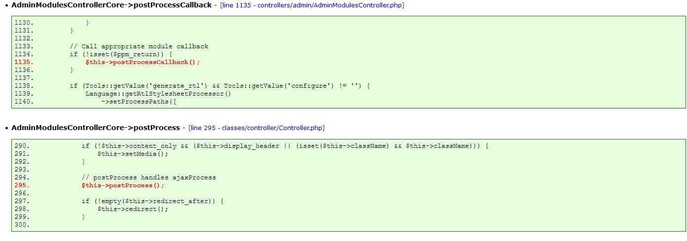

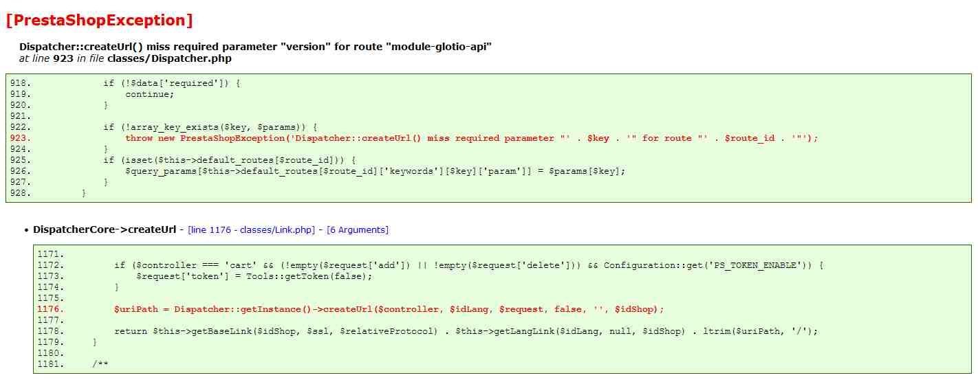

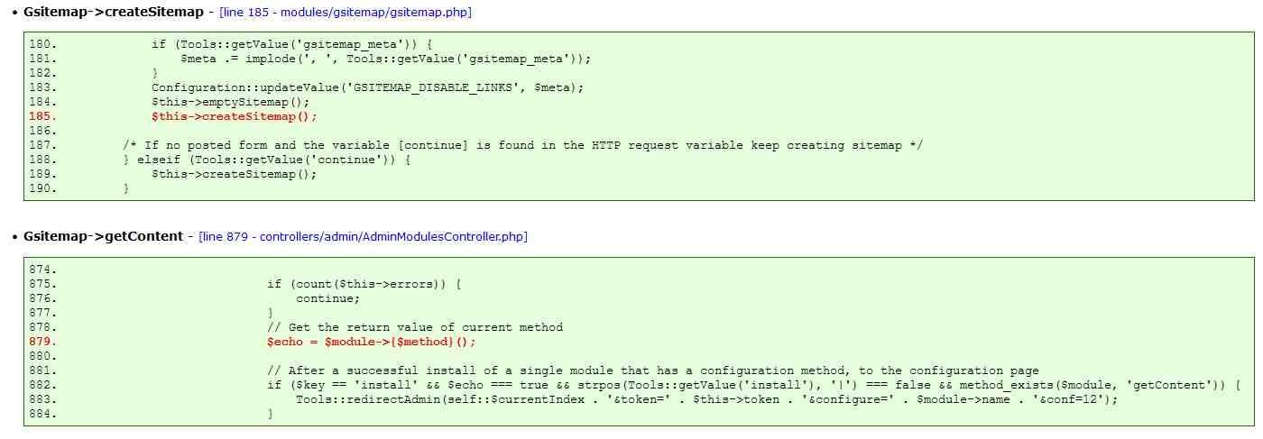

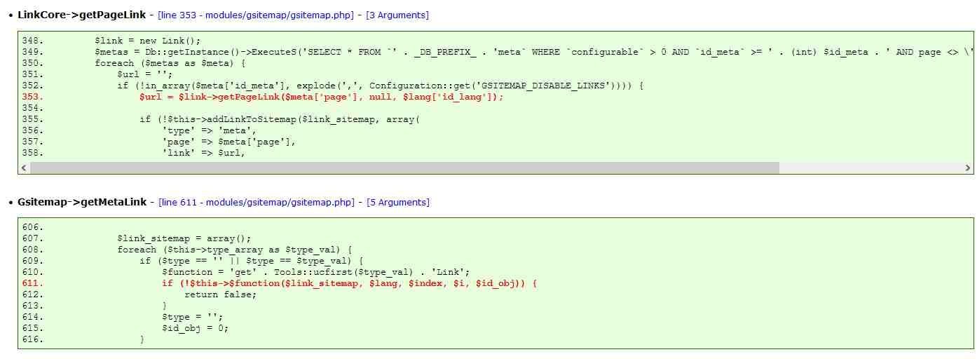

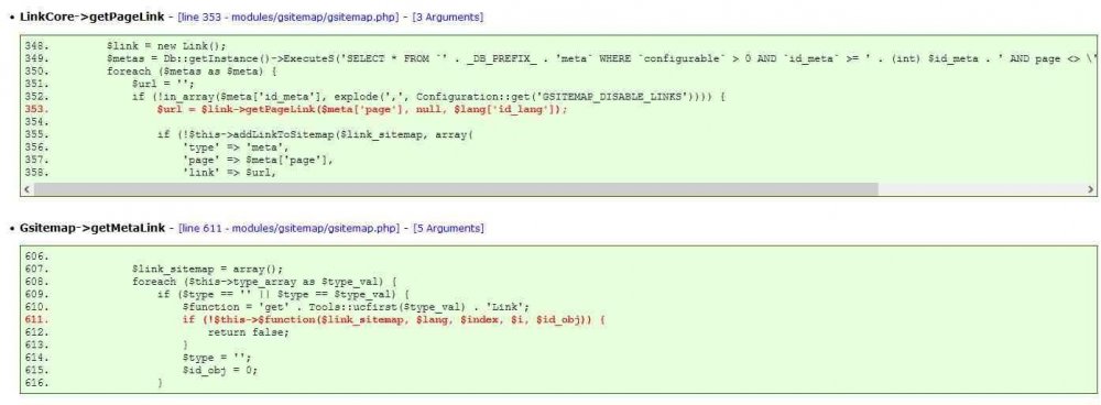

Craig Day Posted August 12, 2022 Author Share Posted August 12, 2022 The Exception Logs are shown below. 'module-glotio-api' - The Glotio module is installed but not configured yet (it is a language translation module). Thanks, Link to comment Share on other sites More sharing options...
Craig Day Posted August 12, 2022 Author Share Posted August 12, 2022 It works ok if I disable the Glotio Translation Module. 1 Link to comment Share on other sites More sharing options...
