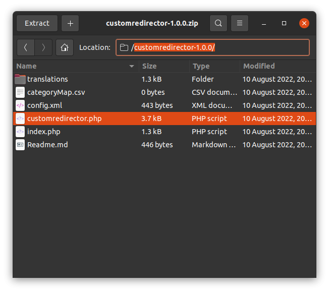

Ali Samie Posted August 10, 2022 Share Posted August 10, 2022 (edited) This module lets you define a mapping between categories like this: 22,55 12,15 67,153 Which simply redirects customers from first category to second category. You need to add your category mapping into this file "categoryMap.csv" Github link: https://github.com/stifler97/customredirector/releases Edited August 10, 2022 by stifler97 (see edit history) 1 Link to comment Share on other sites More sharing options...

Ali Samie Posted October 17, 2022 Author Share Posted October 17, 2022 On 10/17/2022 at 10:26 AM, Tyrson said: Very good idea, since it does not involve touching the htaccess to put a redirect. I have tried to test it but it has not allowed me to install (Zip format error) and I have uploaded it by FTP and the Module Manager does not recognize it either. Regards Expand You should change the name of the containing folder inside the downloaded zip to match the main file of the module When you download from github, it adds the version at the end of folder and zip file name. You should remove it For example: "customredirector-1.0.0" Must change to: "customredirector" Link to comment Share on other sites More sharing options...
Tyrson Posted October 17, 2022 Share Posted October 17, 2022 What you say I did. The problem was that I uncompressed it and then recompressed it with the windows compressor. But then I compressed it with the 7zip and it worked perfectly. Link to comment Share on other sites More sharing options...
