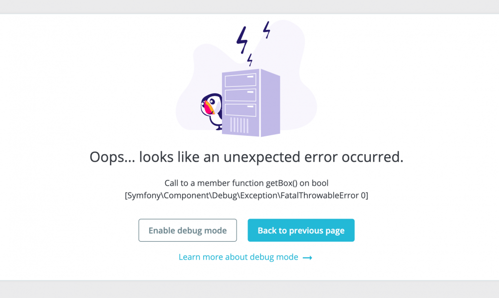

oshoot Posted July 29, 2022 Share Posted July 29, 2022 I just got a new order but when I open try to open it from the BO I get the error shown in the picture. Any ideas how to fix? I am on 1.7.8.2 Link to comment Share on other sites More sharing options...
ComGrafPL Posted July 29, 2022 Share Posted July 29, 2022 Enable debug mode and check the error after enter order. Link to comment Share on other sites More sharing options...
Ali Samie Posted July 29, 2022 Share Posted July 29, 2022 I guess you have some modules with overrides Link to comment Share on other sites More sharing options...
oshoot Posted July 29, 2022 Author Share Posted July 29, 2022 I have no idea what the problem is. I was told it might be a memory server issue , so I had it bumped up, But it did not help. Link to comment Share on other sites More sharing options...
Ali Samie Posted July 29, 2022 Share Posted July 29, 2022 turn on debug mode to get more detailed errors. Link to comment Share on other sites More sharing options...
oshoot Posted July 30, 2022 Author Share Posted July 30, 2022 It is a problem with the Canada Post module from ZHmedia. When I disable it, I can open the order. Link to comment Share on other sites More sharing options...
Ali Samie Posted July 30, 2022 Share Posted July 30, 2022 Thats good to know, You need to investigate through that module. Maybe some table is missing or a class call or some property is depricated. Link to comment Share on other sites More sharing options...
