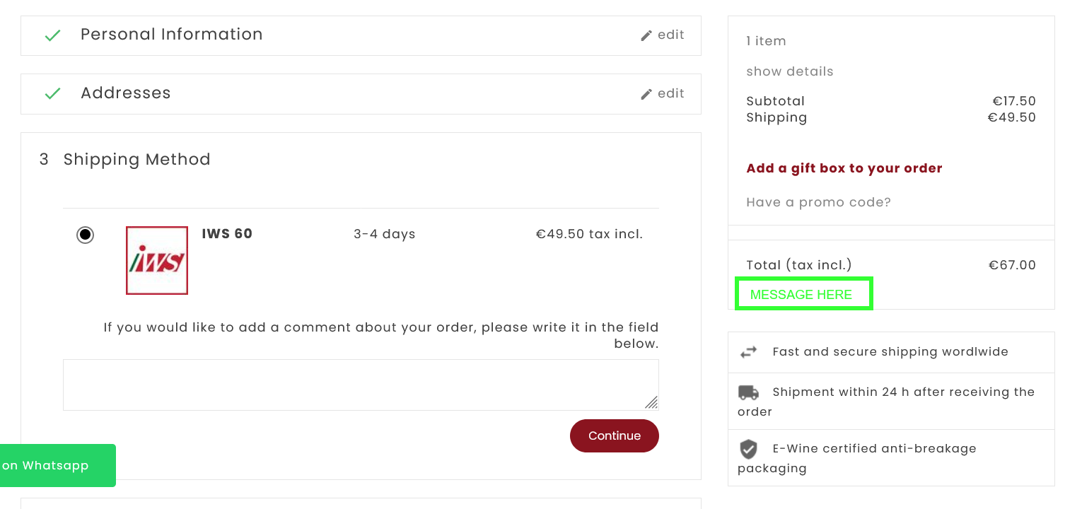

ale.pixel Posted July 29, 2022 Author Share Posted July 29, 2022 I would like it to appear during the step 3 - Shipping Method when the carrier are shown and you can select them (see screenshot). The message should be on the right column, but I already know how to put it there, it's just the condition that is not working properly. I'm using PrestaShop 1.7 Thanks! Link to comment Share on other sites More sharing options...
