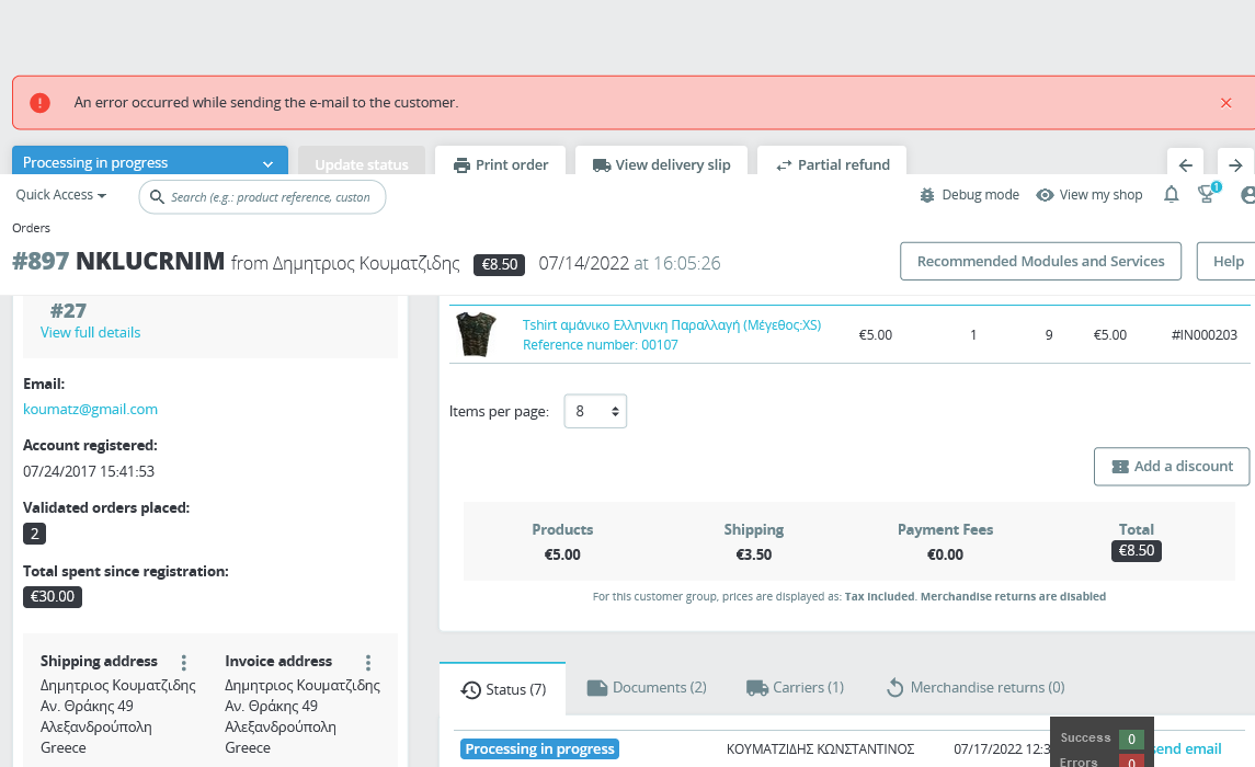

Koumatzidis Posted July 20, 2022 Share Posted July 20, 2022 Hi All After manual upgrade to 1.78 from 1.7.6 I realised that I can not (re) send status mails from the order panel. ( image attached) Test mail is sent normally. At debug mode I have the following message Matched route "admin_orders_view" . Hide context [▼ "route" => "admin_orders_view" "route_parameters" => [▼ "_controller" => "PrestaShopBundle\Controller\Admin\Sell\Order\OrderController::viewAction" "_legacy_controller" => "AdminOrders" "_legacy_link" => "AdminOrders:vieworder" "_legacy_parameters" => [▼ "id_order" => "orderId" ] "orderId" => "897" "_route" => "admin_orders_view" ] "request_uri" => ".........../index.php/sell/orders/897/view?_token=01XWCo4wMCuAgcFUilevaQJVfSdxBzyp_yUIkjQATgA" "method" => "GET" ] I tried with STMP method but still same problem DK Link to comment Share on other sites More sharing options...

Ali Samie Posted July 20, 2022 Share Posted July 20, 2022 Have you checked your smtp settings? Ensure every thing is right. Go to BO > Advanced Parameters > E-mail. Send a test email to check if you are able to send emails. Link to comment Share on other sites More sharing options...
Koumatzidis Posted July 20, 2022 Author Share Posted July 20, 2022 Stifler thanks Yes test mails are sent normally The problem exists even with STMP settings DK Link to comment Share on other sites More sharing options...
