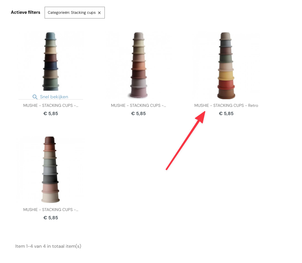

3sens Posted July 18, 2022 Share Posted July 18, 2022 Hi There I'm pretty new to Prestashop but am currently revamping the overall style of an existing webshop. What I would like to achieve is that under the category page, the product thumbnails show as well the different colors. There will be a lot of colors so I would like to present it as below. Is there a fairly easy way to achieve this ? Thanks for helping me out. Link to comment Share on other sites More sharing options...

3sens Posted July 18, 2022 Author Share Posted July 18, 2022 On the product page the color variations show up but not on the category page (see further below) Link to comment Share on other sites More sharing options...

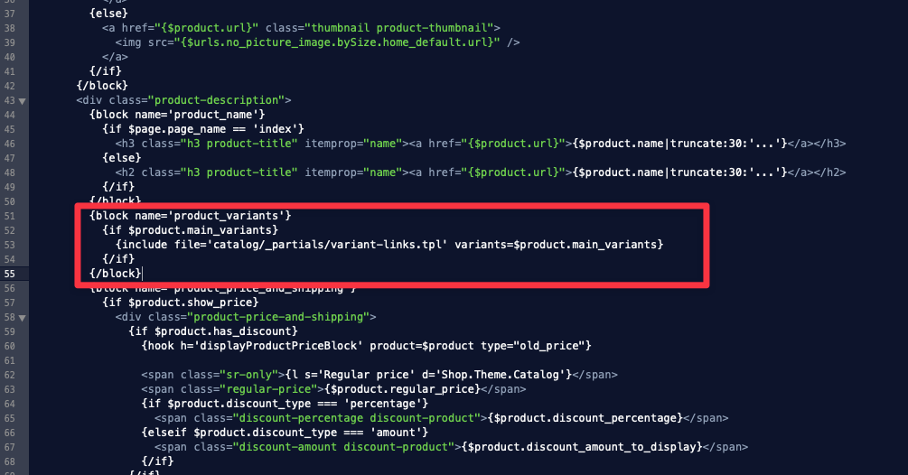

Knowband Plugins Posted July 18, 2022 Share Posted July 18, 2022 Kindly add the below code after the "product_name" block in /themes/classic/templates/catalog/_partials/miniatures/product.tpl. {block name='product_variants'} {if $product.main_variants} {include file='catalog/_partials/variant-links.tpl' variants=$product.main_variants} {/if} {/block} Screenshot for reference : https://nimb.ws/ZpERBN 1 Link to comment Share on other sites More sharing options...
3sens Posted July 19, 2022 Author Share Posted July 19, 2022 On 7/18/2022 at 4:57 PM, Knowband Plugins said: Kindly add the below code after the "product_name" block in /themes/classic/templates/catalog/_partials/miniatures/product.tpl. {block name='product_variants'} {if $product.main_variants} {include file='catalog/_partials/variant-links.tpl' variants=$product.main_variants} {/if} {/block} Screenshot for reference : https://nimb.ws/ZpERBN Expand Thanks a lot for your feedback. Unfortunately I cannot get iyt to work. Changed the file, saved it and variants do not show up. They do show up in product quick view. Any other suggestions ? Is there maybe a toggle in Prestashop that can activate/deactivate this option ? Link to comment Share on other sites More sharing options...
