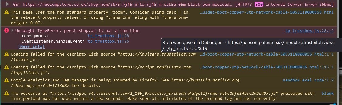

musicmaster Posted July 18, 2022 Share Posted July 18, 2022 When I look in the browser console I see an error with a trustpilot module. I suggest you delete that module (or move it to another directory). Link to comment Share on other sites More sharing options...
neocomputersuk Posted July 18, 2022 Author Share Posted July 18, 2022 Tried uninstalling the module and still experiencing the same issue. Link to comment Share on other sites More sharing options...
