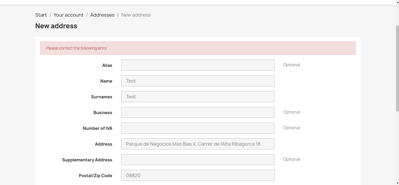

I'm getting an error after upgrading 1.7.6.5 -> 1.7.8.6. And the error is Address from is not submitting in checkout or in user dashboard/admin.
It shows every time in the URL after submitting   /address?id_address=0 or /order?id_address=0.
And at the first after overriding the files with prestashop new version zip file, when i redirect to https://shop_url/install/upgrade/upgrade.php it show page isn't working.

Actually i'm not getting a new id for address or you can say its not being submit that we can have a new id for the address, its stick to the id zero (0) that's makes no sense, i'm not able to understand why this is happening even though I've deactivated all the plugins and using the default theme
